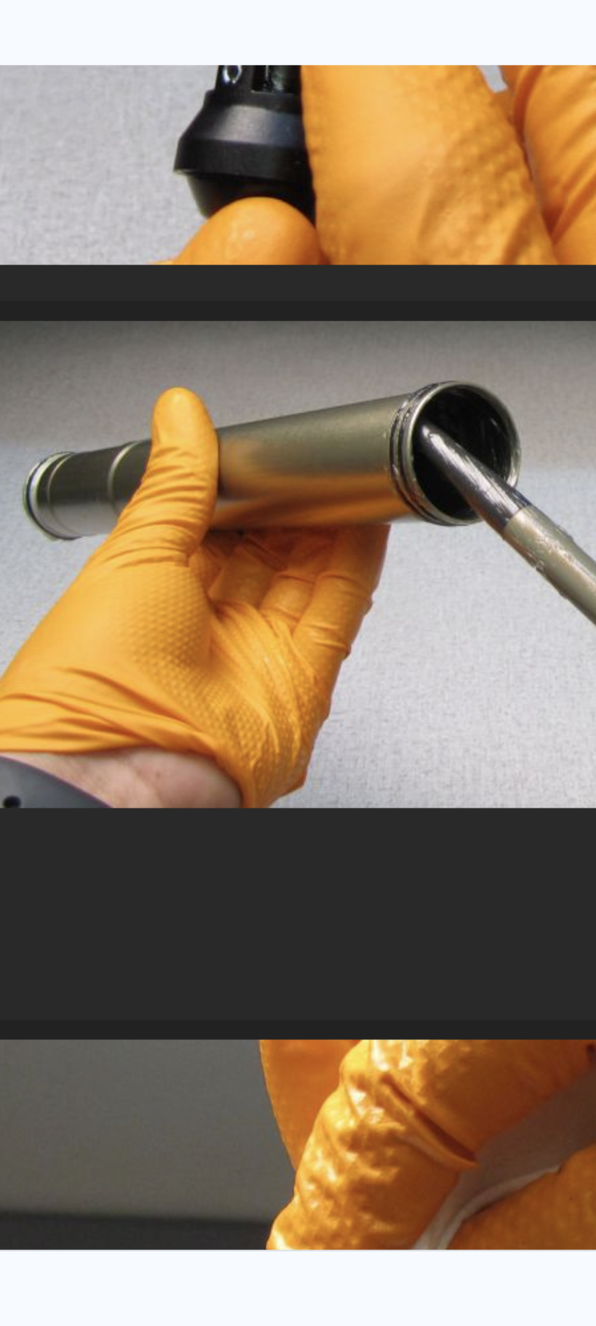

Hi
I'm looking in to bying a used Smashpot Fox36 kit for my Fox38 as the seller is sayng it is basically the same apart from the topcap. Is that true that thats the only difference?
Thanks :)

The correct reply is no, the 38 kit has a different top cap and a sleeve that goes around the spring to take up the extra space inside the tube(38-36). If you call them, they might help you out.

The 38 uses a 36 air shaft. The space is taken up by a thinner tube with a 38mm top and bottom section. The spring has a shrink wrap too stop any internal damage to the fork, but it doesn't really apply to the 38 as the internal is a separate tube and can be replaced.
As the middle picture shows the tube that the air shaft runs in.
