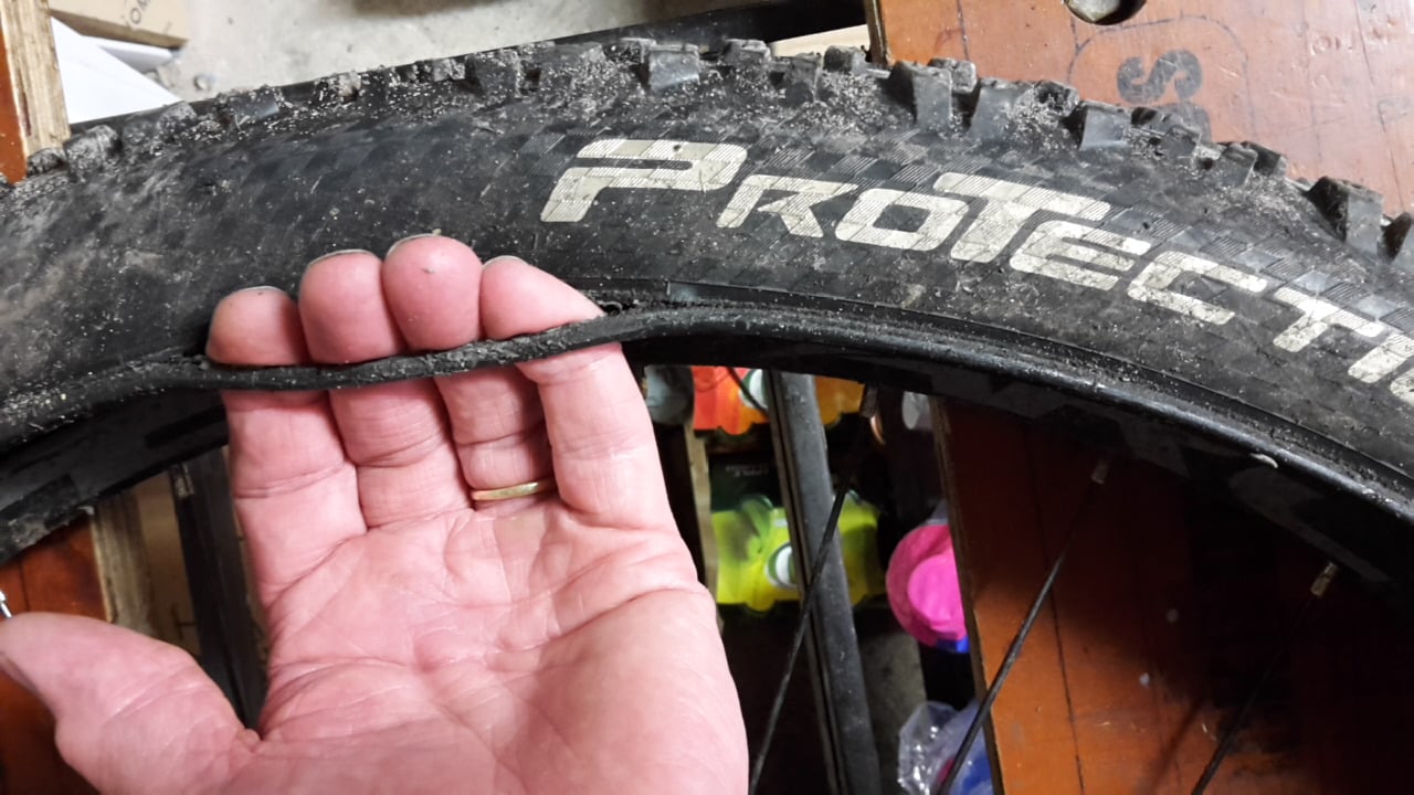

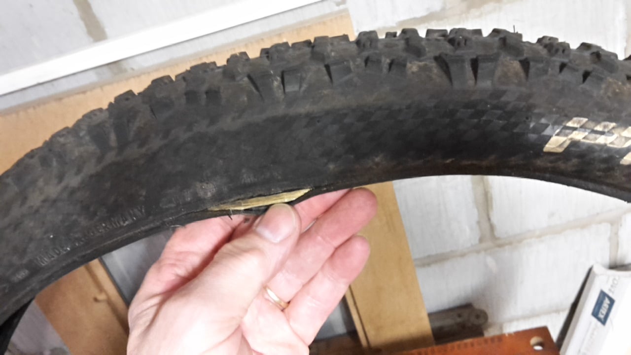

This Continental Trail King 27.5x2.2" (BCC) tyre failed at 600 miles, the next one at 400miles. Note the same type of failure and the location near the logo.
The first tyre was claimed under warranty and because they didn't have one to re-issue they gave me a credit. I used the credit to replace the tyre with another one from a different German company. Must have been from the same batch. Second warranty claim went the same way, ie no problems and a refund back to my credit card. I didn't have to return the tyre, just send a photo. The third tyre I bought in the UK and it must have been from a different batch because I had zero problems with it.

Those both look to have been cut through next to the bead from running pressures too low to support the sidewall.
and if that's the case it's user error. Not a manufacturing fault.

I confess to considering that it might have been low pressure (24psi on the rear 27.5x2.2, rider all up weight 92kg), and I was just chancing my arm with the first claim, I admit. But when the next one failed in the same place and same side of the tyre, I decided that it was definitely a manufacturing fault. Conti must have thought the same because both claims were settled without a quibble. In addition, I had been riding those tyres at those pressures before and after those two failures without any problems. Quite by chance I was on a course at UK Bike Skills and the guy there (Tony Doyle, aka "Jedi") commented on my Contis and said that he didn't trust them because one had failed on him at about the same time as mine. Given that he does massive jumps, I'm not surprised he didn't want to take any chances.
Apart from those two tyres (same batch?) I have had zero problems with Conti tyres and I've been riding them since 2010, starting with the Rubber Queen, which became the Trail King after they got sensitive to the American market. I'd have TKs now if they had made the size I wanted.
do you realise every rider has a weight bias towards one side?
ie. every rider can and does corner harder to one side, every rider also has a preferred side to fall (but that's another thing for a different discussion)

I don't trust contis either. but my mistrust comes from GP4Seasons and 4000s delaminating before they wore out and various other scaryAF failures. If you think a tyre failing is a big deal off road it's a whole other level on road. ;)
Hence my comment above.
