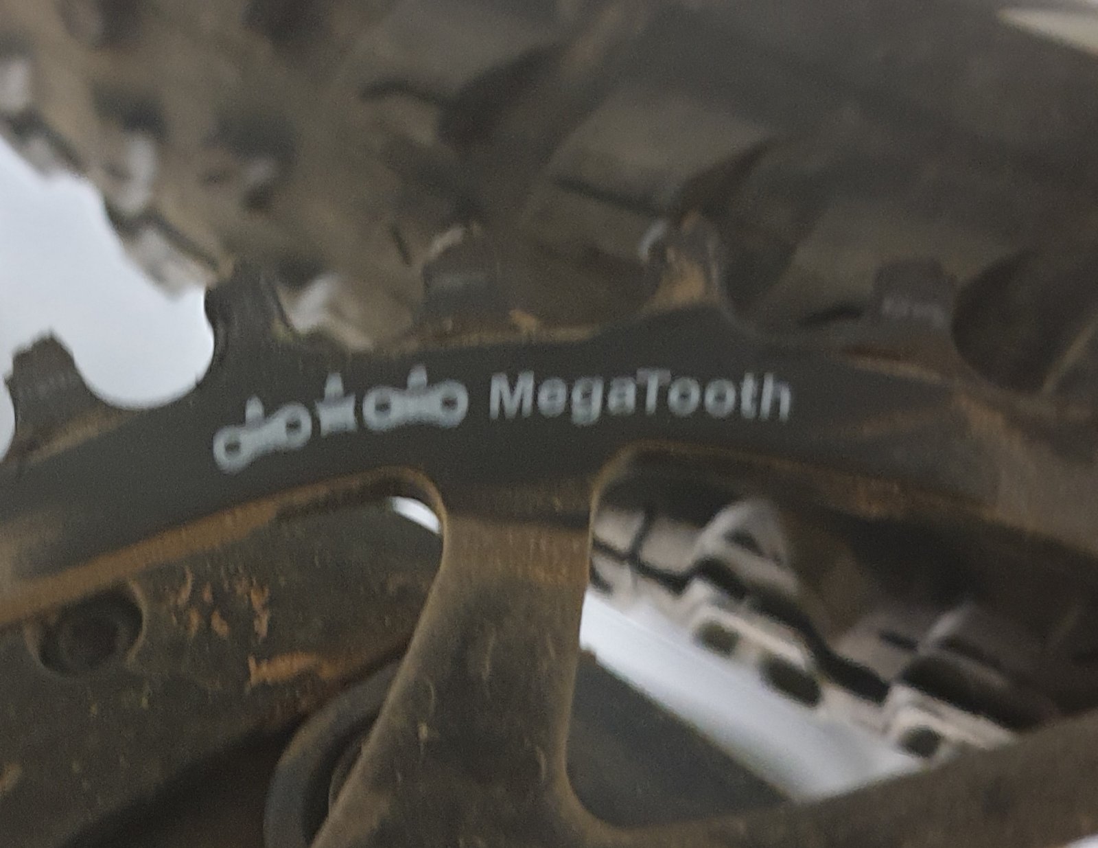

Ok I just looked at your video again and noted you are using a (I think) FSA Megatooth Chain ring.
As best I can tell it uses a long tooth profile ..."which enhances chain retention via thick-thin tooth design for maximum chain engagement."
It is designed for 11 speed, not 12 speed.
Not necessarily true. I have the FSA Megatooth on my Jam², which is a 1x12 Shimano rig.
It's a custom part for Focus and not the stock FSA Megatooth.
Which could well mean that the wrong part fell into the box at FSA and got fitted when no one noticed. That video does rather look like a narrow wide ring isn't working properly.

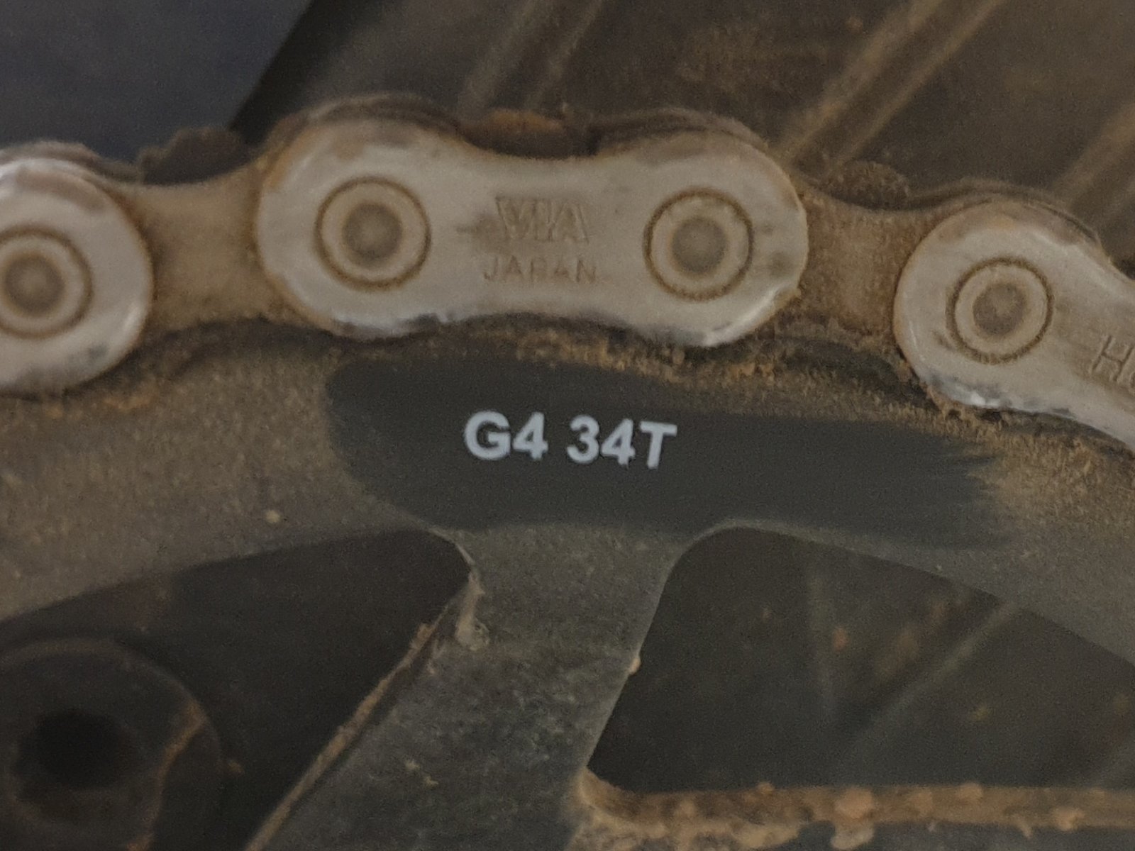

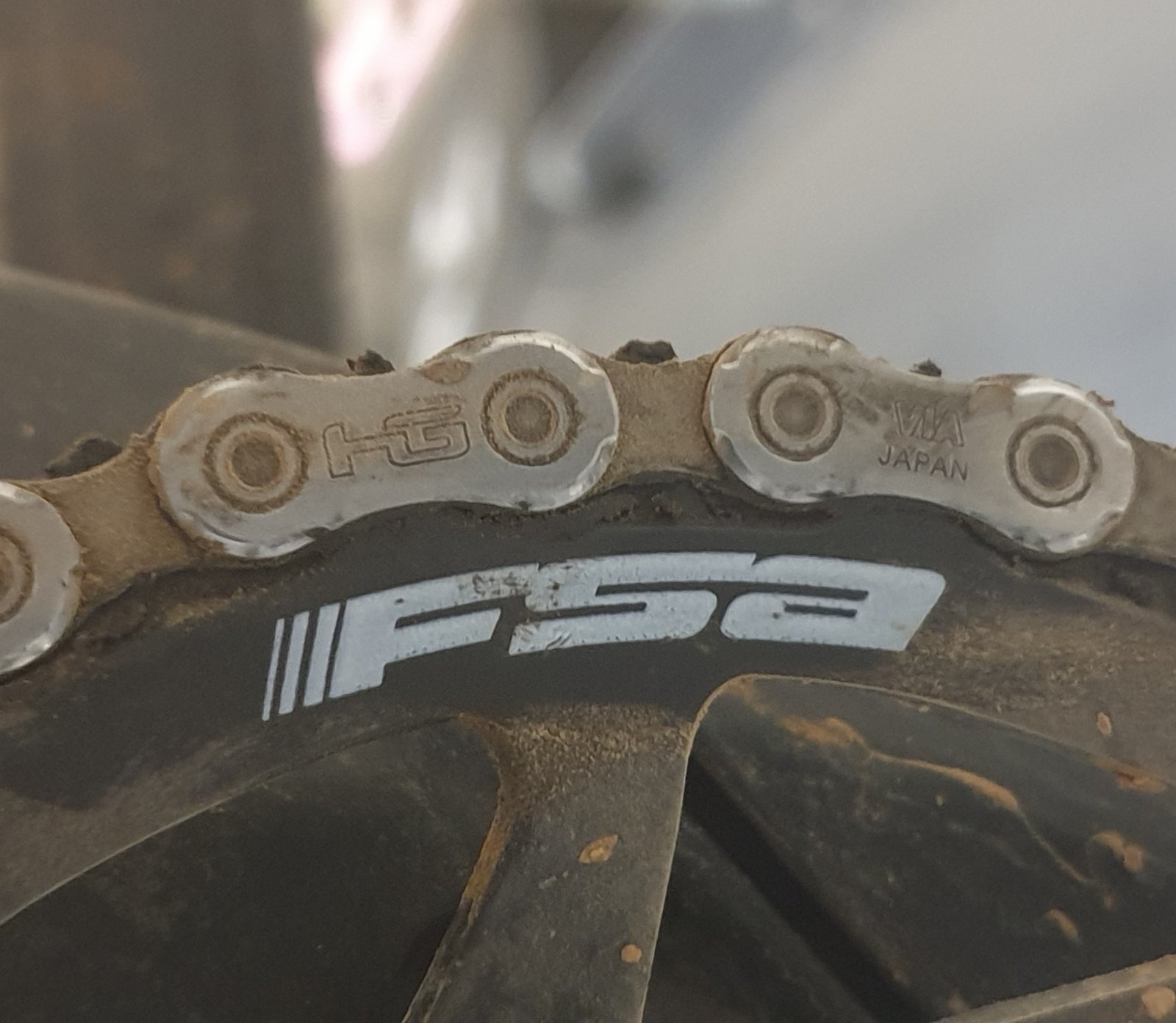

The chain is aligned correctly with narrow/wide holes.
And my FSA chainring has the same markings. G4 34t.

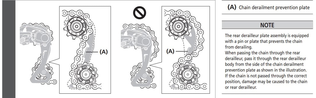

Check you've got the chain threaded through the derailleur correctly - ie the correct side of the small plate between the rollers, other wise it will drag across the small piece of metal.
