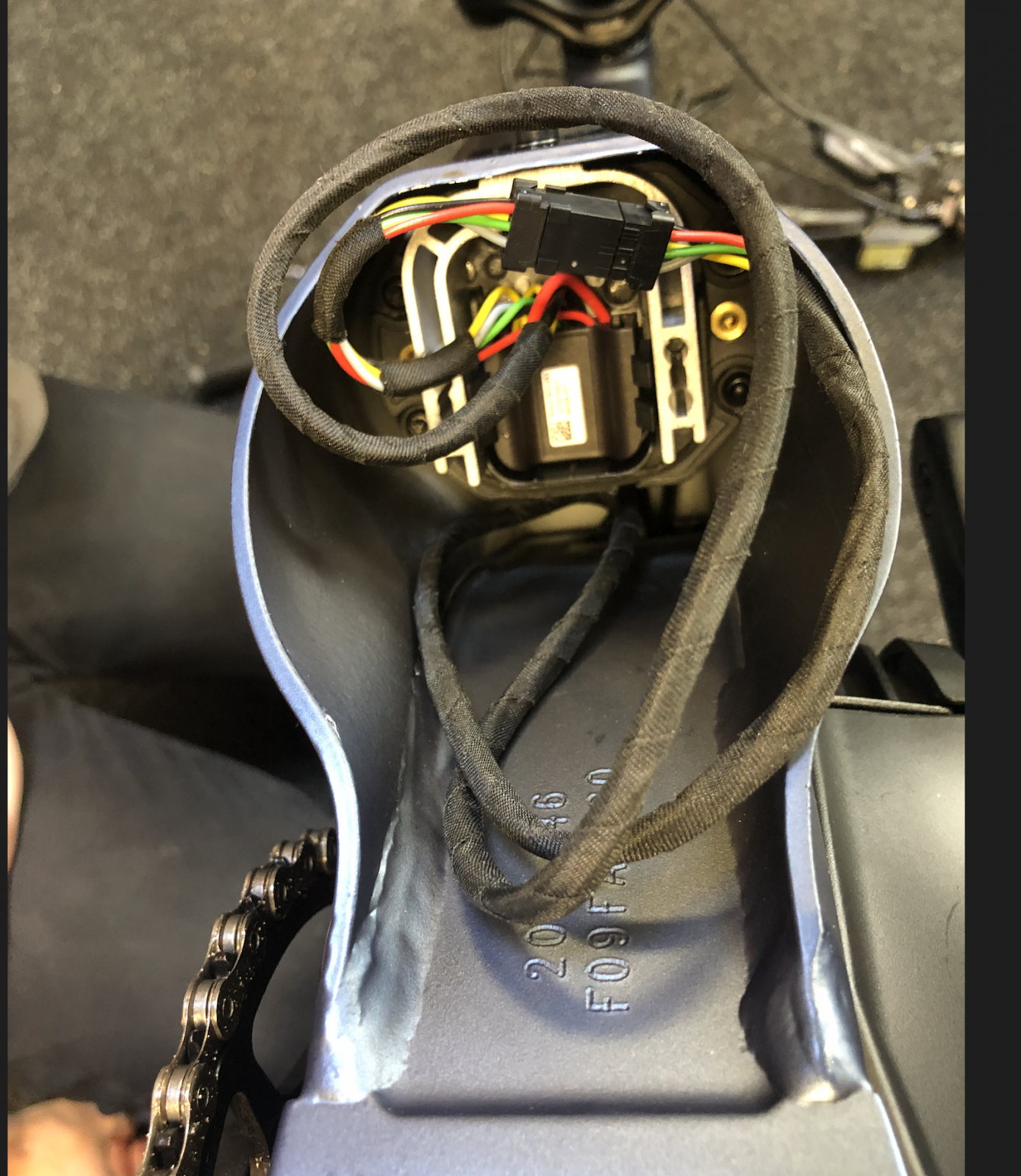

I would say my concern with removing the battery a lot would be damaging the wiring loom as you need to be careful with it when positioning etc, tis easy enough to do but fiddly, but it was the main reason I didnt buy one as I am in same position as you. When looking at the bike, I removed th battery in the shop, and both myself and the shop guys all agreed it wasn't really built to regularly remove.

I do not believe removal or replacement of the battery on a Whyte is that problematic...it is just a bit fiddly, mostly in respect of refitting it. The main issue is that the cables run along downtube alongside the battery so they need to be positioned in order not to jam the battery when pushing it back in. The bike preferably needs to be on a bike stand for removal but can be just turned upside down for replacement. I am lucky in that I have space inside the house for my bikes so I do not need to remove the battery but if I had t leave it in a cold garage/shed I would be more concerned about dampness rather than cold...especially after a wet ride. As others have said above, starting a ride with a very cold battery will likely reduce range and charging a battery when really cold is best avoided. I would have thought the latter could be a voided by using some form of thermal blanket with battery operated heating wires ( even a normal electric bed blanket) for 20 mins or so before charging. After a ride, using some form of insulating wrap...polystyrene/pipe lagging etc.....around the down tube may help to stop the battery getting super cold.

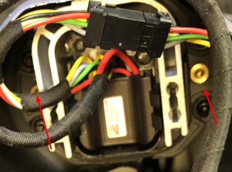

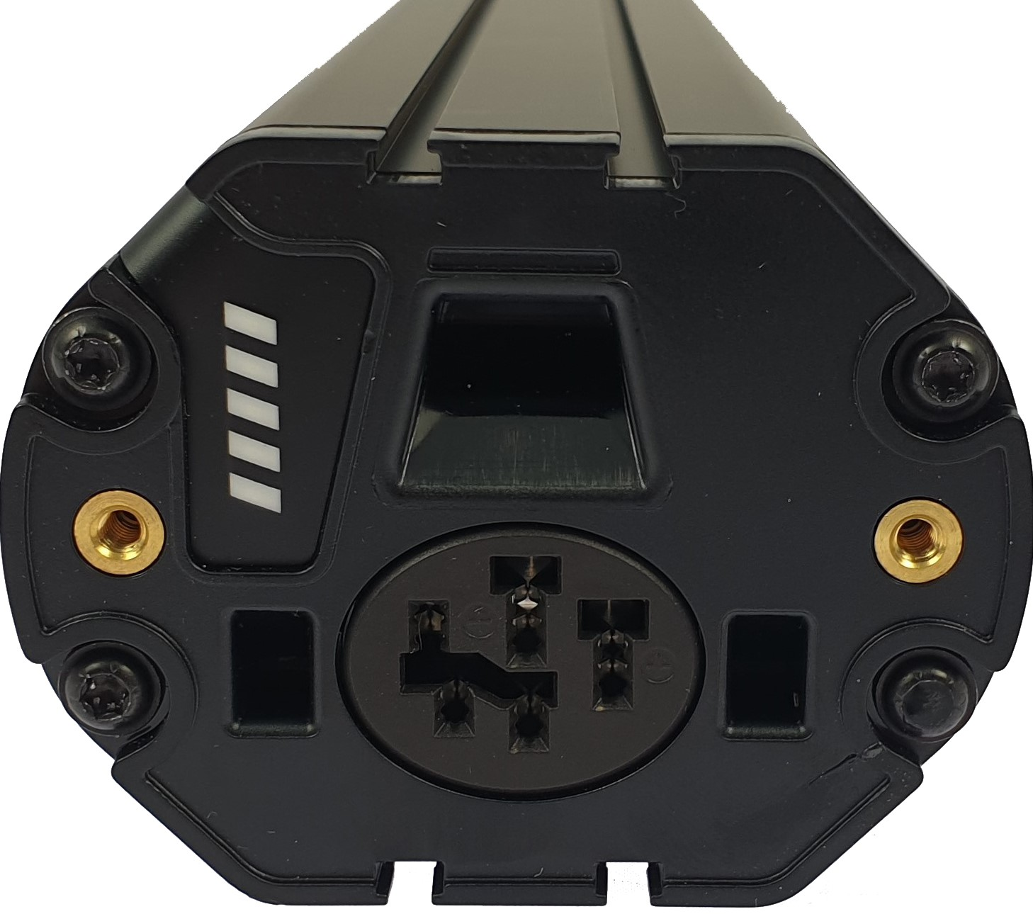

No, after a while you get used to it. If you put two screw in the golden holes to help your remove the battery
I do it all the time for three bikes, still unpleasant but nothing more.
EDIT: Complete instructions here: Battery removal hack - EMTB Forums

Its a good hack!! I have pushed the 2 screws through the ends of a short length of webbing ( doubled over) each with a penny washer on top so it makes a comfortable loop to pull the battery out. Makes the "tool" easy to stash and keeps it light.
