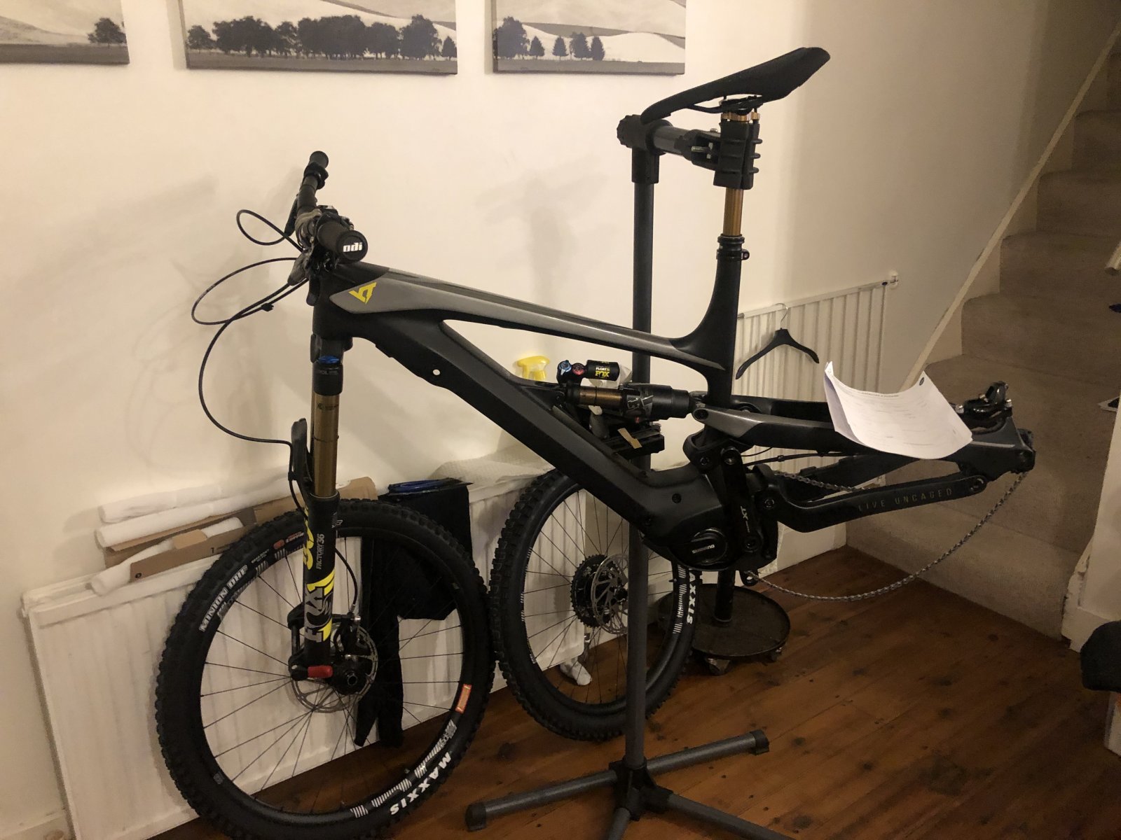

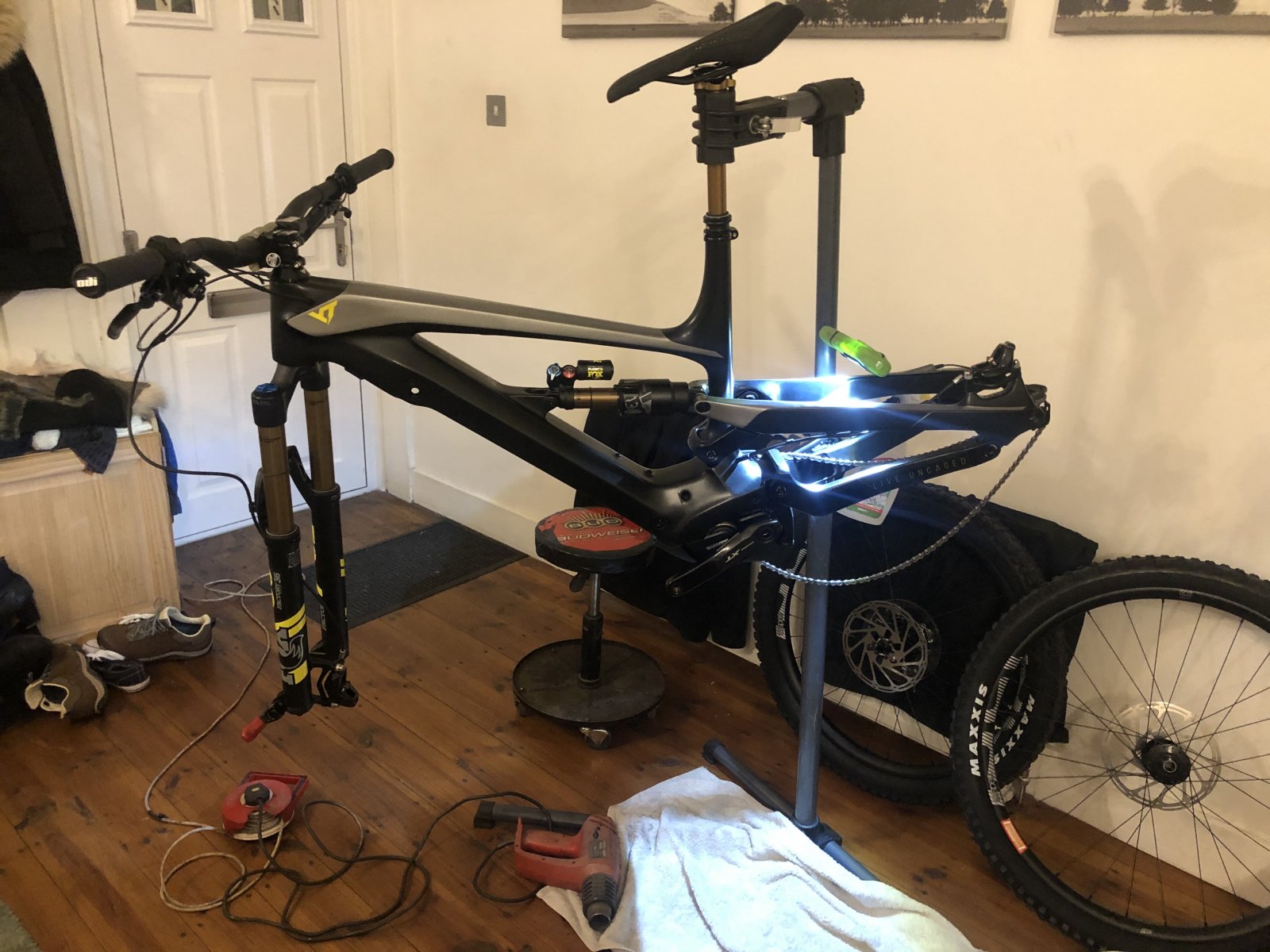

I got a decoy cf pro race 19. I invisiframed it using the matte finish an can’t really notice it. It does take time tho took me around 4-5hrs as taking my time. First pic without second with invisiframe

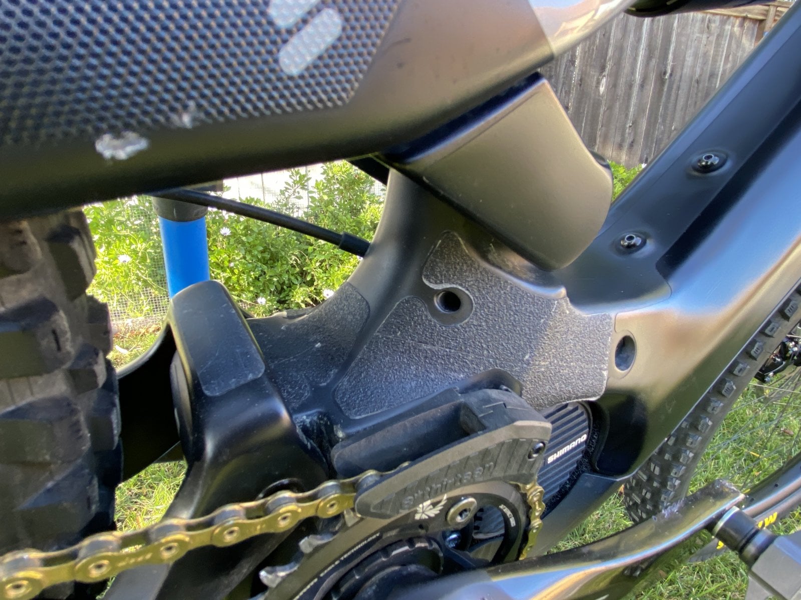

nativeracer
Aug 24, 2019
30
38
California
It’s worth the investment to install the invisfram. But, you are correct. Put some extra vinyl over the chain stays or places that get a lot of contact.

It’s worth the investment to install the invisfram. But, you are correct. Put some extra vinyl over the chain stays or places that get a lot of contact. View attachment 26106
Makes sense.
Especially since they are carbon on the pro. I'll get some heletape for that area.
