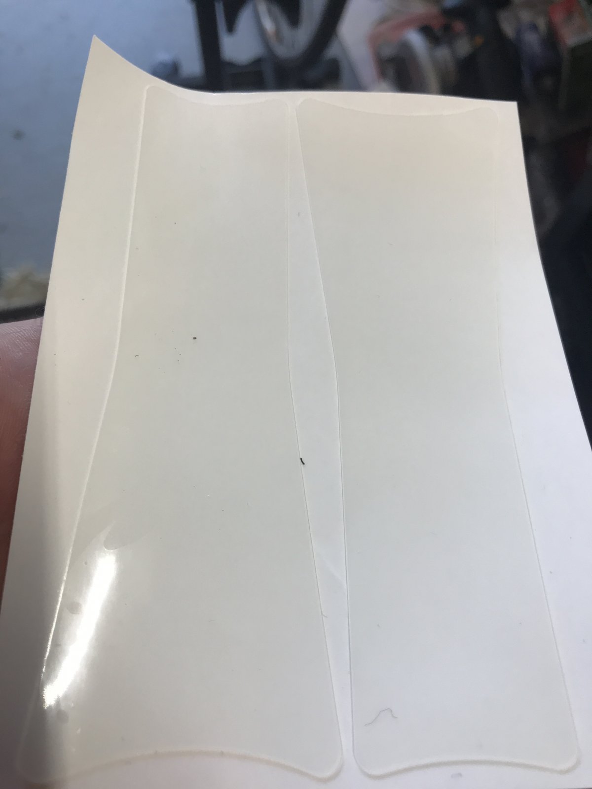

3 Recirved on a card with the bars, two strips, both the same do these go underneath the gear shift/ brake levers?

Hi buddy I have the same bars and never bothered finding out what they were for,I think I cut them down and used them for frame protection ?I’d just carry on as normal with the bars they are stronger than you would imagine,great bars my favourite back sweep?If this makes you at ease my nukeproof mega came with these bars and it never had those things fitted.

Agamemnon, I too purchased those bars (35mm rise) and love them, what a killer deal!
I paired mine with the Horizon 35mm stem, the idea was to get my bars back and up and it seems to have worked. It takes longer now for my hands to get numb.
The tape is like Trikz said, it free frame protection for anywhere you want to apply it.

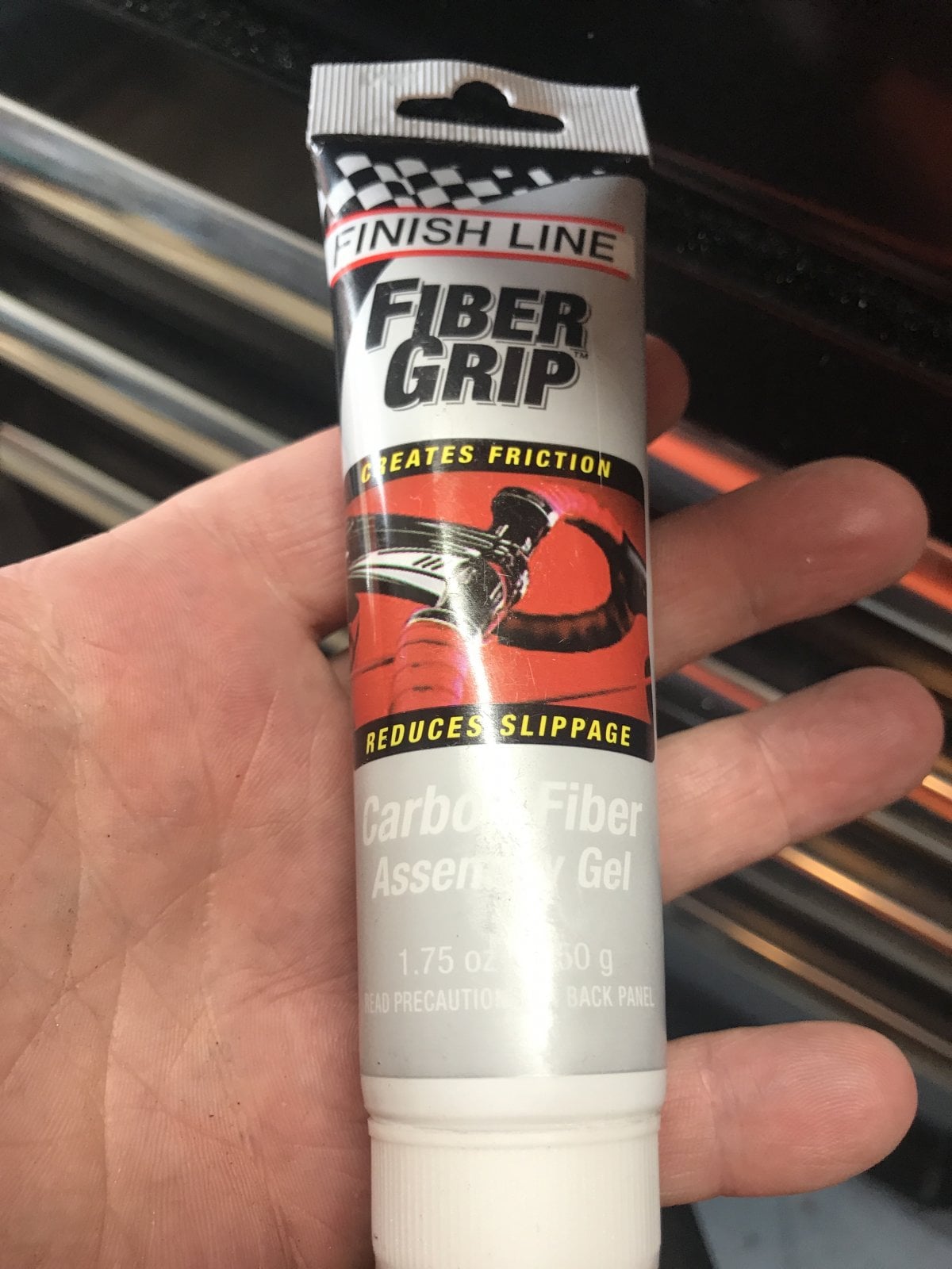

Thanks. I didn’t use the strips. I did use Fiber grip underneath several spots, like the stuff. Love the bars.
