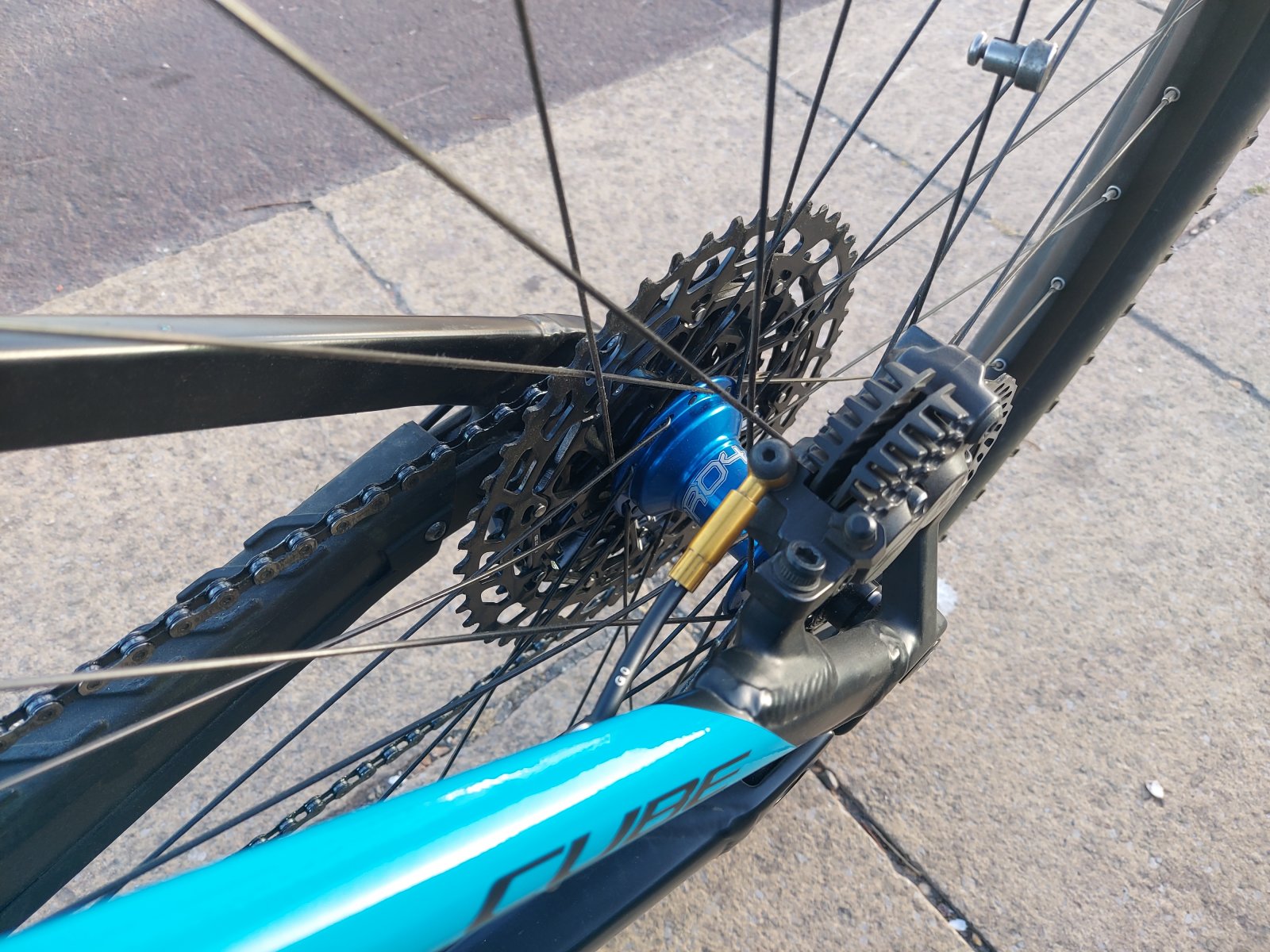

Well, that was £278 spent on a new hope rim and hub and did absolutely nothing. The issue persists. That was the final part of the drive changed. 100% confirmed to be the motor. Anyone have the slightest clue which component would cause this? It starts as a click on the downstroke (left or right crank, it's random, but only one side clicks at a time) and then under power, skips causing a nasty bang. Then might not do it again for 5 mins. It is exacerbated by turns at speed.

Just by luck I managed to capture a great example of this on camera. 13 sec video. A couple of pedal strokes in a straight line, all is fine. Then I make a left hand turn, you can hear the click and then the bang as it slips.

Further update, went back to performance line bearings and Peter swapped the motor out. Noise gone, no click, no slipping. He's lending me the motor so I can enjoy my summer riding planned. What a great guy. He says it's an issue He's never seen before so he is going to strip it to bits to find out the cause. Then I will either buy this motor or take the fixed one back. Either way, I am now riding! 😀
