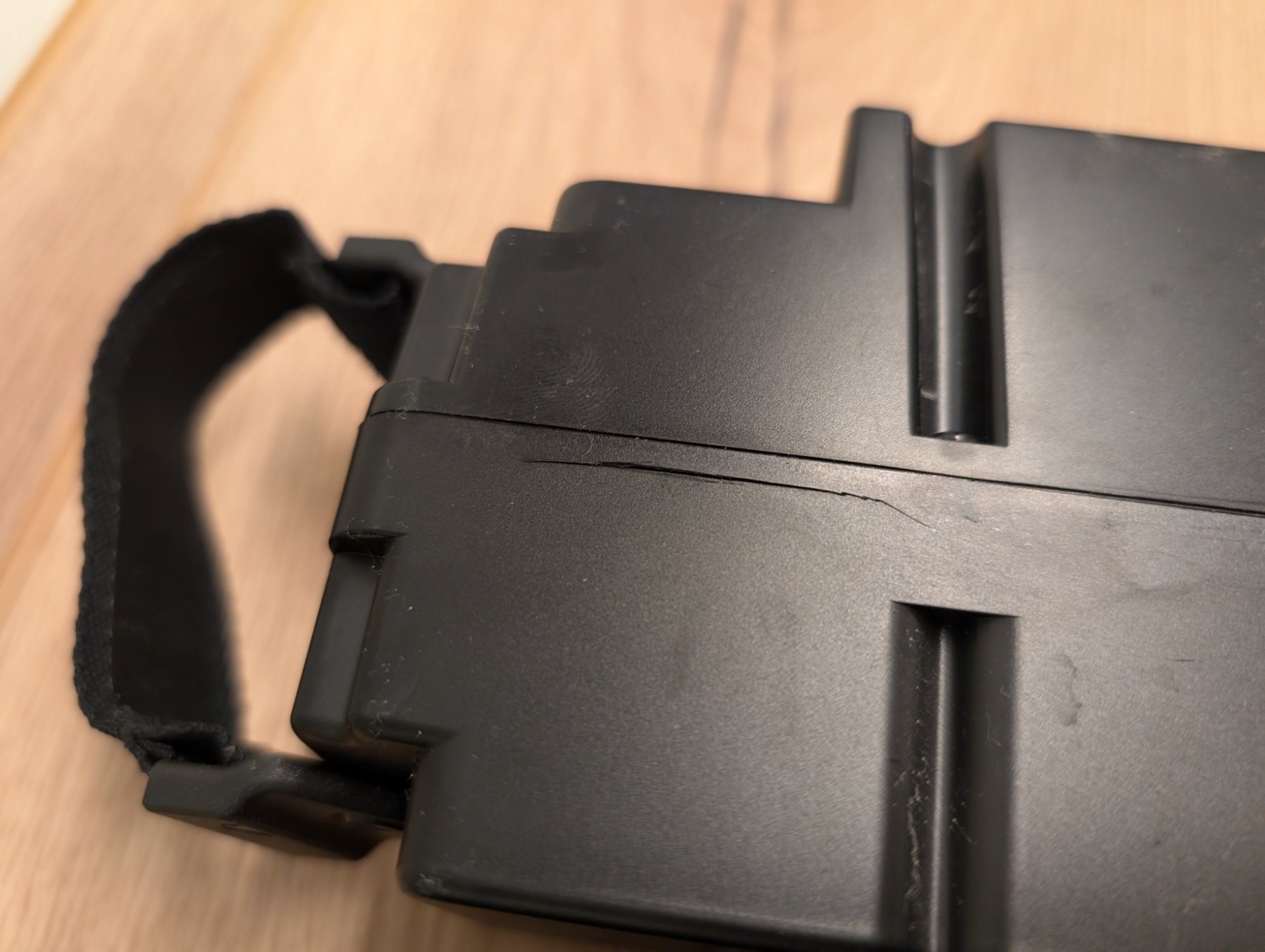

Thats what it may look like, copied from Torque:ON-Spectral:ON my22/23 Gerissne Akkugehäuse

This is what they're talking about :

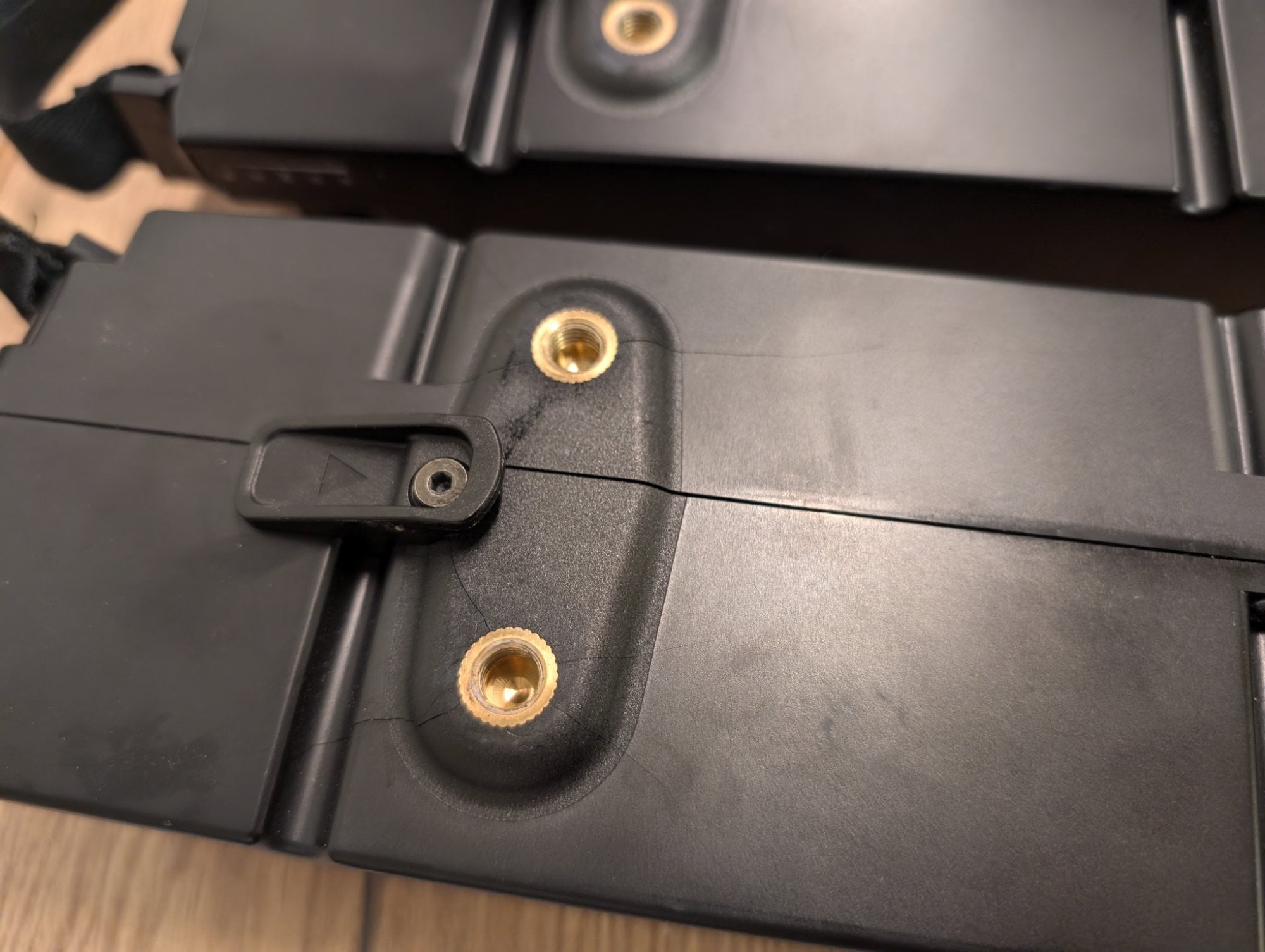

I also have a battery and I would think that 4 weeks is a VERY optimistic estimate if the solution is a new battery given sourcing leadtimes and 2 weeks of boat shipment from Asia. I assume that Trendpower will be footing the bill as it is likely due to there process control. It looks like most failures are at the screw boss and I would guess it is due to issues with control of a ultrasonic insertion process.

Looks like typical stress fatigue, they are going to need to resign the housing to resolve that and that's more than 4 weeks.
It's possible it's a materials batch issue but it's unlielly tbh.
As it's a fixing point it's carrying the load and failed.
That epoxy job is pretty rough lol.
