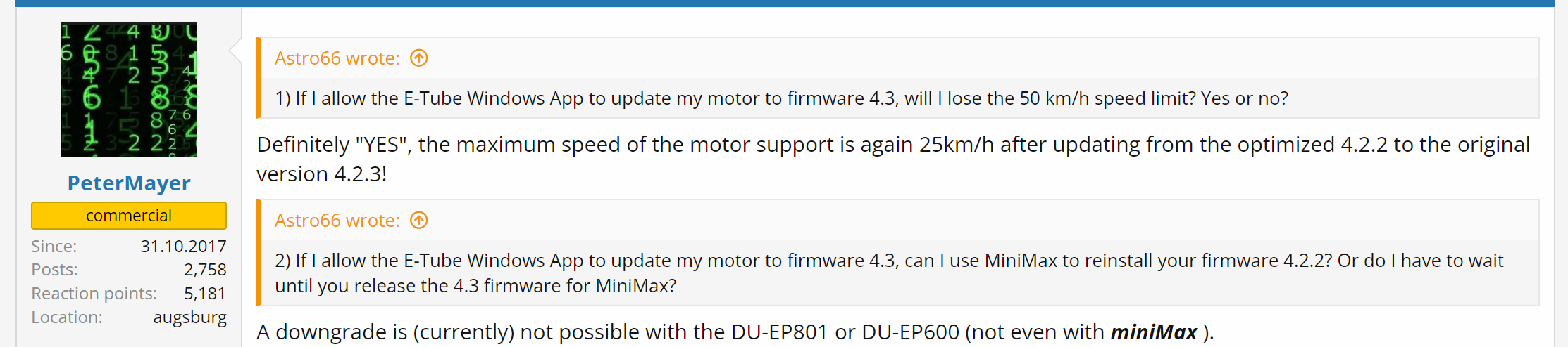

Unfortunately I've already installed 4.3 upgrade... so I can't roll back to 4.2 beforehand I'm assuming.. .
Shimano doesn't allow Firmware roll back, or even re-installing the same version. So you would need to put EMax's 4.3 firmware patch when they release it. Then hope Shimano release a new firmware, before you need a warranty repair.
That said. You can put the speed limit back to 25kph with the MiniMax software, so if your local bike shop only plug in the ETube App. It won't detect the modification. Then you can put it back to 50kph when you get the bike back.
But if the motor goes back to shimano. They will detect the EMax firmware modification, unless you put Shimano Firmware back in, and that can only be done when there is a new release.

This is not entirely correct. You can indeed reinstall the same current version of firmware you have. This is a needed function because if your current firmware has an issue, does not instal correctly, you have to able to overwrite it otherwise your motor is bricked. I have the sm-pce02 and I have reinstalled the same firmware version. Also, there is a log that captures EVERYTHING you do with the motor. So your logic of upgrading to the latest Shimano firmware if there is a warranty claim would not hold if they check the audit history of the motor. Using the sm-pce02 you can pull this log and see for yourself.
I have only looked at this in the Shimano ETube phone app. The button to download firmware to the motor, only appears when there is a new firmware to install. Perhaps this is different with the Windows App. I'll check it out.
I have checked with EMax. They definitely said you cannot roll back firmware. But perhaps re-installing the same firmware is possible with the windows app.
Re the logs : I have checked the log. There is no reference to the EMax upgrade. There is only a reference that you installed firmware. It does not say that the firmware is Emax's. It just has the revision number. So if I installed V4.3. The log would say I installed 4.2 twice and 4.3 once. But all parameters in the motor would be standard shimano EU parameters.
