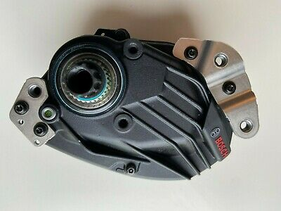

I bought an Ebike a $10000.00 Ebike at that, from Trek. I bought it because I travel the USA in a land cruiser and the bike allows me to get much needed exercise in areas where Mountains are the norm, I looked and tried out several bikes before landing on the 21 trek rail 9.8 XT. Now heres the rub after only 500 miles of what would be considered very mild riding for what this bike was designed for the 4 small bolts(self tapping into magnesium casing) sheared off. Went back and forth with trek, then back and forth with guys that sold me bike(600miles from my house) and the ONLY thing that can be done is hand bike over for who knows how long so they can pull motor and ship it of to Bosch wait for new motor to be shipped back. then the bike will be usable again. I said to trek dealer screw the waranty just sell me a motor Ill put it in and all will be well. And sadly that isnt an option. So the bike of the year has a problem. And after posting pics of my motor mount issues I discovered I wasnt the only one. I build things big things, that go where other things don't go, and Ill tell you I wouldn't use self tapping bolts that can shear off, Maybe bosch shouldnt either. I shouldnt have to pay 10K and within 5 months give it back because they built it poorly. If the bike breaks and the customer wants to buy the parts to FIX IT, they should be allowed. To me its a lot better than handing off bike until who knows long.

please put up some pics so we can see which bolts you are talking about.
We all need to keep an eye on them.
Is this a Trek design fault or inherent in all Bosch motors.? Guess it is the latest CX motor as fitted to my Ries & Muller Delight Mountain.
Hope you get it fixed.
BTW what bolts would you replace them with now you know the problem?

Really keen to see what self tapers your talking about.

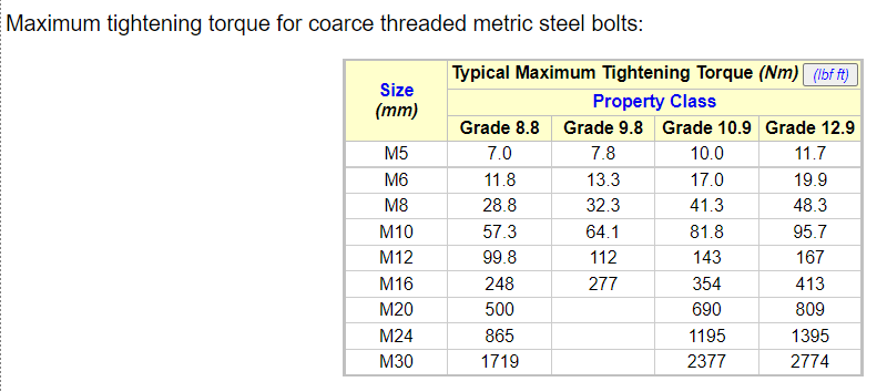

It might be a good idea to replace the screws with something like 8.8 grade before the original ones break. If they break that easily they must be something like 4.8 grade although it's difficult to see how Bosch would use something that soft. I see someone on the MBR forum used 10.4s but they could be a little brittle for this application. I'm going to change mine. The screws are M5 BTW.....not self tappers. Checking the main motor mount bolts (M8?) might be wothwhile as well. If they are loose the bracket might be fretting it's way through the M5 screws.

Can somebody post pics of the actual assembly. I know there's a drawing but it would be cool to see what this looks like off the bike.

I replied in the other thread, but I'll add in here as well. I had a creak I COULD NOT get rid of. I've got the same bike as the OP, a 9.8XT, 4 months old. As the shop is 150 miles and a ferry ride away I dived into it myself.
One M8 bolt was cross threaded, all M5 Bolts were loose enough to allow the mounting plates to move around. When fixings are that loose things creak and bolts shear. Blue loctite and torquing up properly fixed the issue. No problems since in 8 months.

did the bolts shear off or did the threads strip? if the bolts broke just back out the remaining piece in the motor and buy new bolts. If the threads are stripped....then you have a problem. I assume you bought the bike new and no previous owner over-torqued the bolts, because their spec it surprisingly low for the size of the bolt.
The torque value is rediculousy low, especially when you consider the plates are drilled with large clearance holes, the screws have flanged heads, and no locking washers. It's almost as if they're inviting movement and loosening. If replacing the screws make sure to use ones that are the same length, the casting is pretty thin in places and the steel screws probably help strengthen the area up.

If the bolts are M5 (which the MTBR thread seem to indicate) about right.
M5 is a bit weedy for the application though.
