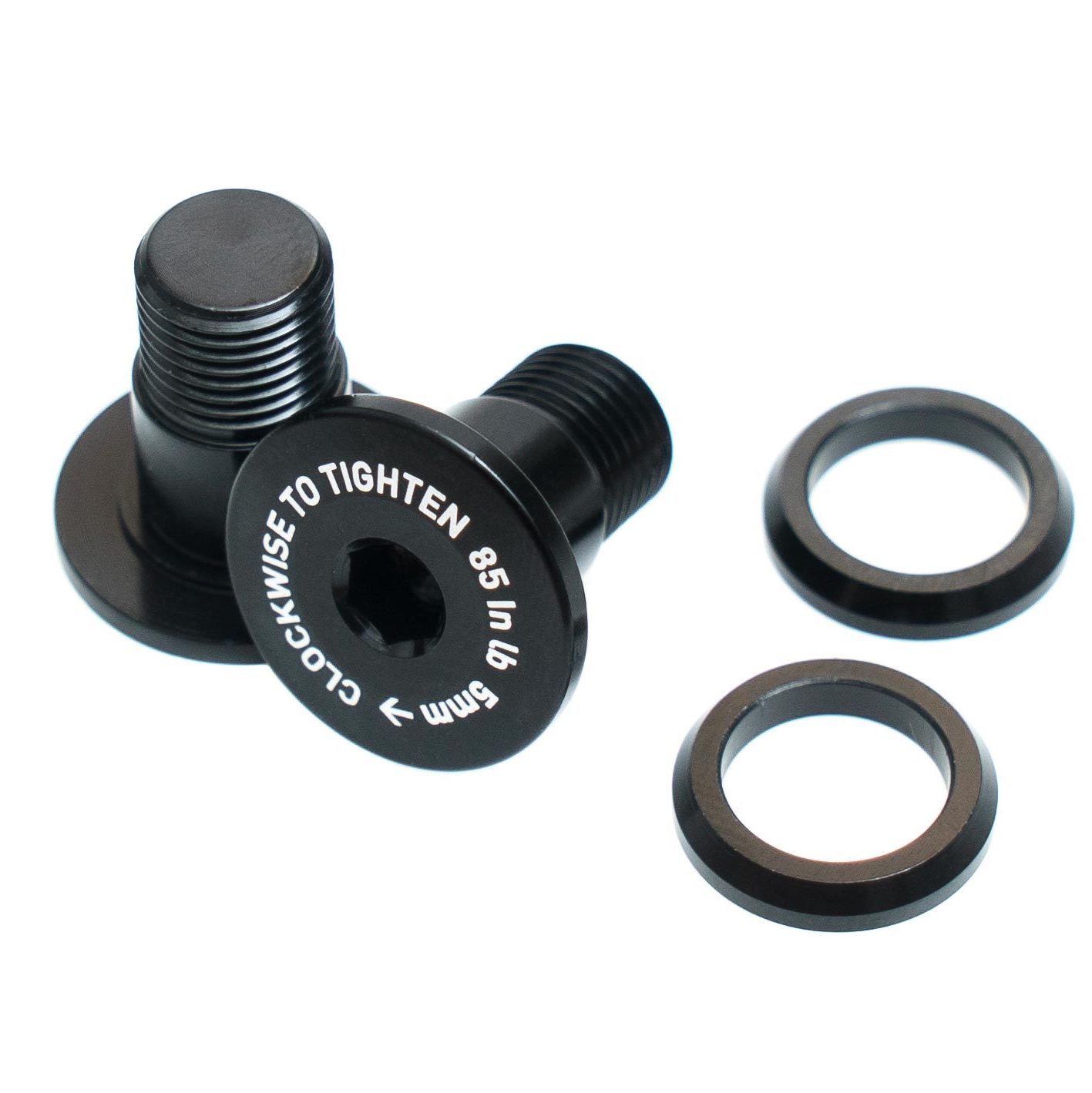

That been said you still need this trunnion spacer yourself, it sit between the frame and upper shock.
It doest come with the frame. It's from Evil frame trunnion bolt spacer.

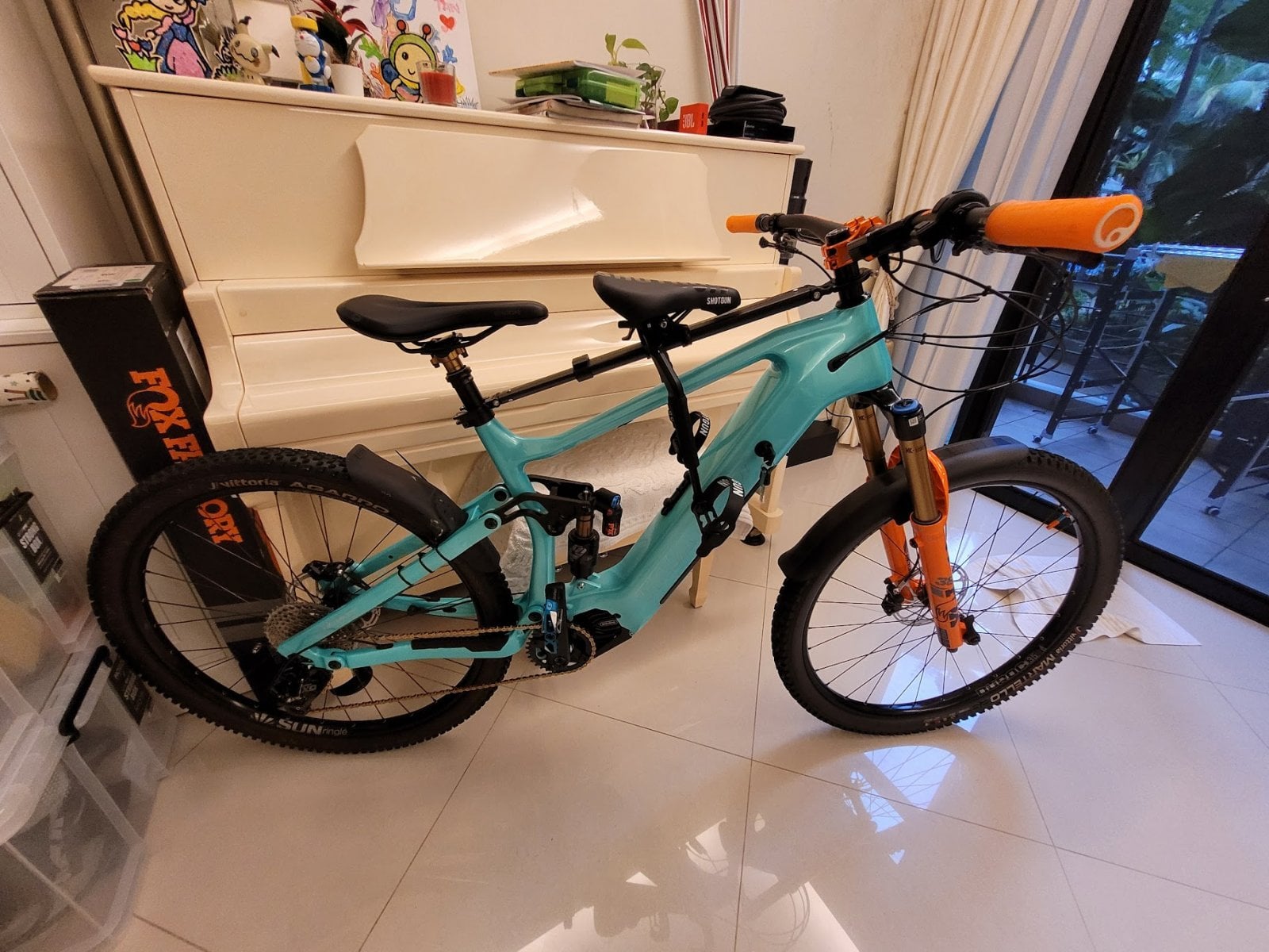

One thing to note is the seat post insertion is not much.. as you can see from my pic that's the max it will go.. I'm running a 150mm fox transfer post and it's running a bit too high for me, thinking of changing it to 125mm.

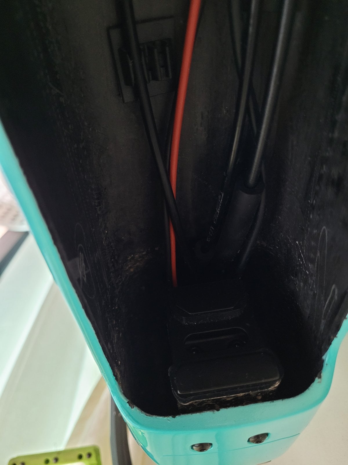

Hi,
Me again.

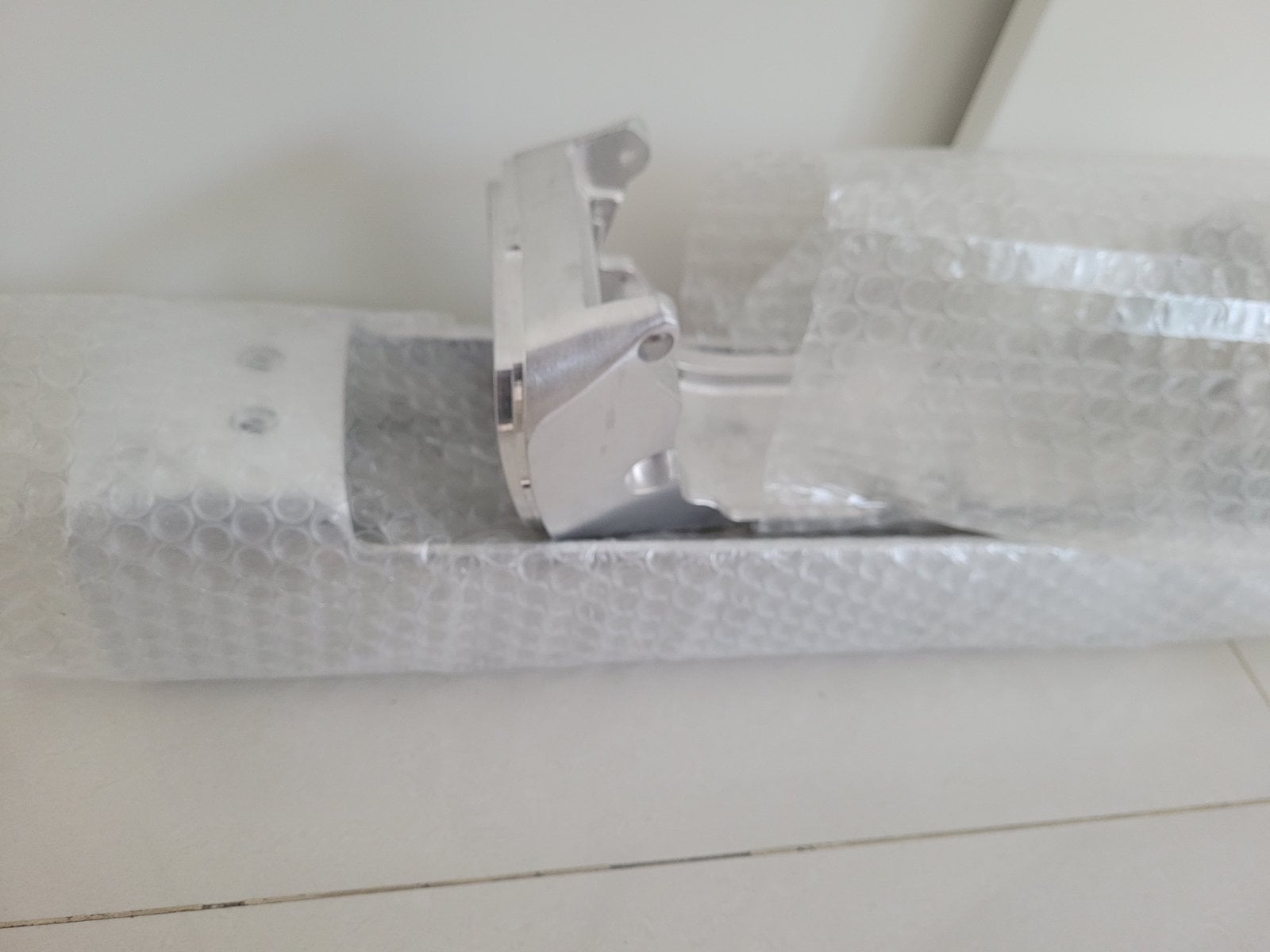

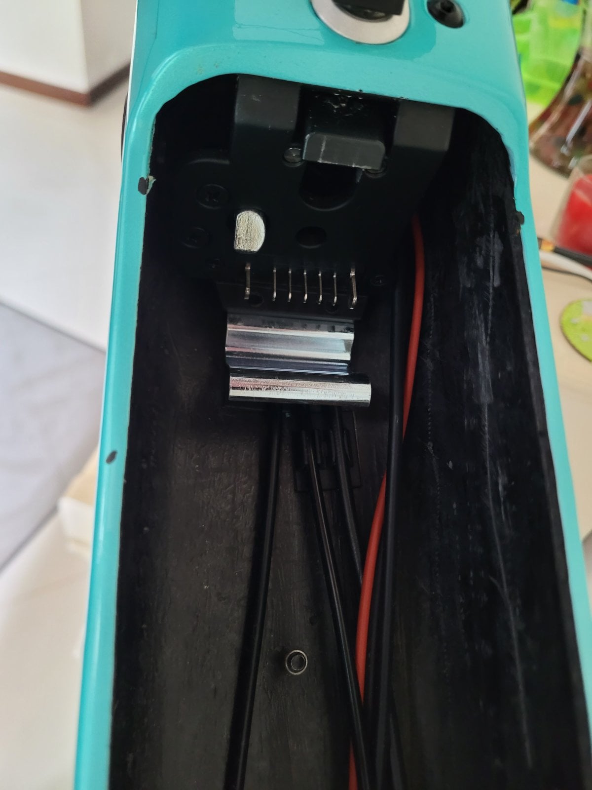

Wondered if you can please send me pics of the underside of your frame, with both the battery in ace, as well as with it removed? Reason I ask is that the battery/motor company I used sent me a massive metal fabricated 'battery adaptor' which doesn't fit in the frame, and I'm not even sure it's needed!
Thanks in advance for some detailed pics if you don't mind making 5 mins.

Hi,
Me again.
near the bottom mount
near the headtube
If you're talking about this, I believe it's to convert your non-Emtb to a Emtb replacing the downtube and BB.
Hope this helps..
near the headtube
Hope this helps..

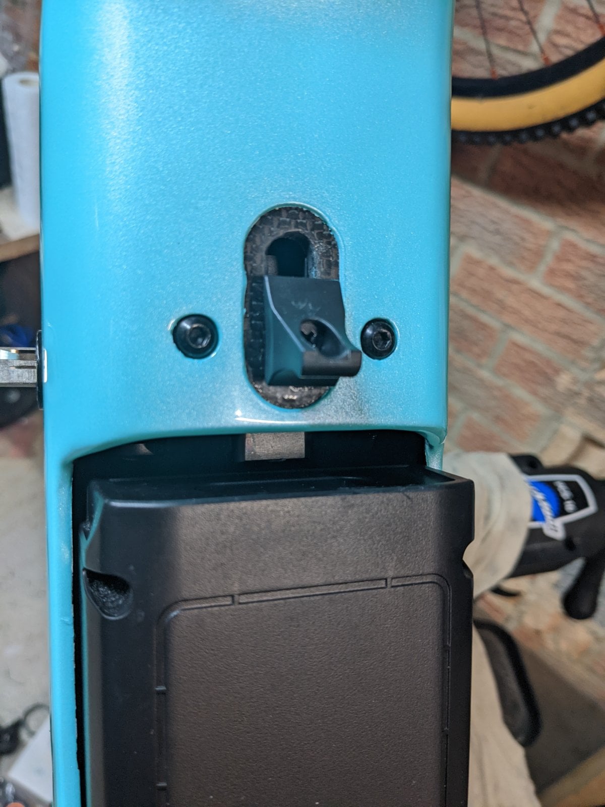

1. When fitted, is your battery flush with the frame? My BT F04 600 battery sits out from the frame quite a bit (see picture).
2. When the battery is slotted in, it's near impossible to remove, stuck solid! I'm having the unbolt the lower bracket bolts to remove it.
Am I missing something here?
Thanks for your help 👍🏼

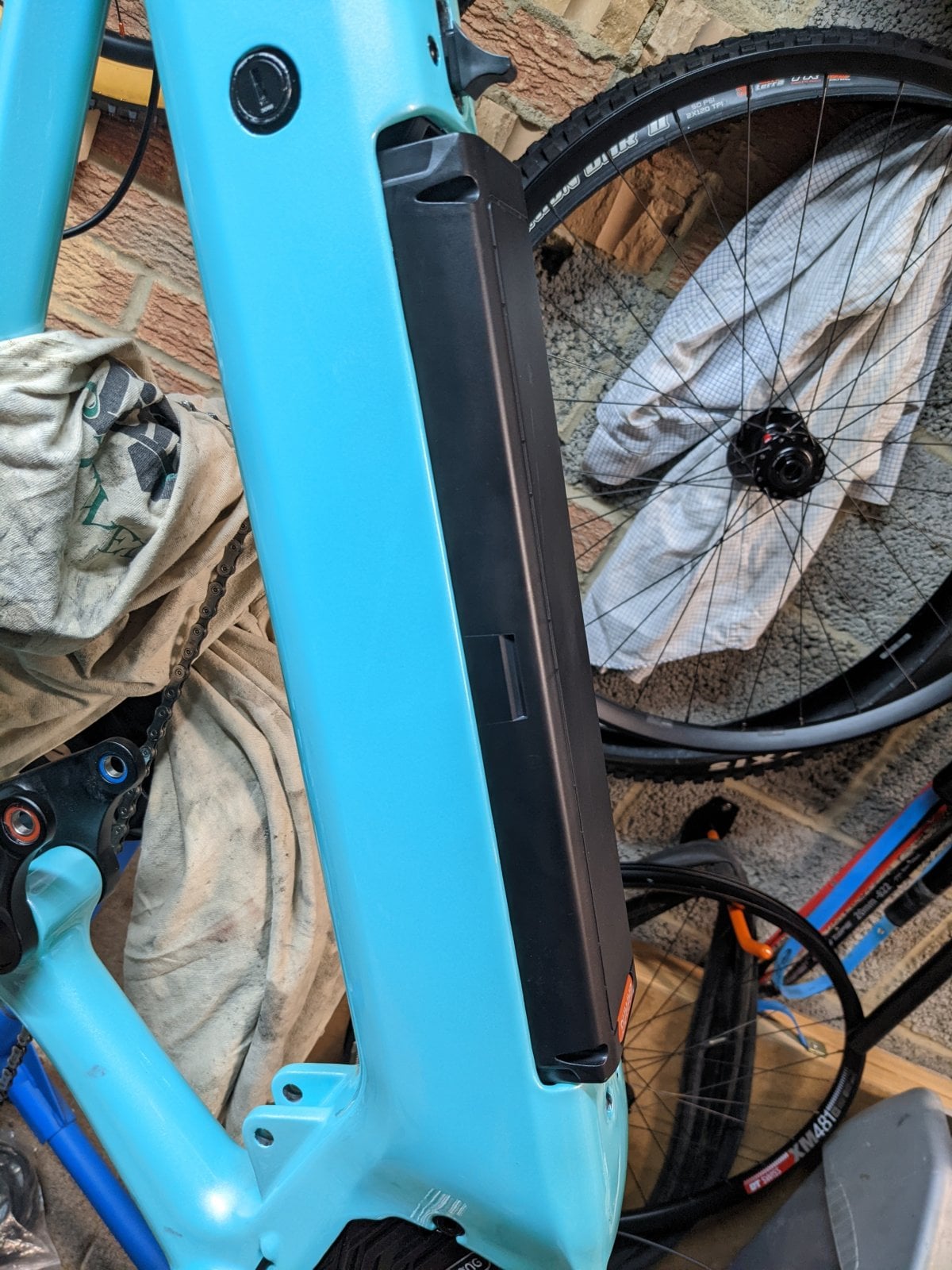

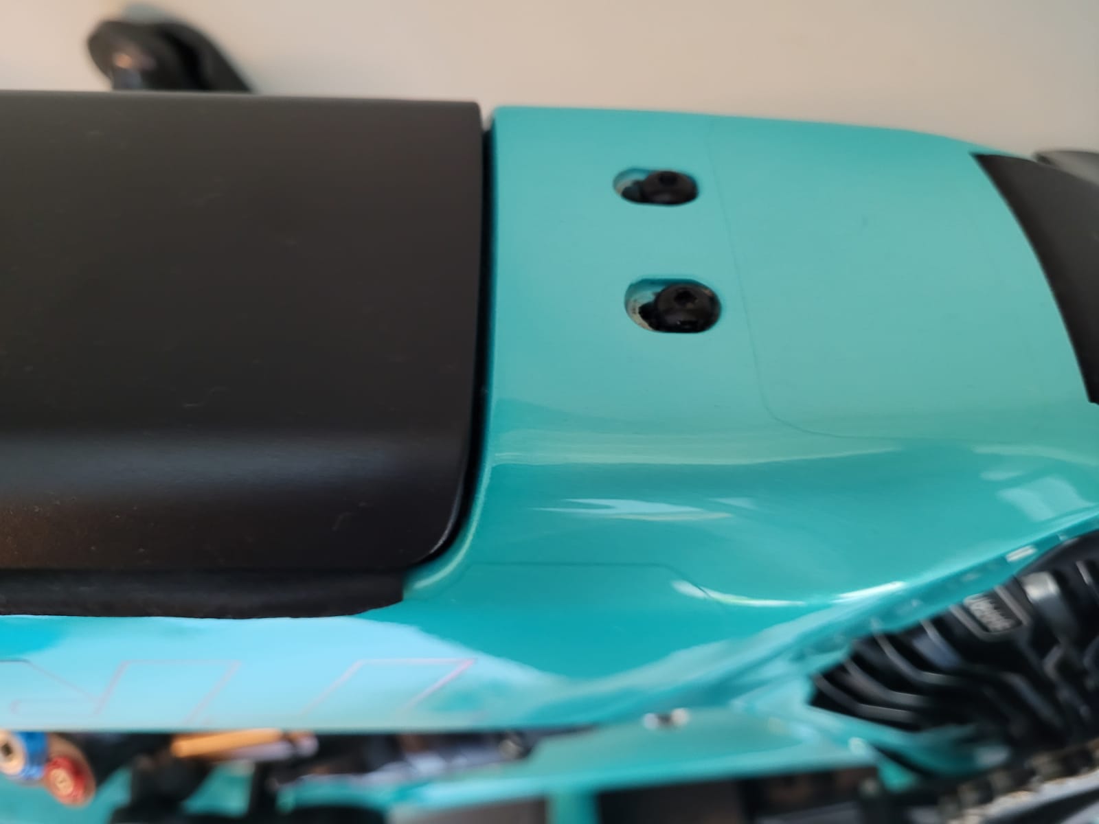

Hi again,
Just getting to the final stages of my build, now having a few minutes to dedicate to it!
Couple of questions:
So I've sorted the battery removal issue, but still, the battery sticks out from the frame a lot when fitted, and there's a gaping hole at the top end where mud and rain can get into the frame, exactly where the terminals are!!?
@lalaland - any chance I can see how your battery fits in comparison? Assume you have the BT F04 600 battery also?

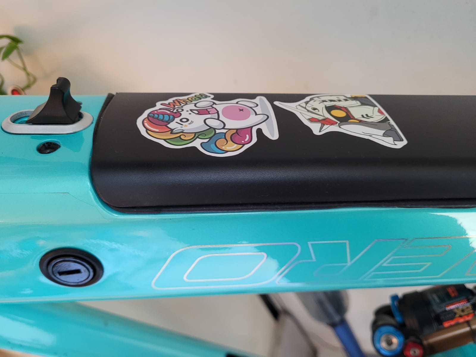

Hey! sorry for the late reply.. haven't login for awhile. Mine sits flush with the frame, it was a bit hard to sit all the way in at first due to the metal spring, so I had to bend it just a bit so it doesn't push the battery out too hard. also try to fit the battery shield to the battery might just close the gap a bit more, I also fit some car door trimmings at the side of the battery shield just to weather proof it a bit.
For the battery, I'm using the BT F03 400 but should be the same size as yours.

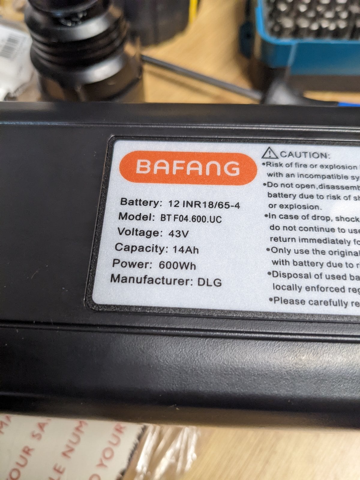

Thanks for coming back to me @lalaland.
My battery is a 600, so is much deeper than the 400, thus why it sits out from the frame :( I wish ICAN advised this before purchase!
As a result, my frame has no battery cover like yours, and is quite open to the elements. I'm honestly really disappointed, and ICAN aren't being very helpful at all.

have you checked with ican? the frame stated it's comparable with both batteries.
anyway just to be sure your battery fits and works but it's not flush with the frame right?
Exactly. It fits, and locks into place securely, but sticks out by nearly an inch, but the worst aspect is that top and bottom, there's gaping gaps for crap to get into the electrical terminals and inner frame in general. I've emailed ICAN again to ask they take this more seriously to find an adequate solution, as it's not fit for anything bar super dry conditions presently.
I bought the exact motor and battery kit recommended on the ICAN website, so hopefully they're committed to resolving this!

i see.. best is to change to a smaller battery. hope they are able to help you
all worst just ride the crap out of it with some weatherproof trimming.
Thanks. Need to figure out how to weatherproof it a bit, without ugly fudge fixes like duct tape! Did you find a good product for the sides?
