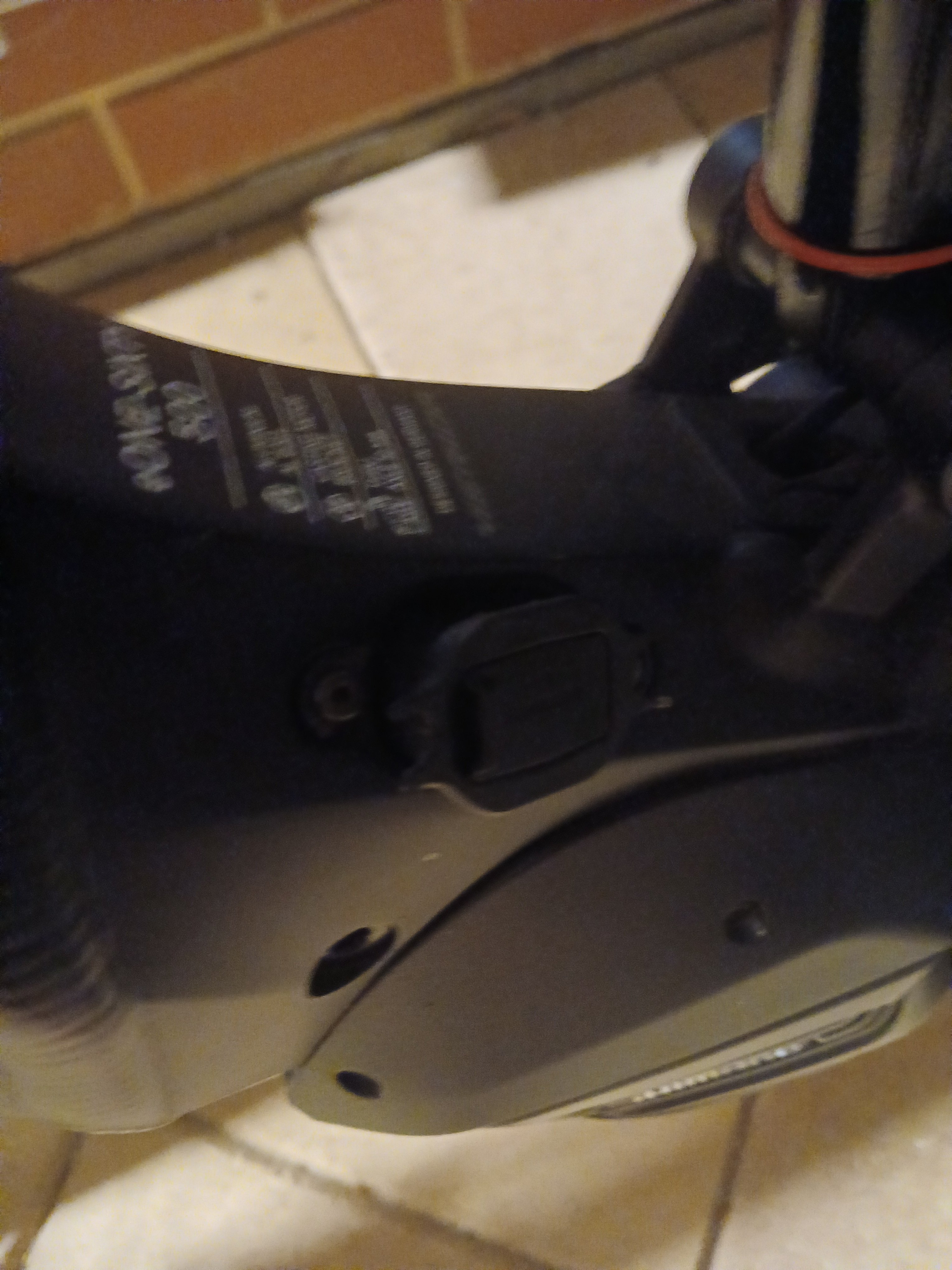

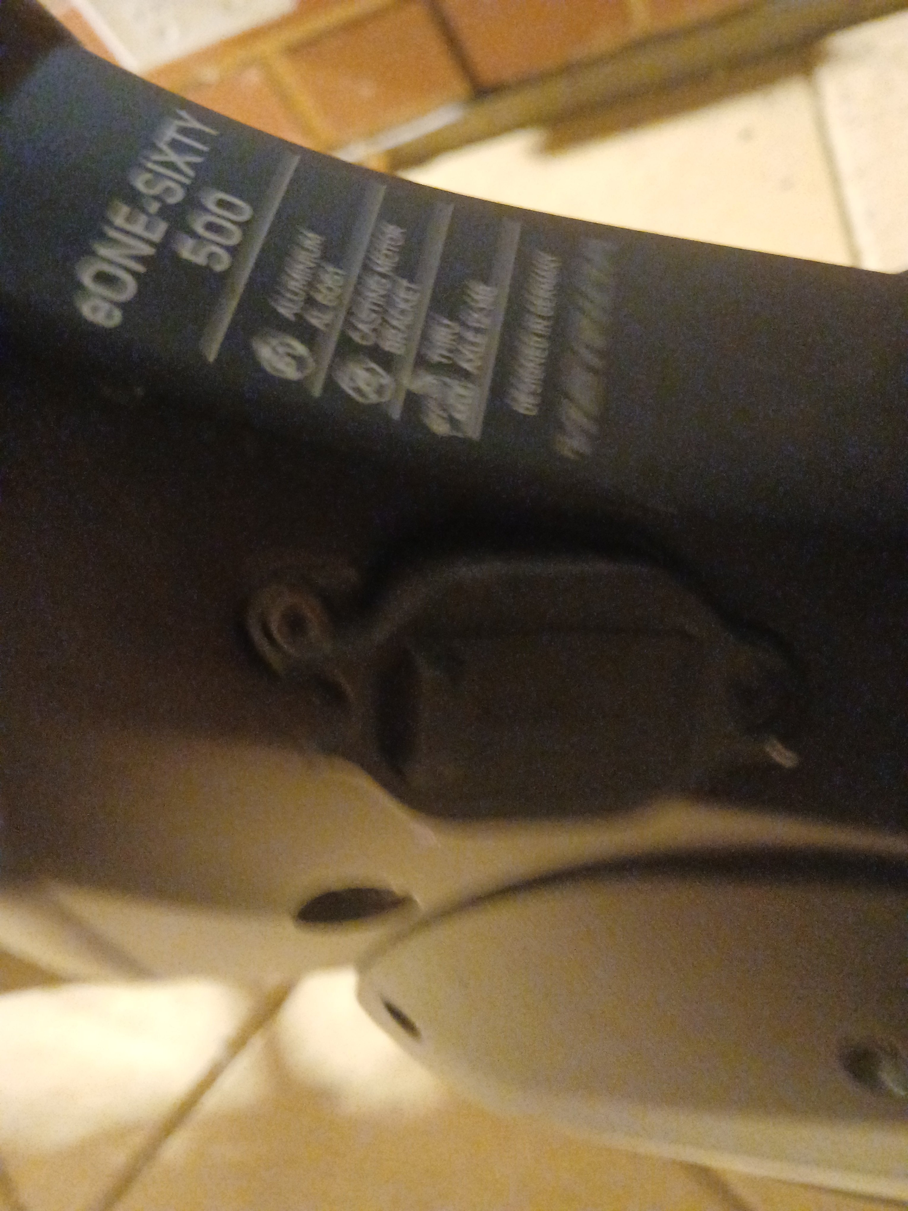

I need help with my broken charger port on my merida e160 500 ebike.
Ethan
Jan 21, 2025
Victor harbor
My merida e160 500 ebike charger cover I'm not sure what to do now as I have looked at the merida e160 500 parts and couldn't find anything on the merida store for my exact bike and I looked at ebay to find any but couldn't I need help and advice on what I should do or any websites that do sell the exact item to fix this problem. The bike also has 9 months warranty so I'm not sure if that will help if I can't find the part.

Difficult to see because the picture is blurred. But I cannot help you with a link anyway, so the only advice I can give is to ask your local dealer. They are sure to have one or be able to get one.

Hi Ethan.
I can’t help your situation but the charger door on the Trek Rail is pretty flimsy also. I’ve managed to keep it functioning but I did expect to install a new cover.

Contact Merida direct for help. If all efforts to get a replacement fail make your own cover using a piece of neoprene fixed to the frame with strips of hd adhesive velcro. Regardless of whether the charger cover on any bike I buy is OK or not I additional make a neoprene cover for it.
