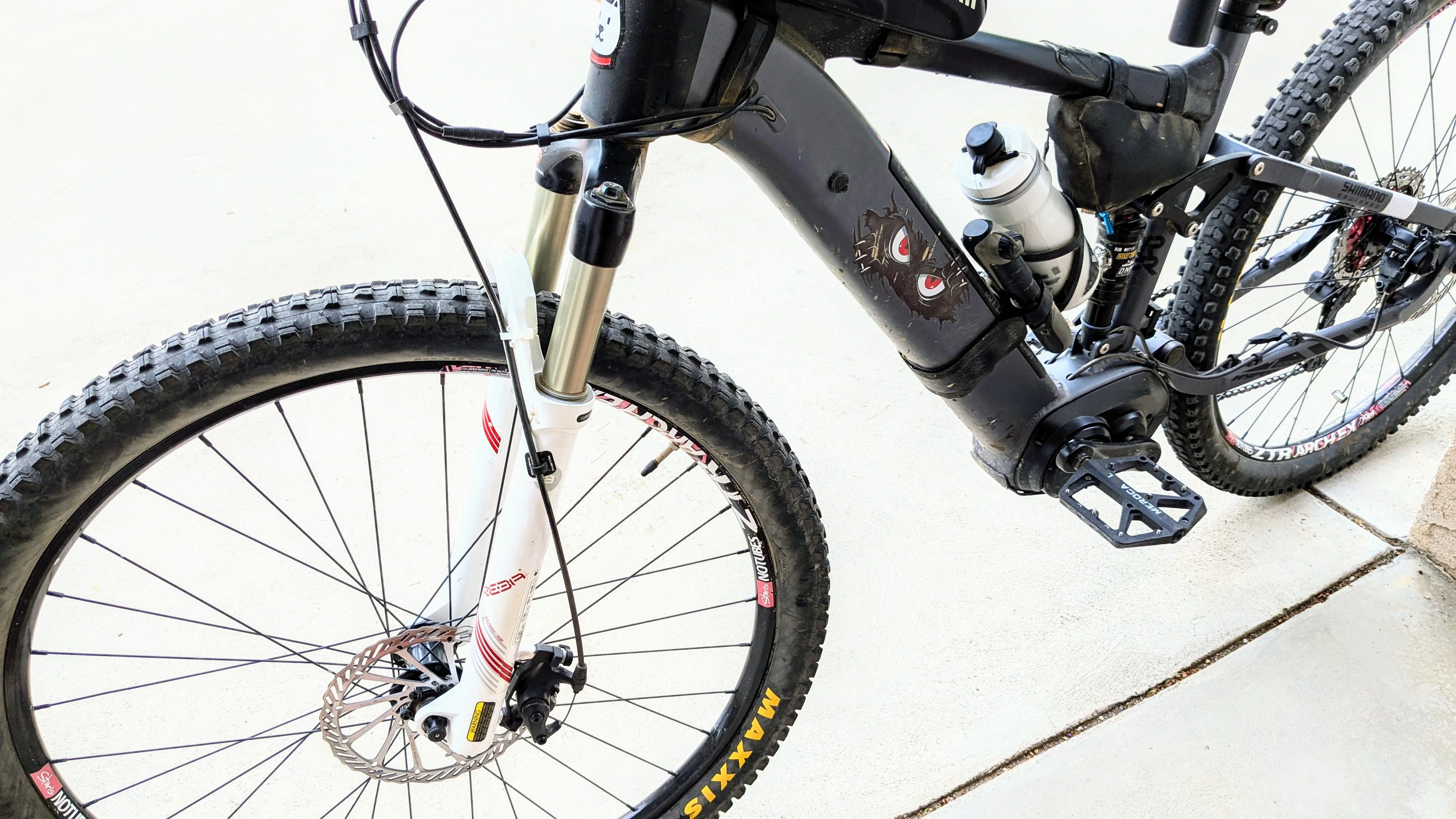

Used Rock Shox Reba forks 90-~110mm travel
Used Stan’s Tubeless ZTR Arch Ex front wheel with 15mm to 10mm adapters
Used Stan’s Tubeless ZTR Arch Ex rear wheel 10x135 QR through axle
Bolt through front axle (QR not secure enough for off road)
Bolt through 10mm rear axle (QR not secure enough)

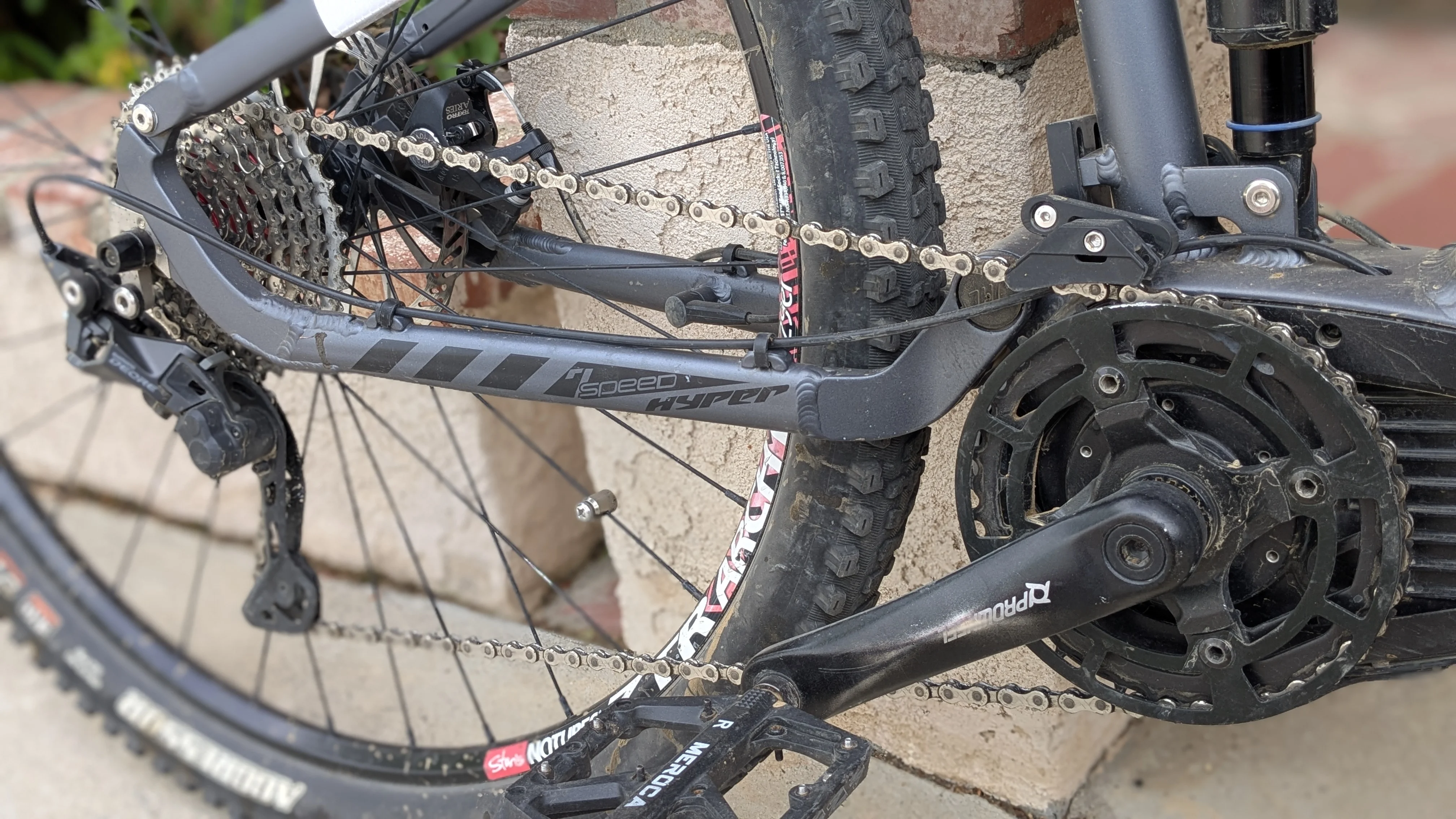

Shimano Deore RD M5120 SGS 10sp locking mech (faster shifting even on power)
Shimano Deore SL-M6000 10sp rapid fire shifter
11 speed chain (stronger and same width as 10sp, plus I had it new leftover from another bike)
10 speed Cassette 11-40 (With ebike, no need for lower gears, and 11t gives better top end. Also leftover from another bike)

Maxxis tire, no tubes. (29 x 2.3” to clear swing arm and forks)
152mm crank arms (less thigh burn, easier for higher cadence and less pedal strikes)

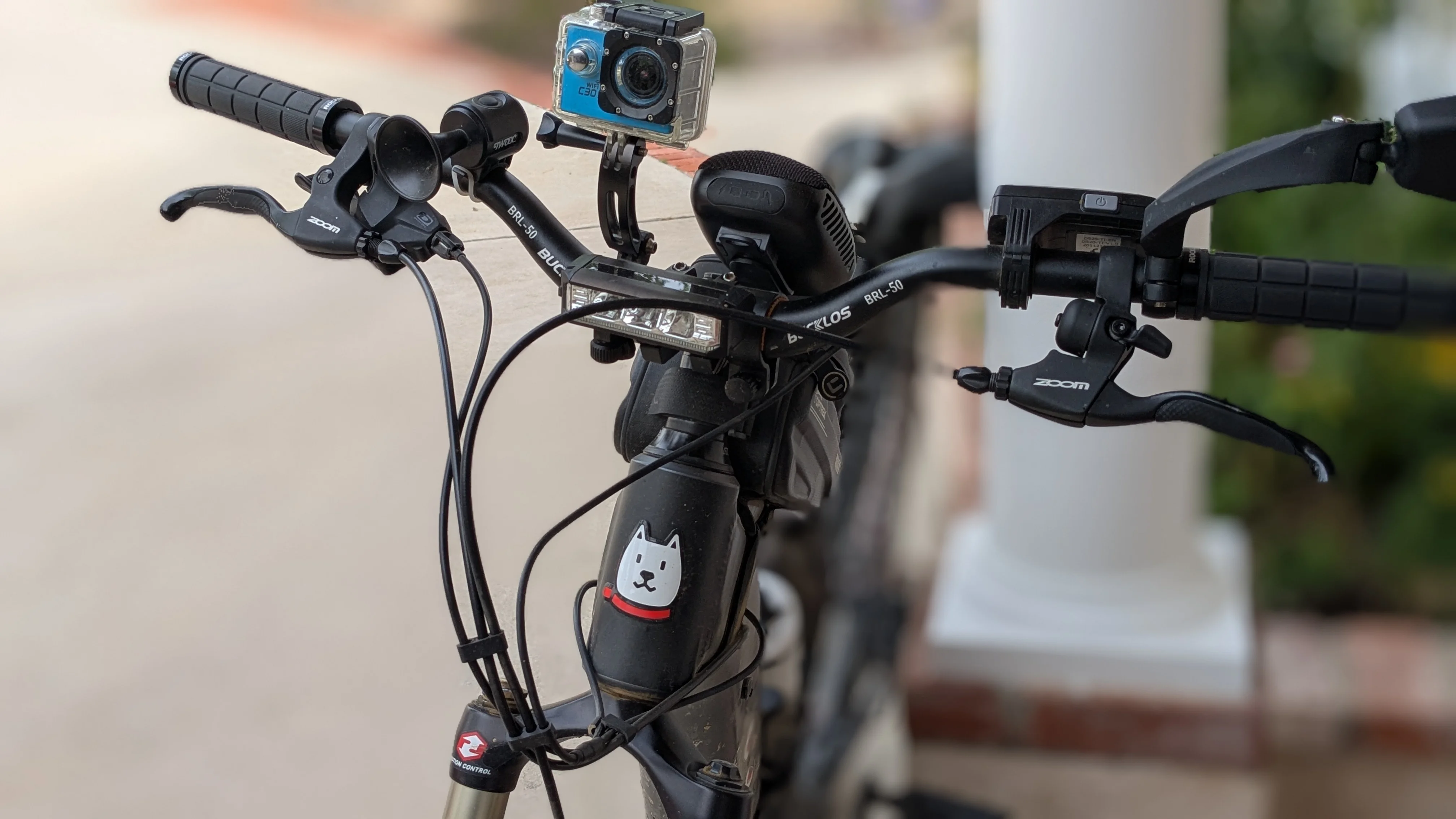

Zoom brake levers with integrated bell (best levers… ever)
Electric horn (to scare coyotes… sometimes even does too)

LED headlight and rear light
Front 180mm SRAM style rotor with adapter
Rear 180mm open slotted style rotor with adapter. (stronger breaking rotor to balance breaking force from front to back)
38t Narrow wide steel chain ring (no dropped chains and longer life than aluminum chain rings on ebike)

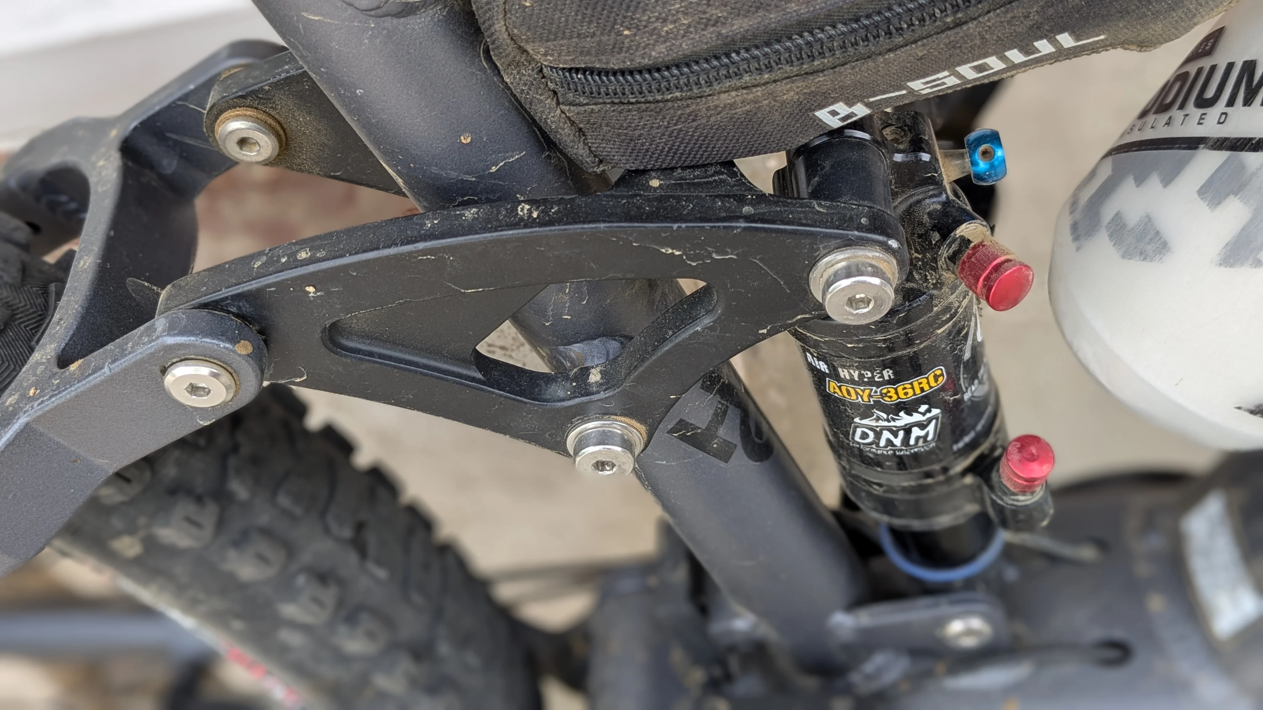

Reworked all linkages with new bronze bushings and stainless sex bolts (original linkages are overly tight and sloppy at the same time and stops the suspension from actually working)
Rear shock DNM AOY-36 RC (amazing difference here for original shock is near useless)

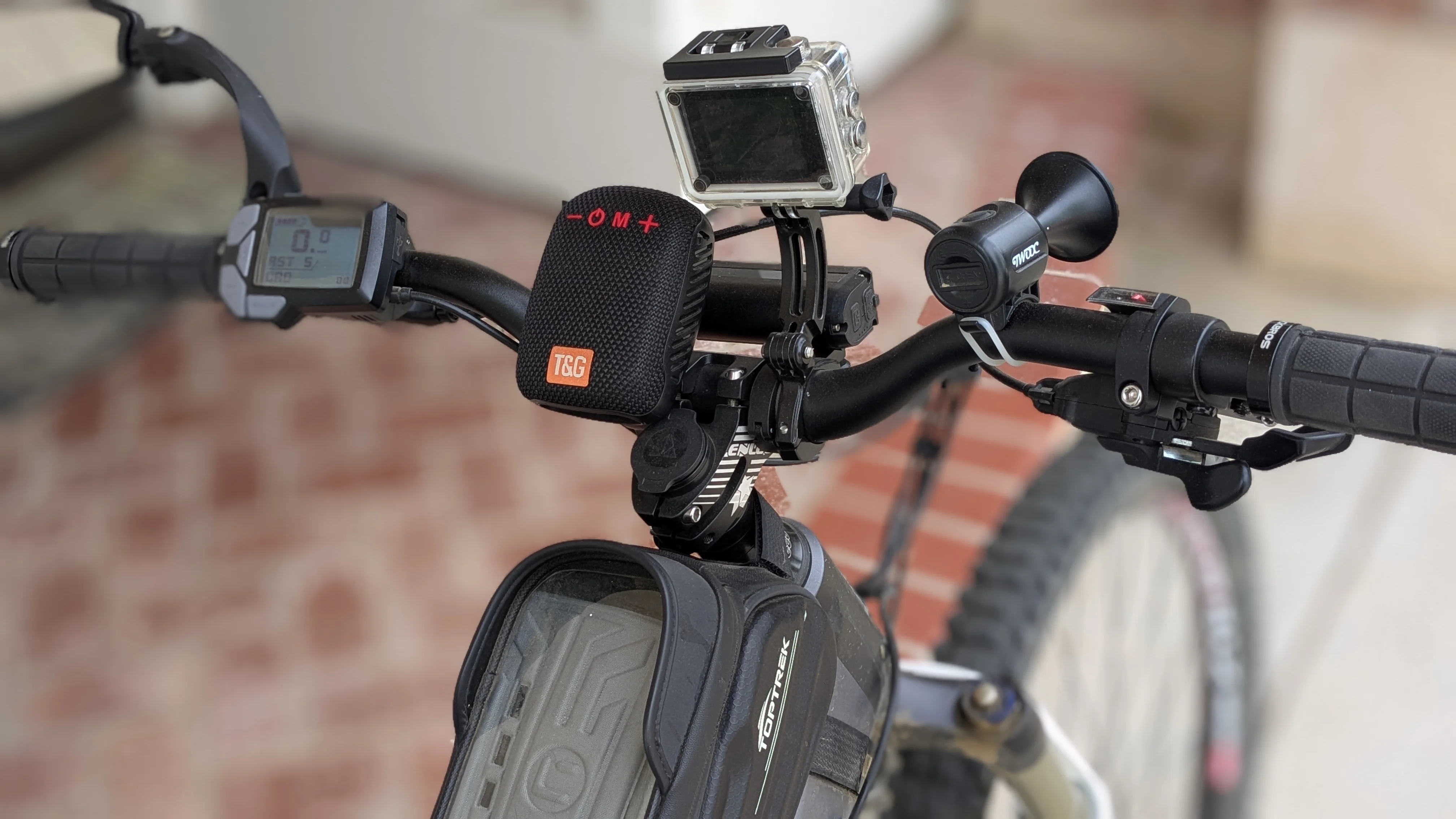

Rigid action camera mount brackets (smooth videos without camera shake)
Slide in speaker for music/podcasts
