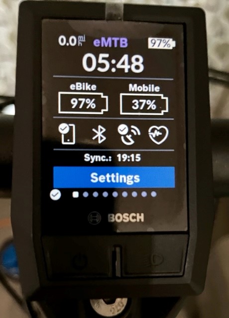

I think this works now tested on my Fenix 6x last night but not gone out for ride for the ultimate test.
Mine would show the heart rate monitor was connected on that screen in your screenshot ,but the actual heart rate would always display as '-'.
Is yours displaying the actual heart rate?
Thats the exact issue I am getting although not had a chance to play bike with LBS so just waiting for call to collect, I will keep you posted.
