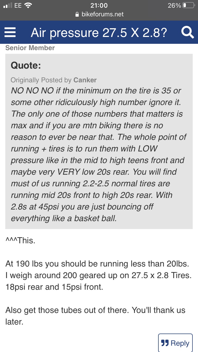

So what's the optimum pressure for 2.8"
tyres then? lt does indeed say 35psi on the tyre, but l thought that was a maximum rating.
As l said, when l started a thread about it l
got answers ranging from under 10psi to 25psi.

Here's a thread on it, on another forum. It suggests 20psi as a maximum, and to start at 15psi

As Neeko says, experiment and find what works for you. Park up somewhere close to a trail with a few berms, take a run at 20 psi, then pump to 25psi, take another run, then 30 psi, take another run, 35 psi etc etc - eventually you’ll find the sweet spot and you’ll just know when the bike feels right for you. Sounds like a faff but it’s worth it

To me, running 2.6 front and rear on the ebike, bellow 30psi at front and above 30 at rear.

I can’t remember the maximum rating and I’m nowhere near my bike as I’m in a hotel 250 miles away but it was around 50-60 psi, 35 being the minimum. I agree loads of people run them at lower pressures, but I put my faith in the rubber engineers at Maxxis more than I do random people on internet forums!

Okay thank you l just needed a start point as
l read conflicting information online.
On the one hand people are saying start at 15psi
And on the other, start at 40psi.
l weigh around 65kg
l've currently got them at 20psi and the bike feels great.
EXCEPT for the issue l started this thread with !!

The sweet spot in psi between floppy lettuce and bouncy ball with larger volume tyres is a fairly narrow window. But it's a lot lower for a lighter rider than a heavier one. Dual ply (DH) casings help support and damp them a fair bit but the downside is they weigh a ton.

I think I tried my 2.8's down to 5psi. They stayed on the rims, but were horrible to ride.
It depends what you want from the bike. 15 will be great for some people. A 2.8 has a lot of volume, so you can get away with a lower pressure. If you feel 20 is right for you, then maybe it is. I'd start with more fork pressure and as people have said, just sessioning a corner.

Thought this was strange so I had a look at the 2.8 DHRII hanging on my garage wall. At 40 psi you have a chance of blowing the tyre and hurting yourself as it's actually rated at 17-35 psi. The 35 near the logo printed is the MAXIMUM. The range is stamped into the rubber in small font on each side.
