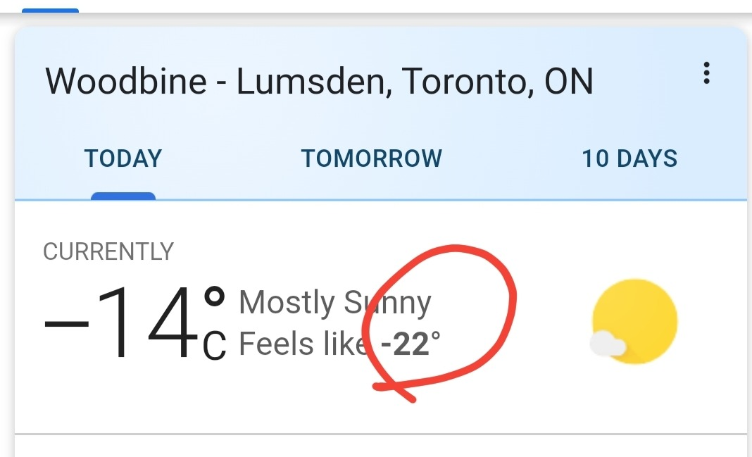

Praxis USA doesn't ship to Canada and their Canadian distributor doesn't have the bolt! Today I went to a few bike stores in the area and none of them have a spare one (it's a proprietary bolt to praxis). The store were I bought the Levo will try to get it from Specialized directly. I think I will be off the bike for a while. I'm in the biggest city in Canada but we are still not well served for e-mtb related things here (like it is in the UK and other parts of Europe).
I wouldn't want to ride in this weather anyways:
Does anyone happen to have a spare bolt or a spare/broken crank and is willing to sell the bolt from it? It's the Praxis M24 crank bolt. Thanks.

Is the bolt material suitable to be used in temperatures like that?
Have you heard of low temperature enbrittlement?
Where is a metallurgist when you need one? :unsure:
@OP, where did you read it needed to go to 50nm???
The idea of the cold making the material brittle make sense, but I think in this case my torque wrench is just not working anymore, I hadn't used in a while. It's a large one so it provides a lot of leverage.
50Nm is marked on the bolt itself and it's also in the specialized documentation but in hindsight I must have applied a lot more than 50Nm.

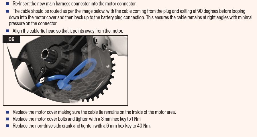

Interesting thing I came across now are this instructions for replacing the power cable, which at the last step tell you to tighten crank bolt to 40Nm. I guess this instructions were released about a month ago (when new revision of the cable was released) and maybe Specialized also revised this torque for crank bolt which now seems to be at more reasonable 40Nm ...
motor-cable-fitting-guide-png.25175

I like your version of the story, but the last step also says 6mm hex key while it's actually 8mm. So I'm more inclined to think this is a typo.

Let's just believe only a '6 hex key' is a typo :ROFLMAO:
