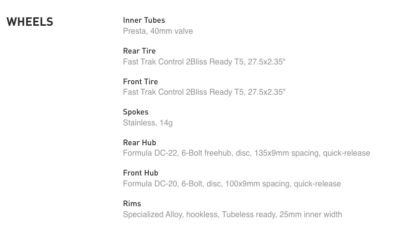

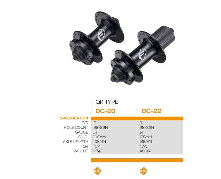

Looking at the Spesh website, and then the Formula website - it looks like I'm lacking some info... that I probably won't get until I have the bike!
Might be worth asking the LBS if they can get this info for me... so that I can have spokes ready?
