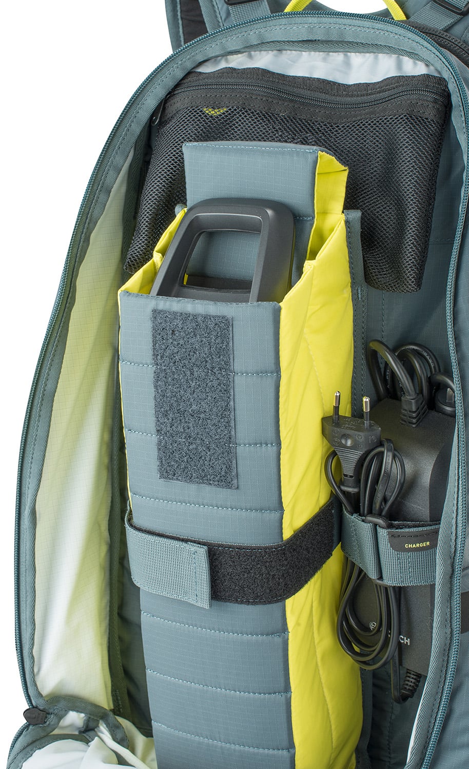

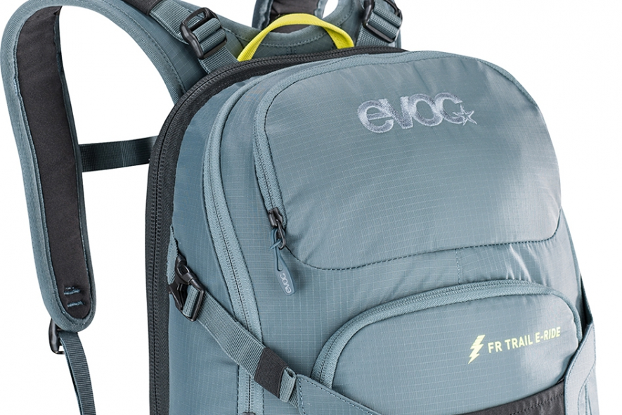

I found this lovely looking pack from EVOC, but it doesn't list it as being able to carry the Levo battery :
BIKE 2018 // FR TRAIL E-RIDE: EVOC LAUNCHES 1ST PROTECTOR BACKPACK SPECIFICALLY FOR E-MOUNTAIN BIKERS - EVOC - PROTECTIVE SPORTS PACKS

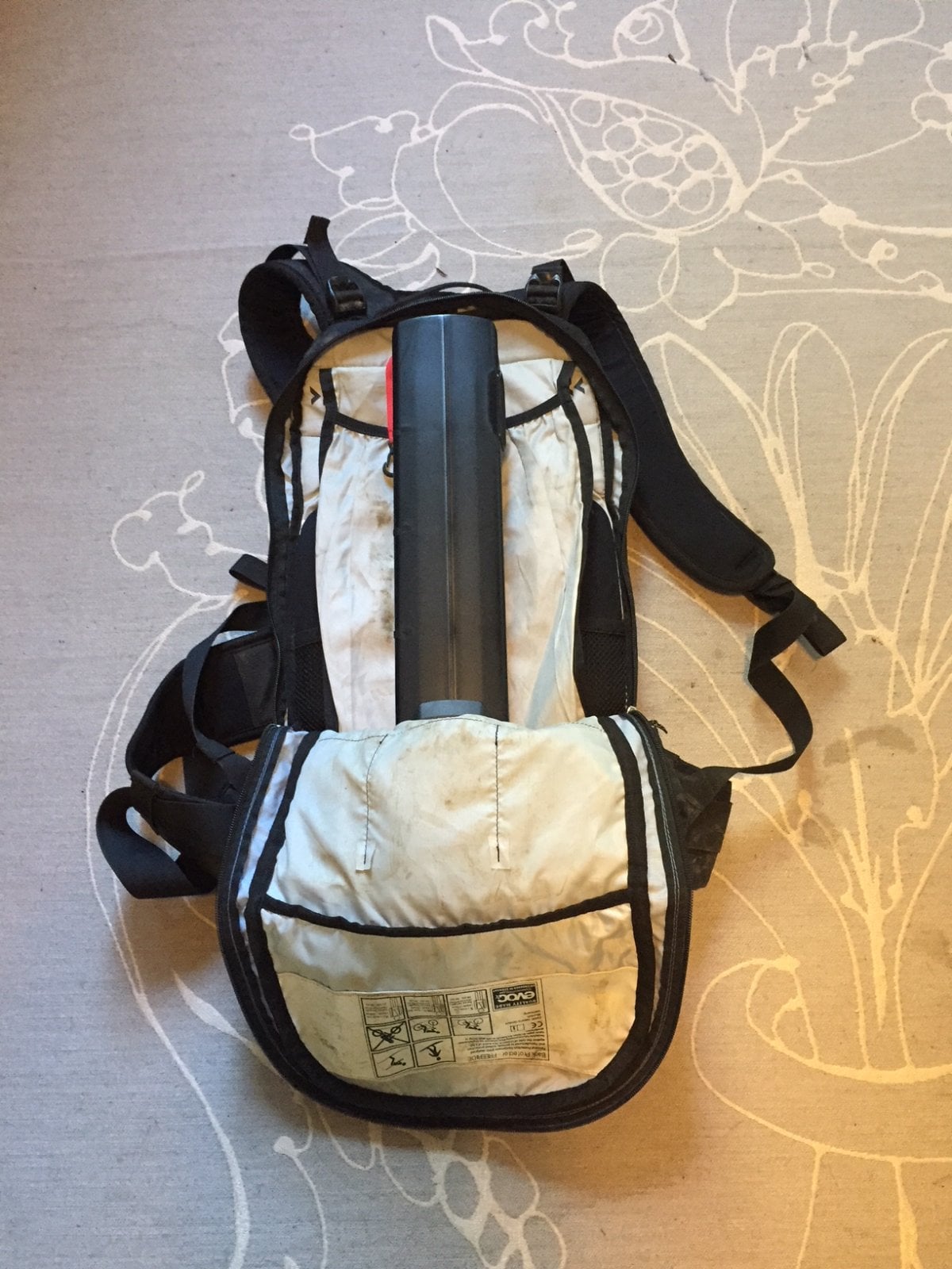

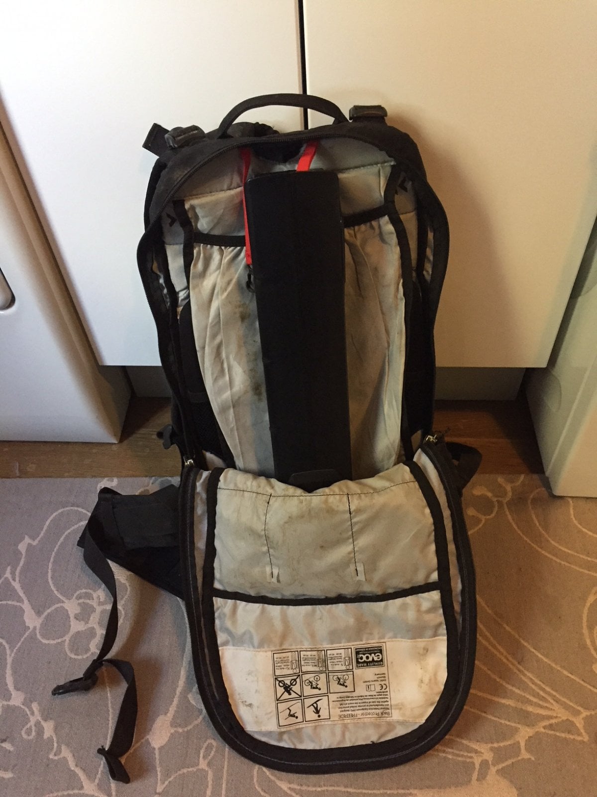

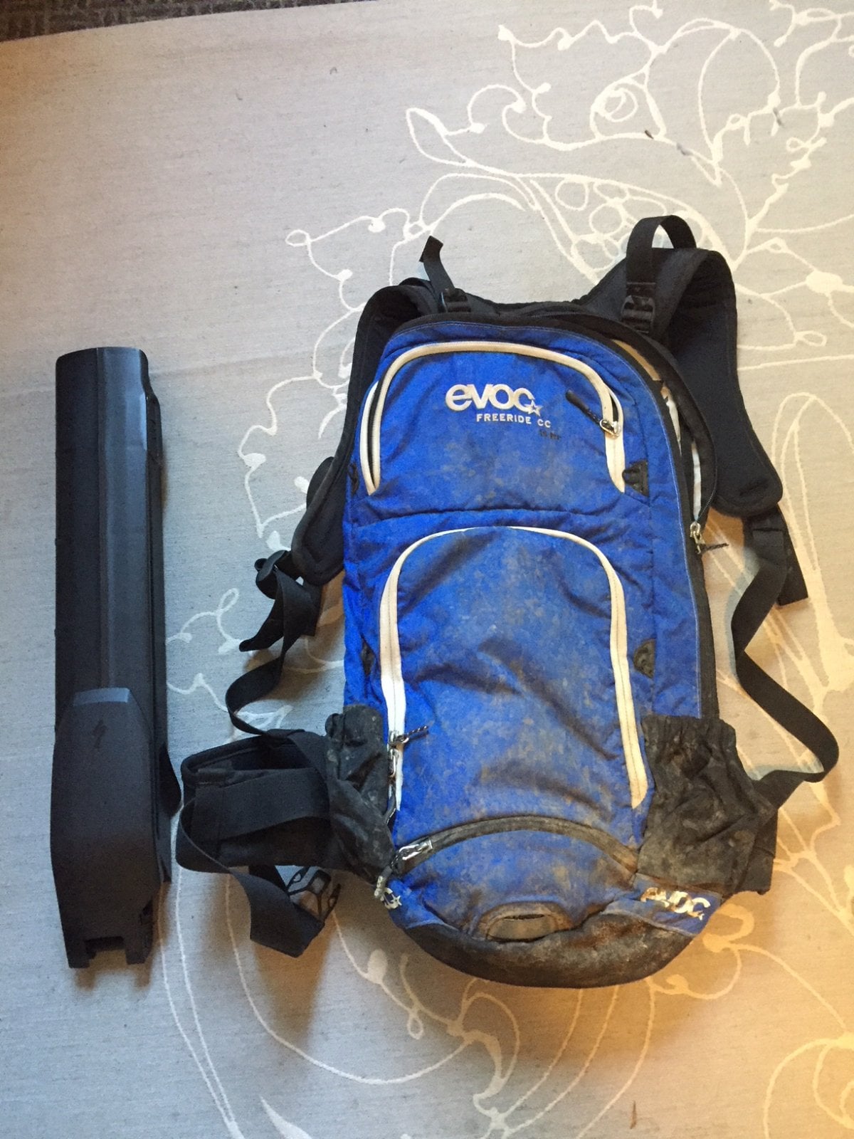

I use an Evoc bag with the back protector.
I don't use a bladder; I found it too heavy with both.
I put a jacket either side, which stops the battery moving around.
This is what I wanted to hear! So you can actually fit one in there ... Good news!

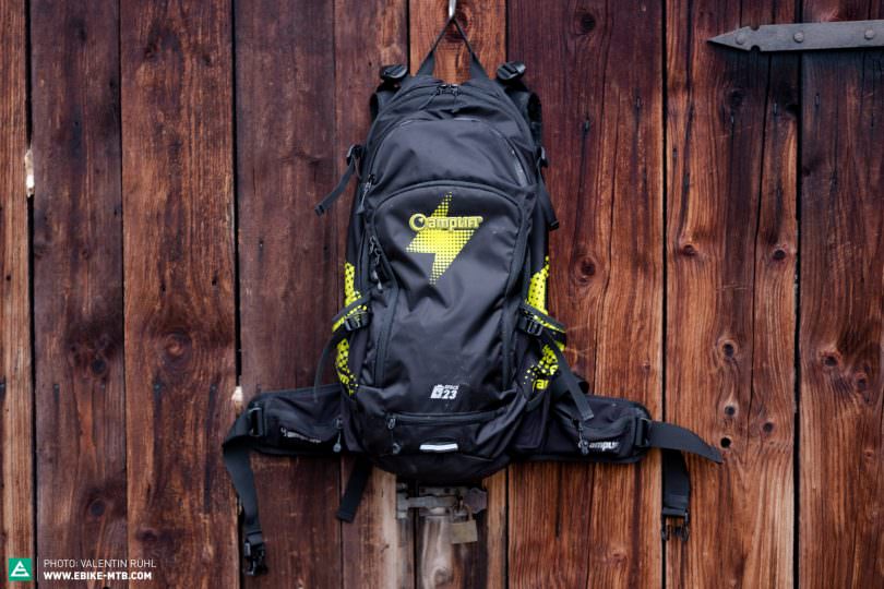

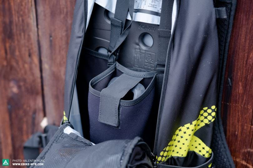

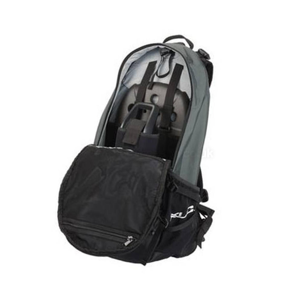

Several manufacturers have specific hydration packs in their range. All come with back protectors
Ideally suited to bosch size battery with a padded compartment
With a bit of tweaking some of the longer ones would work
The spesh battery is 535mm long
The Amplifi one below is 56cm long RRP 200euro
Evoc do one for 180 euro
Not sure about the lenght though

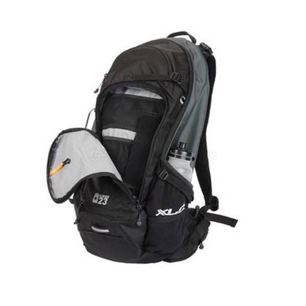

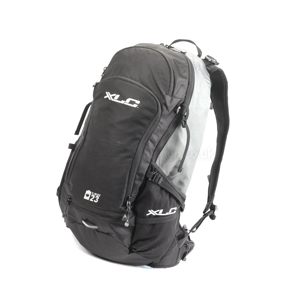

Ive just ordered this one from XLC
rrp of 150 euro found it for 89 GBP including back protector and postage
59cm long so should work
I'll post a review when it turns up

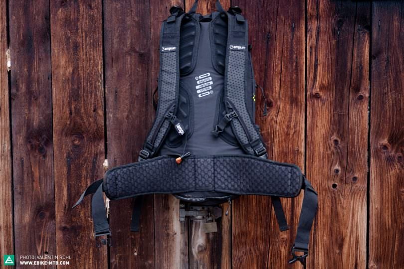

View attachment 1562 View attachment 1563 View attachment 1564
View attachment 1568 View attachment 1569 View attachment 1570

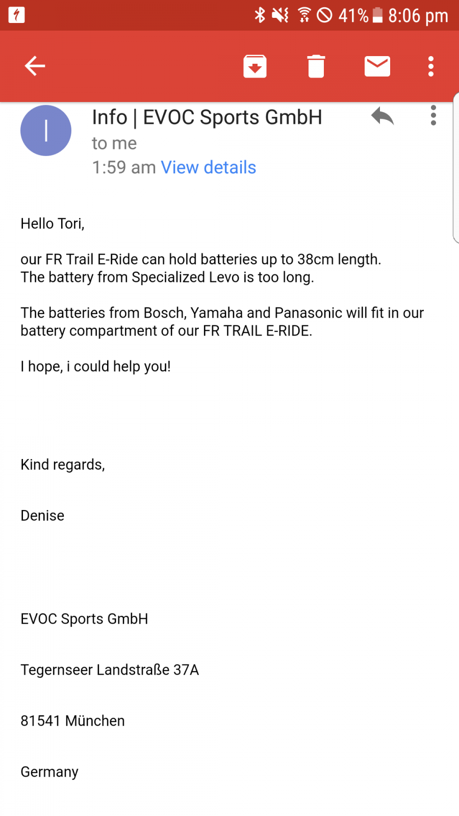

I got a reply from EVOC today. Apparently the Specialized battery won't fit in this bag:

Magazine | E-MOUNTAINBIKE Magazine have a review of battery backpacks. You need to install an app to read them though.
Thanks for the heads up. I just read the article, it was quite helpful. I know the official response from EVOC was that the Levo battery wouldn't fit in their bag . . . but the E-MTB Magazine review indicates it in fact does, just that the back protector isn't quite long enough. I have a bunch of back-protectors here from various moto jackets etc, and I could possibly transplant one into the EVOC.

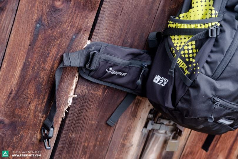

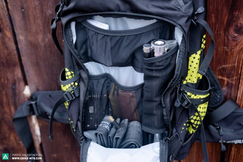

E mountain bike magazine, issue 13, have done a review of eMTB specific backpacks. The one that will take a long Levo battery is the Amplifi - E track 23. 200 euros on Aamazon. but its a seriously good bag by the review.

I have bought myself the amplifi.
Battery compartment is bit to wide but works good.
Not much space left at the top, zipper can be closed without problem.
It’s a big backpack!
I use it for the longer day trips.
With the spare battery and extra hydration heavy, the comfort is still good, plenty of adjustments available.
Grtzzz
Hi Stur :) Have you gotten the XLC yet? And if you have, how is it for carrying an extra battery? Do let us know yeah..cheers mate.
Didn't get it in the end. Supplier let me down twice . Eventually gave me my money back
Bought an Amplifi E23 instead
Bit pricey at €200 but it is top quality
Inc back protector but no hydration kit
Easily accommodates a Spesh 17/18 battery
