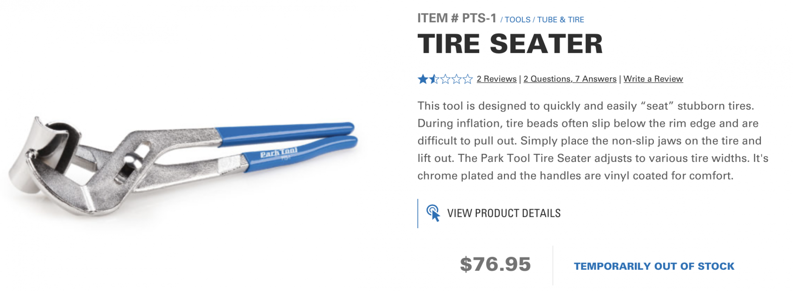

Ya gotta luv "Park Tools" $77 (plus tax) and probably shipping too . . for what is basically just a pair of Channel Lock pliers 🙀 . . . Gotta luv Capitialism! Maybe I'll just take Viagra and hope it firms up my thumbs too enough to break the beads😆. And they can't even keep them in stock as they must be flying out zee door.

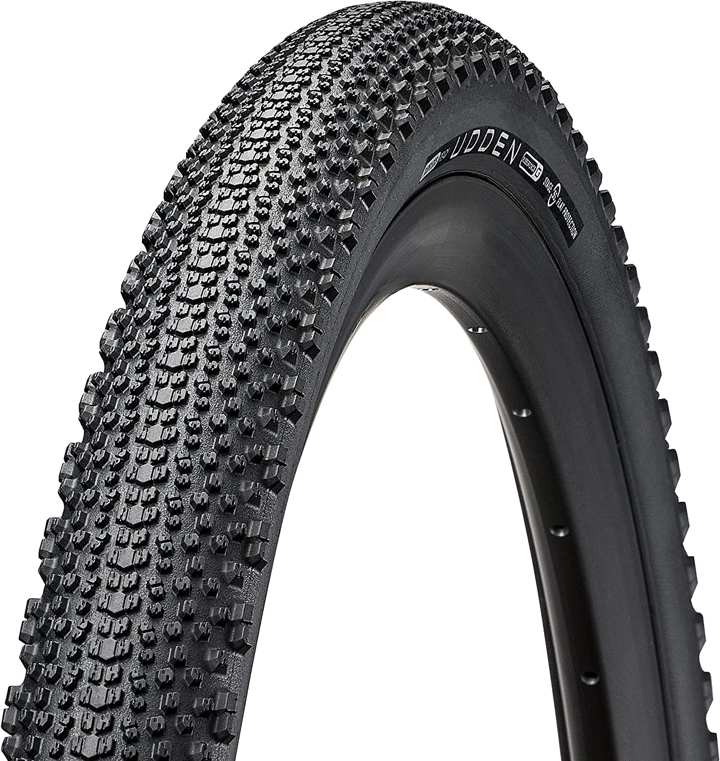

Peaky, you make a good point on going tubeless! The workmate thing still would not work for me for swapping or changing tires. But going tubeless may not solve my issue as I'd have to get the tire off anyway to put in a spare tube with a larger puncture out on a trail. Out the trail "I'm screwed" if I can't get the tire off to patch or put a tube in. The issue looks to me (Besides my weak grip) is at least with the tires they are taking off: Bontrager LT4 Expert Reflective E-bike Tire. 29 x 2.4 . . . the side walls are so thin and balloon like. With no firmness to the material there is nothing to grip. Even rolling the bike into the LBS with the front tire delated
Maybe the new one's I'm having the LBS install will have a little beefier sidewall?
AMERICAN CLASSIC Gravel Bike Tire, Udden Tubeless Ready Bicycle Tire, 700 x 50C, Hard Packed Dirt $45.00.
I don't even know if I'll like these new gravel style tires. My goal is more of a hybrid tire than what the bike came with. I'm looking for lower rolling resistance for like a 20 mile bike trail which is 40 miles round trip. I was planning on swapping back to the OEM more aggressive tires for rides with more aggressive terrain.
If I like these gravel tires I might even buy a 2nd OEM wheel set. I already have a Park Tool stand and the through axle hub design would make the swap quick for those times of single track and light MTB'ing trips with my son.
But your point is well taken. The LBS said they would not get to my tires for 2 days, so I can call him when their shop opens and go tubeless as the rims and both sets of tires are already tubeless ready. I do like the idea of the liquid sloshing around and sealing small punctures (less trailside repairs) as I'm doing around 225 miles a month.
Sorry for the long post, but there are many facets to what I'm trying to accomplish. First pic is the OEM tread and 2nd is the new gravel style tread.
