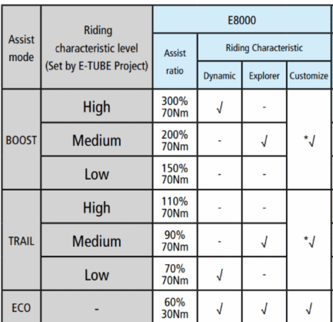

I've been riding a E8000 based emtb for the last few years and am thinking of getting a new bike. Ideally I'd like one of the new lighter bikes, but don't really want to have less power than I have at the moment (probably a common request!)
The graph below I got from this article - e-MTB and STEPS Riding Characteristic assist levels explained | BetterShifting.com
I've got both my Boost and Trail modes set to Medium, so I'm getting 200% and 90% Assist Ratio respectively. But what does this actually mean in the real world? 200%, 90% of what exactly?
And how would the current crop of lighter bikes (eg the 60NM EP8 RS in the Orbea Rise with Boost set to Max) compare in feel on the trail to my current setup - considering that I'm not using the 'High' setting in Boost, so theoretically not using the maximum assist that the motor could give.

But putting aside test rides, I'd still like to understand what that graph is trying to tell me. I could read it as I'm only using 2/3 of the assistance available to me (200% rather than 300%), but without knowing what Assist Ration actually means in the real world, I'm not sure what to make of it.

@mxh emtb motors are rated at 250Watts of power. In fact, "rated" is the wrong word, "restricted" would be more accurate! That restriction is a requirement in order to get the ebike to be still considered a pedal bike and not require tax, registration and insurance like mopeds, scooters and motorbikes do. But there is a loophole! I have no idea whether the loophole was engineered in there by some clever bureaucrat or just an oversight. It's all to do with how the 250W is measured. I am happy to be corrected but I'm fairly sure It is the average rating over two hours. That allows the motor to deliver multiple times that rating, but for a proportionately shorter time. So, a motor with a 500W-hr battery will be able to deliver a steady 250W for 2 hours, but 500w for only one hour.
Therefore, in answer to your question of "200%, 90% of what exactly?" It will be 500W and 225W.
The motor's clever software will use that power to deliver useful torque to you, which is affected by your cadence and what effort you are putting in. Different brand and model motors have different software and each in turn can be modified by the user to different extents (before hacking). That is why it is worth checking out bikes that have different motors before you make a buying decision.
OK, thanks - that makes sense.
So does that mean that, for example, my 200%, 70NM setting (which you've clarified means 500W) can't be compared to similar figures from a different motor to make any meaningful comparison?

Well, that is not how it works.
The percentage rating means the amplification of your own input. So if it is set for example at 200%, and you apply a force of lets say 30Nm on the cranks, the motor will output 60Nm. If it is set at 90% and you apply 30Nm, the motor will output 27Nm.
But then there is also the limit of the motor. For example if it is set at 30Nm (like in ECO) then the motor will never output more than 30Nm, no matter how hard you pedal.
Likewise, the motor can never output more than its maximum rating (70Nm for the E8000 in this case).
Power is a different number and also takes in consideration at what cadence you are pedaling (its a function of RPM and torque). Its not really something we are too concerned with generally (though maybe we should). That 250W rating is just a lie to conform to regulations. Somehow that is supposed to be an average maximum that the motor could output. But in reality all motors will output way more than that, and will happily do so until the entire battery is drained. Shimano and Bosch are at ~500 to ~600W max, Dyname goes up to 750W, and Bafang goes even higher.
Now, in the real world the numbers arent that precise. Motors dont really have flat torque responses, they are usually curved. So that 70Nm might be achievable at a certain RPM, but not at others. Also, the amplification % isnt exactly linear either. At all depends on how the torque is sensed at the pedals, what support curve the designer has implemented etc... Every motor is different in this regard.
We use those simple torque and % numbers to make it easier to understand and compare. But just know that the reality is a little more complex than that.

@mxh
The assist percentages are not percentages of the nominal 250w, they are percentages of what you are putting into the pedals, as per post from s13 above.
ie if you have the assist set to 200%, and you are putting in 100watts, then the motor will output 200watts, so you and the motor combined will be propelling the bike with 300watts in total. This is subject to a power ceiling which is either specific to the mode you are in, or the EU nominal 250w limit (which doesnt mean the limit is 250w, but I have no idea how this nominal power is actually arrived at,I think its an average over 30 minutes of something like that) , or other limits within the motor - maybe lower limits will apply at certain motor temperatures for example, then there is the speed based limit where motor power is capped at 0watts regardless of what you put in etc etc

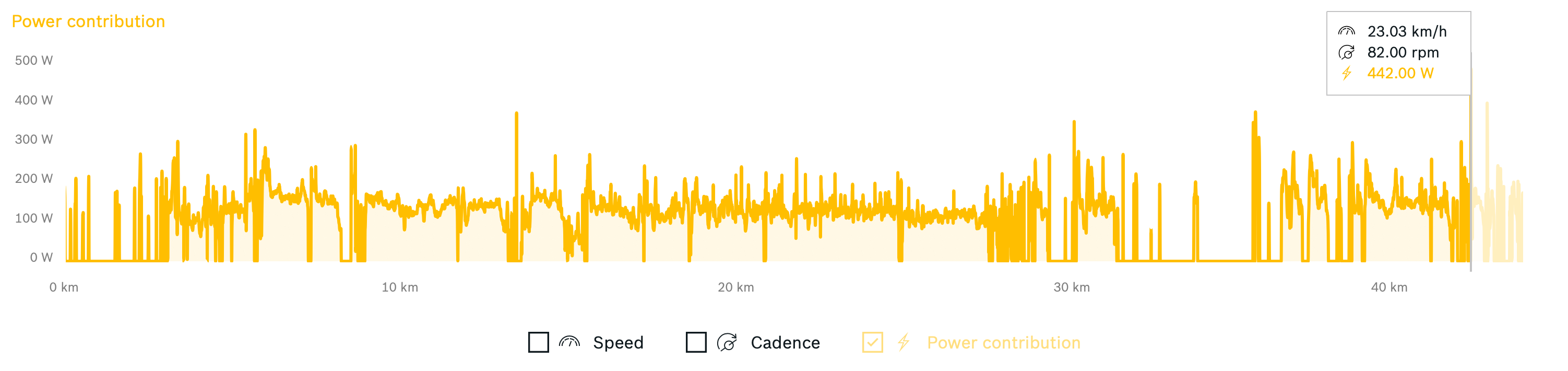

This explain a lot of things. I found a lot of peaks of power in the record of my Bosch CX motor well above 250 W. Thanks! I wasn't aware about that.
However, it is still not clear to me how the motor complain with the 250 W rule...

Theoretically yes. In practice, no.
Im not sure how emtb manufacturers are getting away with this. But hey, you dont hear me complaining...
I agree that we should not create a fuss about this. I am still uncertain as to whether the loophole was by accident or design. I would like to think that some clever EU bike riding bureaucrat pulled the wool over the eyes of his fellow legislators. Maybe he had been briefed by one of the bike lobbyists. Stealthy steps, grandma is sleeping! :D

but did someone ever found a continuous power record above 250 W? Or just peaks (like in my previous screenshot, but I am not very fit...).
If this is not the case, it could just be a limitation of the motor management system that try to instantly respond to a sudden high demand of torque and overshoot for a second.

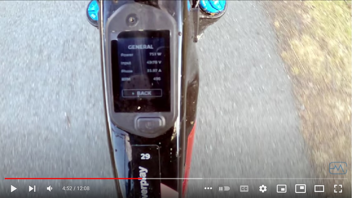

oh yes. The dyname motor actually shows the output power, and it actually does consume 750W almost continuously on the highest power setting:
Source:
And it seems to make sense. With my previous E8000 i was able to ride a 500Wh battery flat in 1 hour, meaning i was consuming 500W on average.

but this is sold on the US market, not EU, isn't it? Sorry to look picky but I really want to understand...
No this is sold on the EU market as well. In fact i bought one, and there is a whole network of distributors and shops that sell it in the EU.

Another example would be the brose. It pulls 20amps from the battery. So at 36v (will be slightly higher when fully charged) then 20*36 is 720w - that's power drawn, not power produced, which is about 80% of that.
There is a good thread somewhere which explains in detail how the 250w is tested and complied to - they do comply. It isn't a max. I'll try and find it later.
