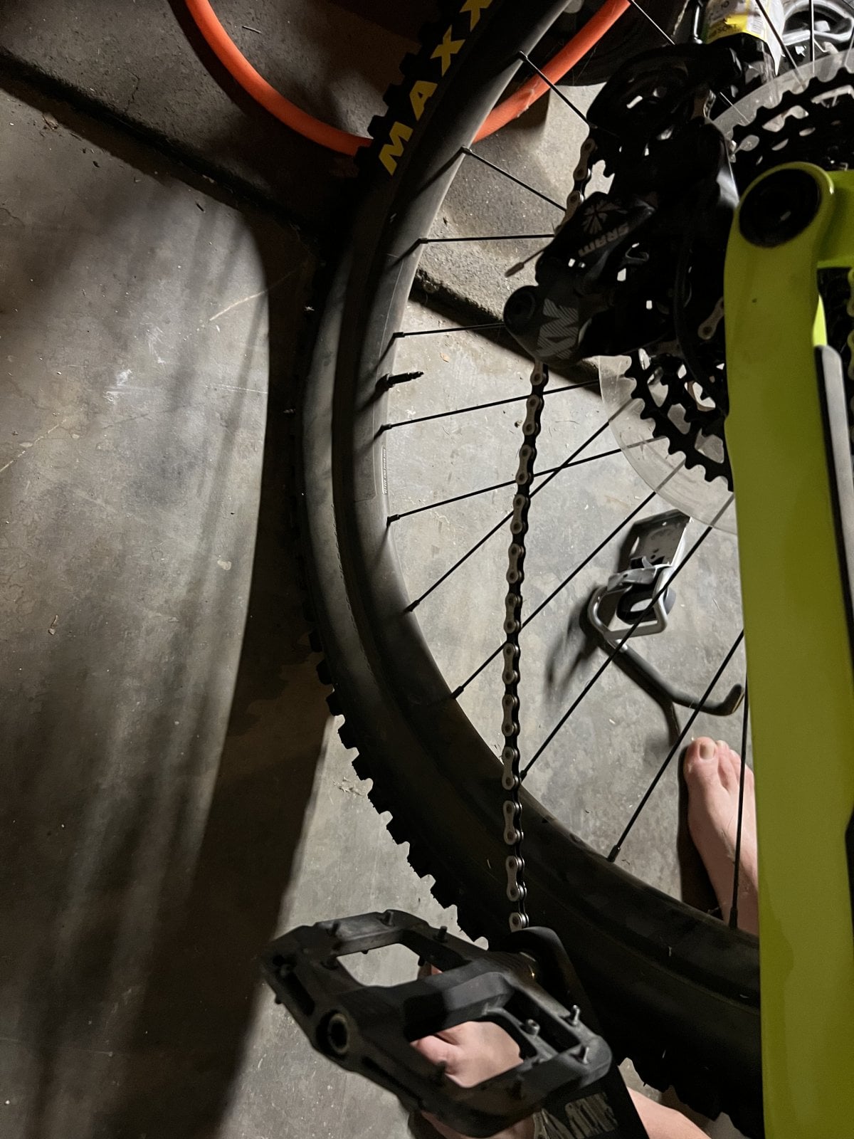

I have a Rail 9.7, had a good get off bent the bars broke the stock Sram Nx Shifter, bought a GX Shifter and got it mounted up. Went for test drive down my street made it 2 min. Then the chain snapped, after looking at it chain had like 4 more cracks in it just waiting to go. How many links are on the chain stock? I fitted a new chain and it’s not working correct skipping a little or feels like it’s catching. I just measured the other chain to the broke chain by laying them out, but I was told I probably did it wrong then. The sram power link is mounted and all the way in also. So now I’m leaning toward wrong chain length or bent derailier bike has 190 miles on it

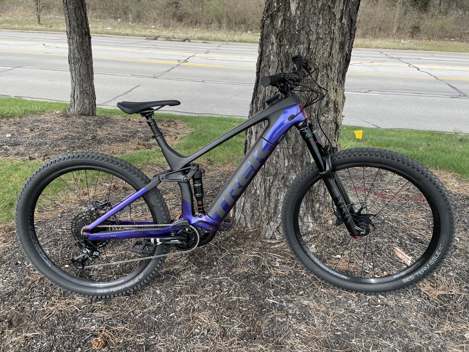

My 2021 Trek Rail 9.7 size XL: stock chain is 118 links including the master link.....

This problem is often caused by the chain having too many links. If your chain is too long the chain wrap will be decreased and can skip. The last time I changed my chain and it skipped I had my son look at it who is a very experienced bike mechanic. He could tell by the position of the derailleur that my chain was too long and advised taking out two links. Bingo, no more skipping.

This problem is often caused by the chain having to many links. If your chain is too long the chain wrap will be decreased and can skip. The last time I changed my chain and it skipped I had my son look at it who is a very experienced bike mechanic. He could tell by the position of the derailleur that my chain was too long and advised taking out two links. Bingo, no more skipping.
What I’m thinking now, I just really need to figure it out, I guess I should of counted instead of measuring against the old chain. I haven’t been riding as much as I wanted lately
You think maybe if I took a pic of how it’s looking he may be able to see if he thinks it’s the same issue?
I can only ask, put the bike in first gear and post a photo. When I got it wrong I cut the chain to the same length as the old one. It appears I had too many links from when I bought the bike.
