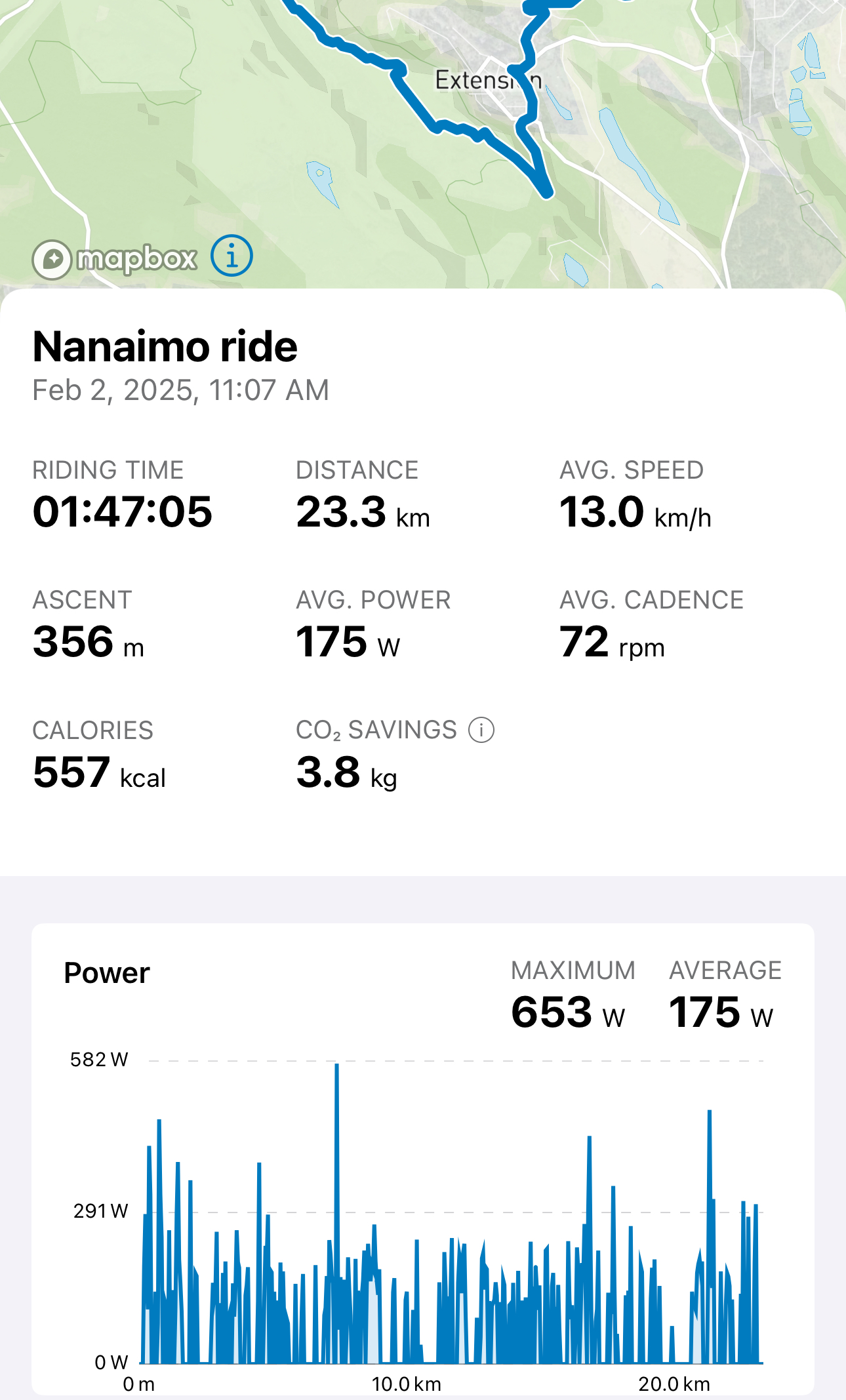

I have an EP801 and I’m lucky if I get 20kms in eco set to 63nm. I took out a demo Bosch with a 750 battery set to eMTB, equivalent to trail with and got 23kms out of it with 37% left which works out to be less than 500wh of usage, frustrating I can’t get more range out of the battery.

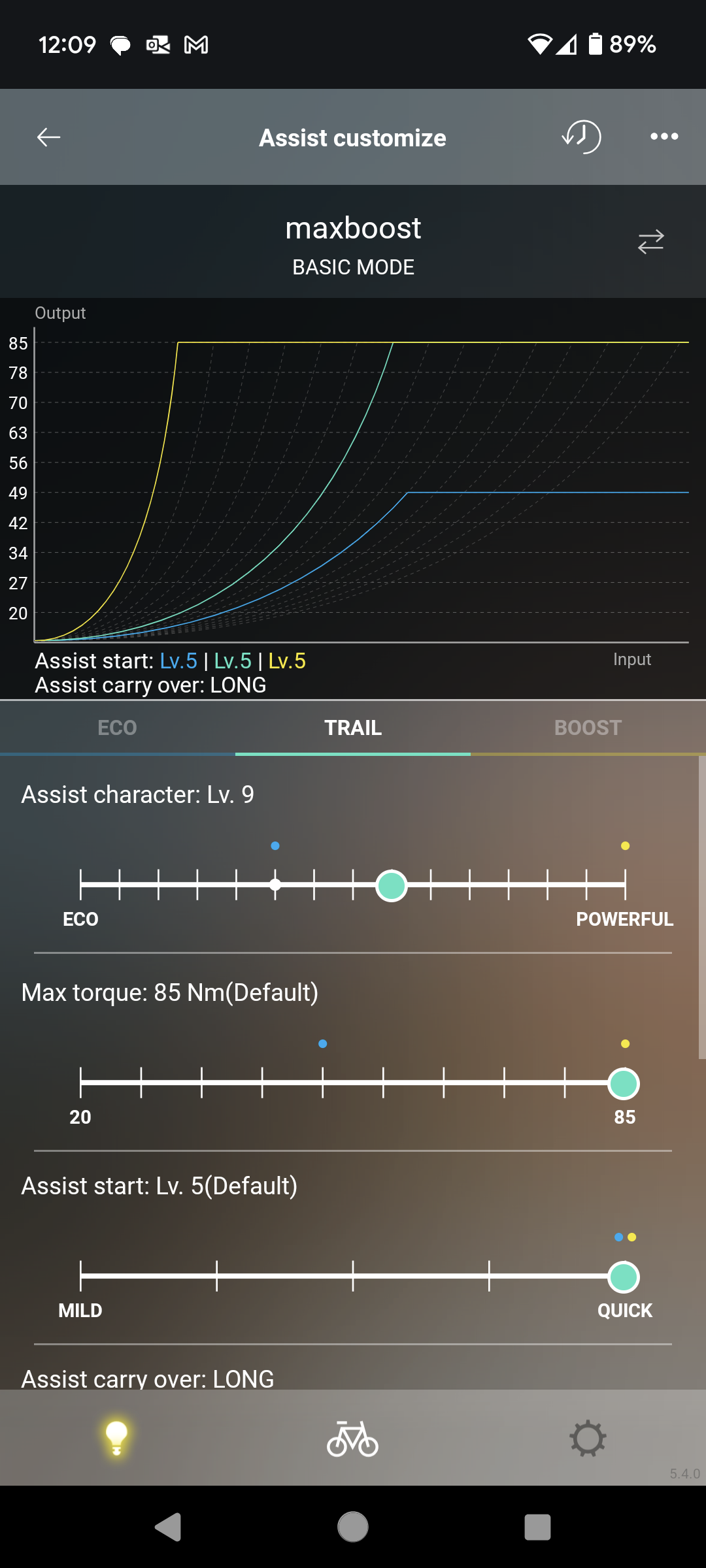

I've got an Enduro 160mm full suspension 29er with 2.5 shredda tires on it set to ~22psi. It's ~56lbs and I'm at ~185lbs. In trail mode with 85nm, start assist aggressive, assist character turned up 3 notches from factory, and carryover at max I can get ~24 miles (38.6km). I'd say something is wrong with your battery, or you're dragging an anchor behind you 😂.

Thanks for all the replies, the ride I did on the Bosch motor was the same type of ride I do on the EP801. I’m 240lbs but comparing the two bikes the EP801 is eating up more battery at a lower setting. I’m going to see if I can get a new battery but the battery test all checks out with the linkage device
