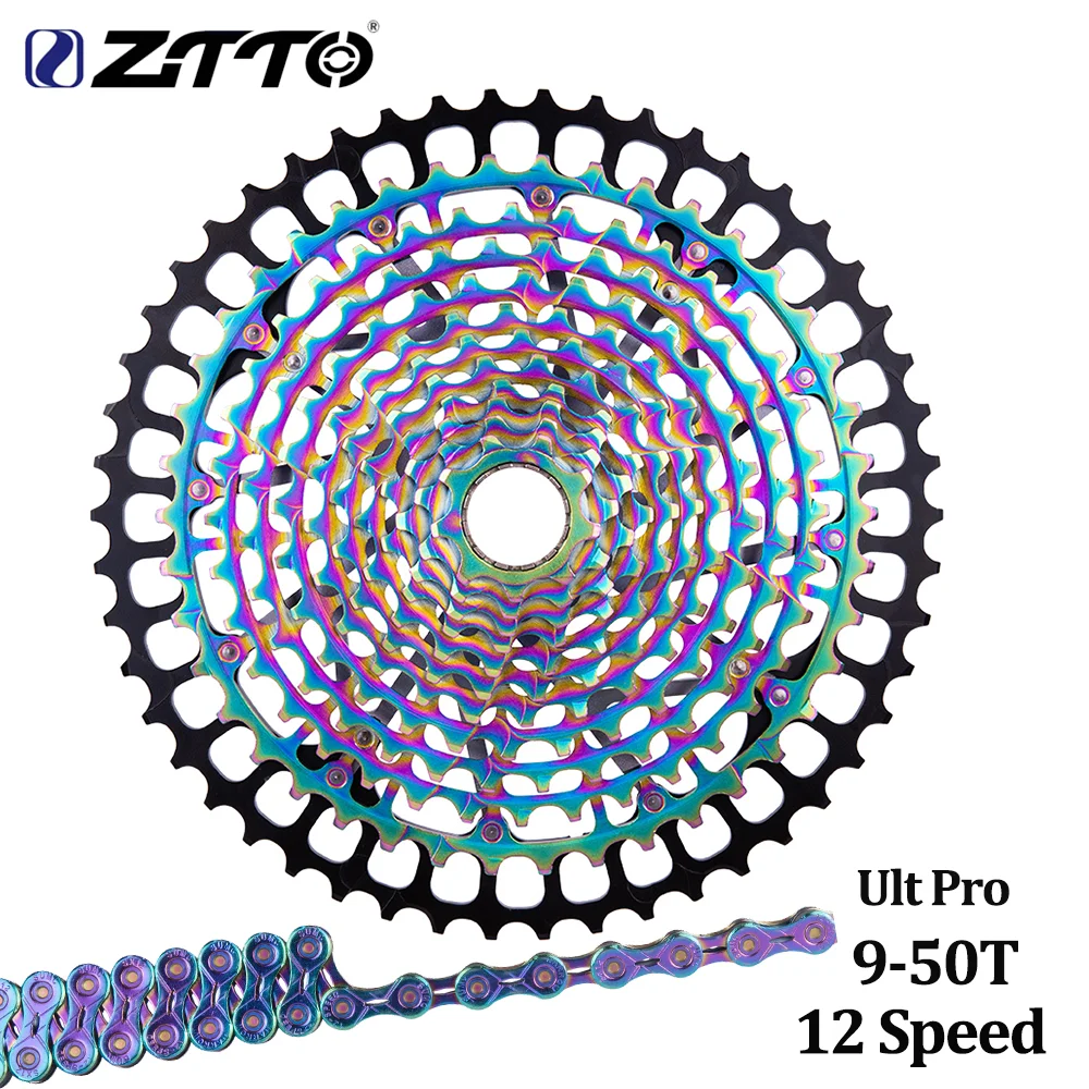

Looks like I left mine too long.
GX 12 speed middle of winter mud 950km and the chain is too stretched.
Would I destroy this cassette on a full power e bike?
Hey Roly here, fancy meeting you here. Cookie told me when I was buying my bike how he had eaten a cassette in 6 months and a replacement is $500 so I've tried to look after it by using 3 chains.
I've got 3 GX chains on Sram 12spd GX Cassette, and just about done 3000km. Probably only done 10-20% mud riding though. Only thing to report is the middle 2 gears are a bit fussy now, I guess I use them more than the others?? I rotate them every 400km and use wax, sometimes the squirt stuff but sometimes hotwax melted on with a hot air gun when I have time.
Give the chinese cassettes a go, I hear they handle an Ebike OK according to Goff, but look for the Sunrace or Sunshine ones, some are heavier and made with steel, thats the one I would go for. About $100NZ

Hey Roly,
Thats exactly what im doing. Ditching the gx and going yo sunrace. I use them on my meat bikes and get good life.
PS took me 2 months to burn the cassette. But that was a mud fest 1000km.
