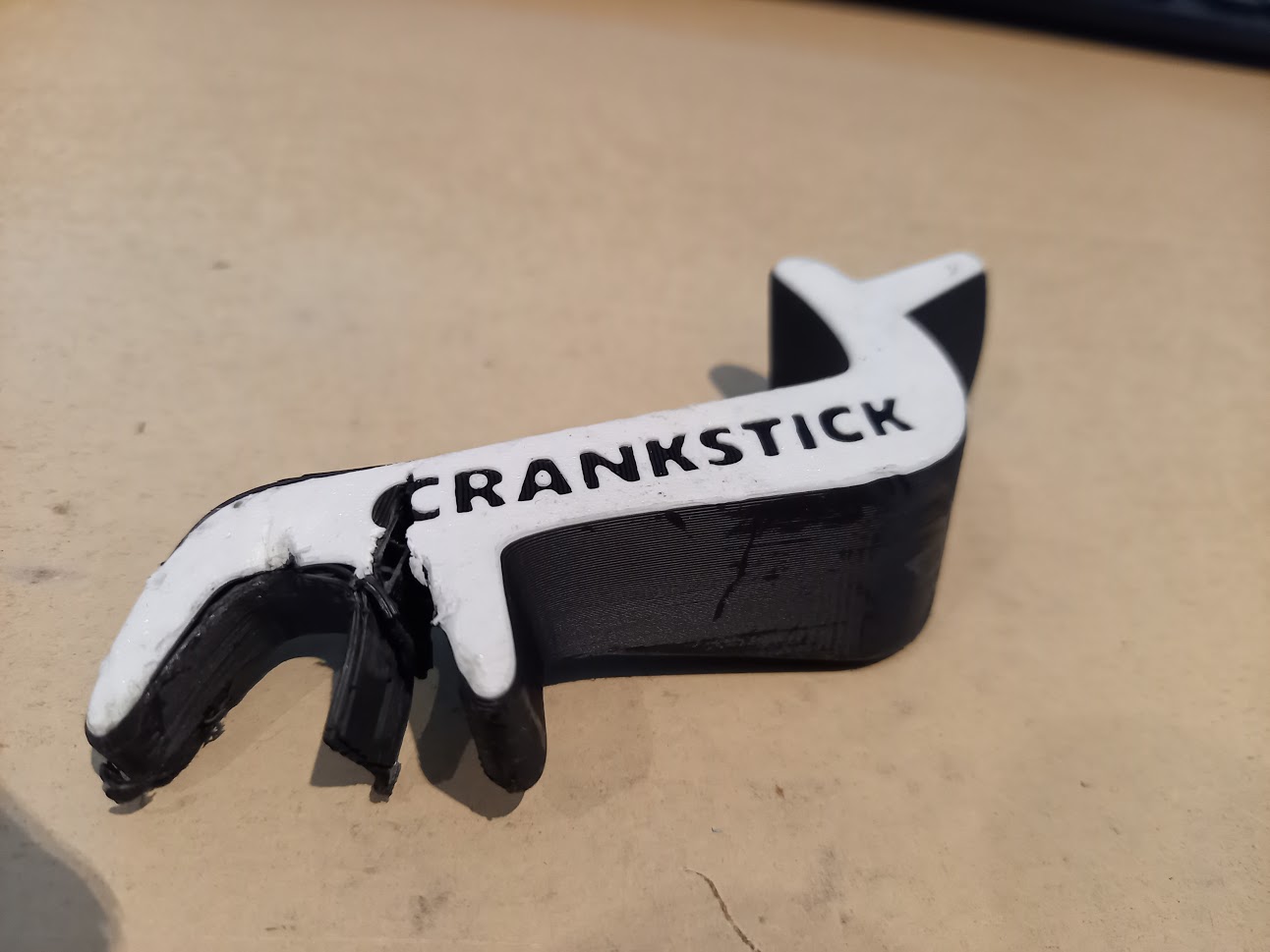

wish I'd seen this thread before I watched Rob's video
11 Cheap Products That Will Make Your Bike Life Better
I tried a crankstick, I'm not so much bothered about the lost £10, but just thinking of all the frustrated minutes wasted over the last month trying to balance the crankstick in there without jamming and snapping it, and then having a fight to get it out afterwards. also annoyed at myself for missing the fact that and a simple allen key bit does the same job ?‍♂️
Yup, I have my "special tool" too. I wrapped some electrical tape around it to (1) protect the crank and (2) identify the correct allen key quickly

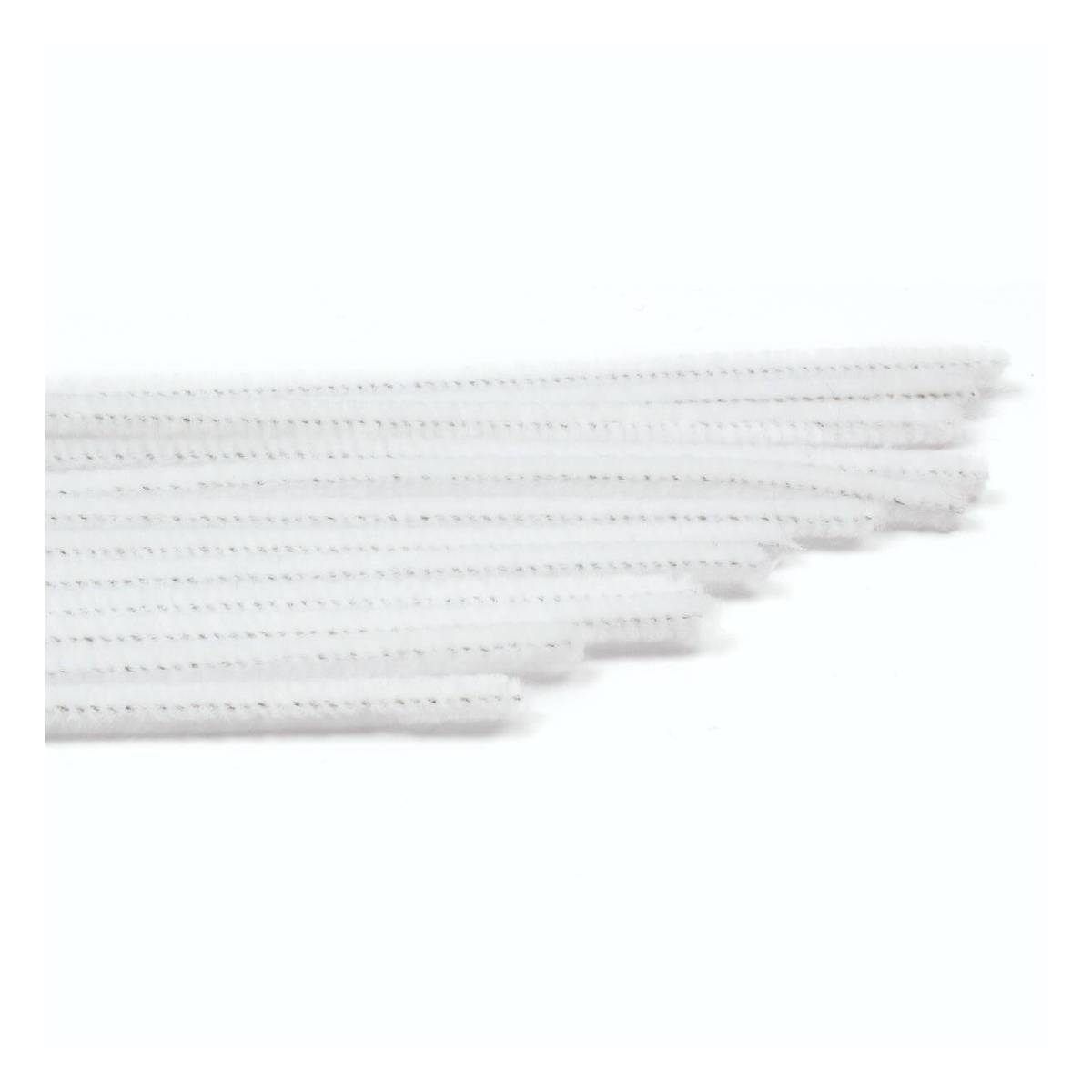

Talking about lubing, I suddenly realised there's a simple way of lubing fork seals.
Pipe cleaners. Yep, pipe cleaners. Bought a pack of 12 from Hobbycraft for £1 They're 12 inches/30cm long, so cut them in half. Dripped WPL Forkboost Lube onto the fork seals, worked it around with the pipe cleaner. Job done, such a simple and obvious way to lube fork seals. (y)
