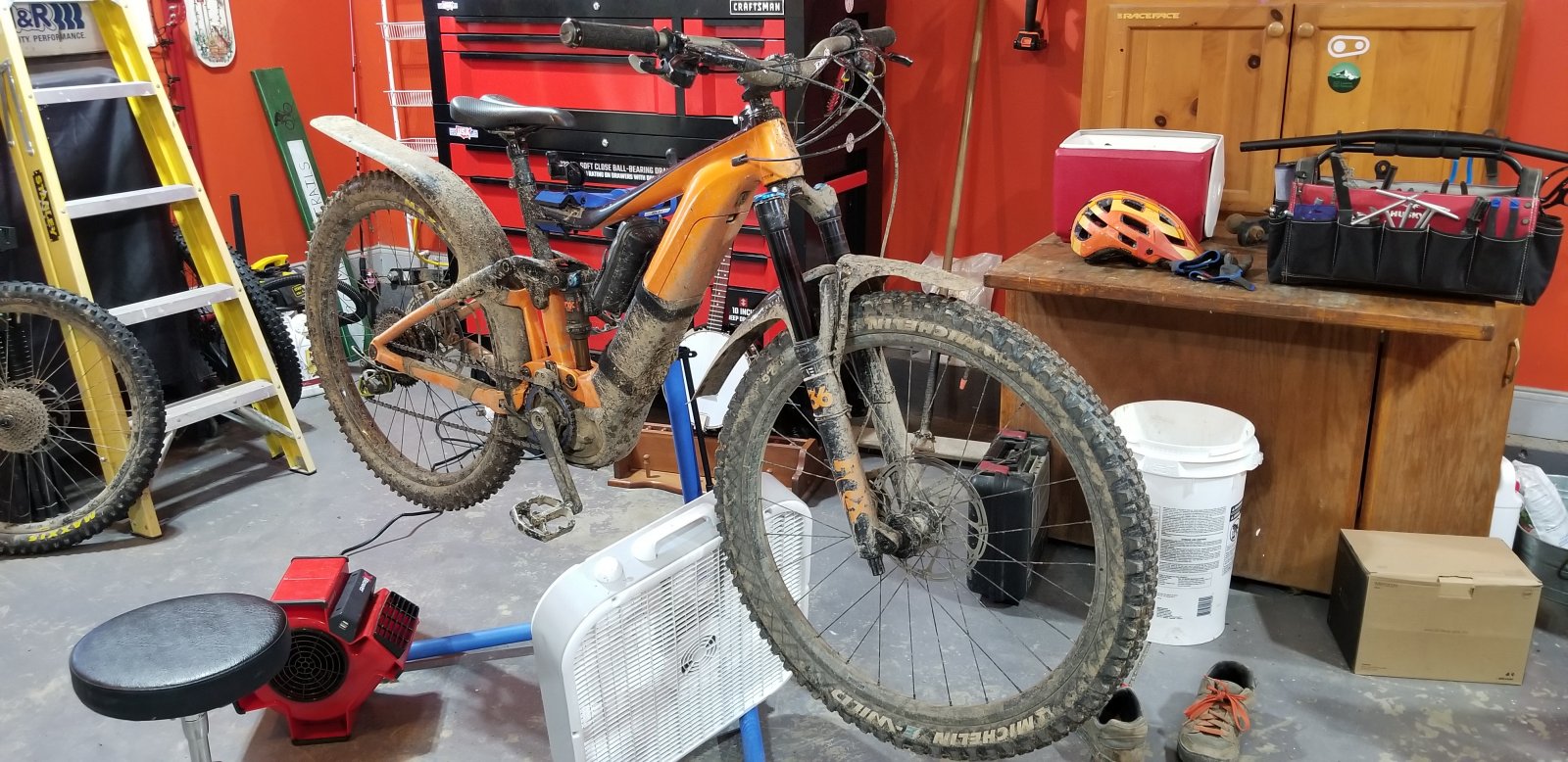

Once a year I take it to the lbs for a check and the mongrels get rid of all the trail cred.
Dont know about this trail cred stuff, but if it's at all like trail crud, I'll need to try your idea. I've been letting my fans do the work,
and so far they suck.
