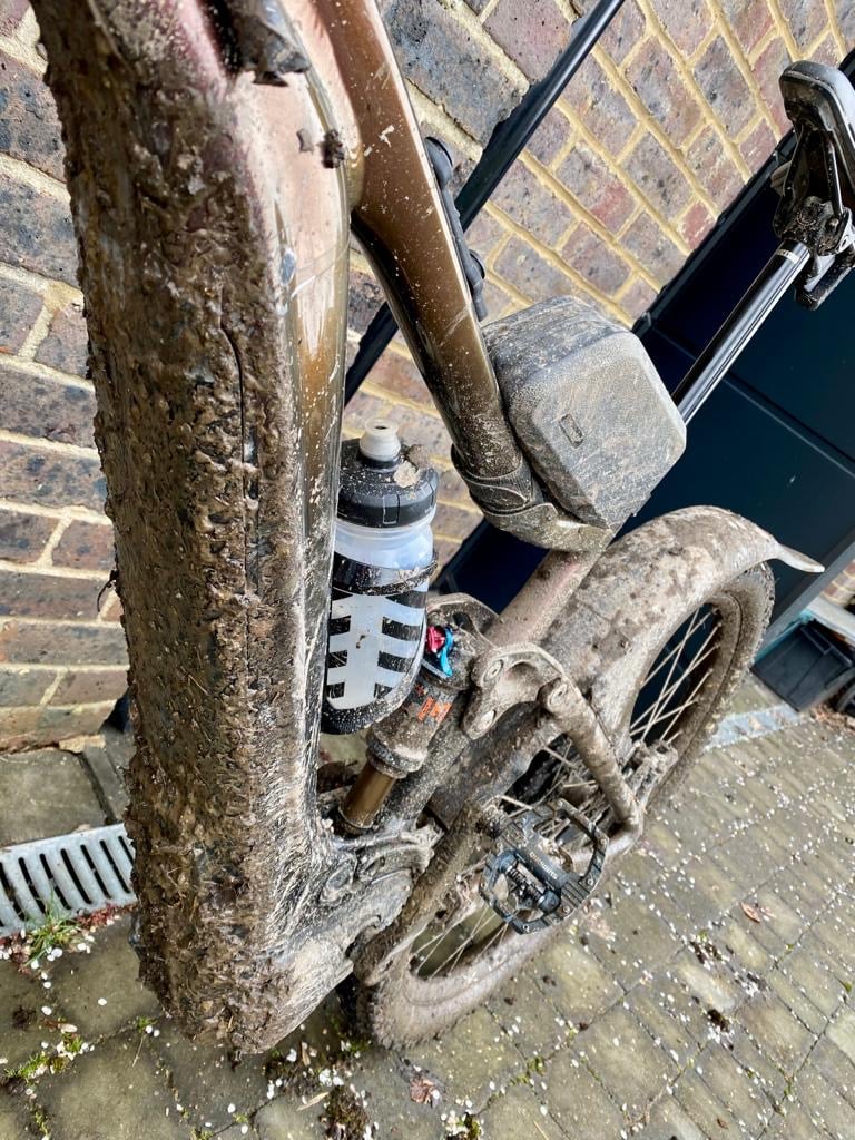

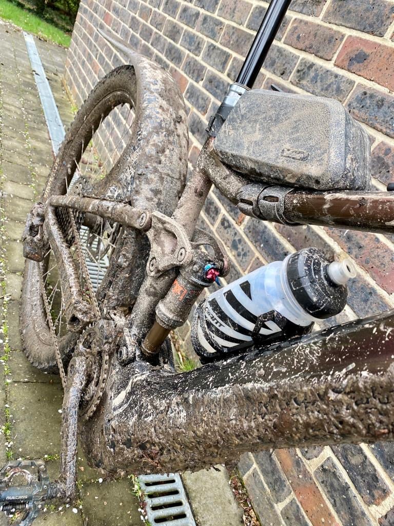

Hi, absolutely don’t be worried about getting out in the muck. I’ve done 7000k through Uk weather with zero issues. Firstly best advice is decent rear mudguard, protects your dropper and keeps you dry, I use a mudhugger for this, they are excellent. Secondly I tape over any areas that I’m likely to get water ingress from either washing or riding. On my model (21 trance) that’s the battery release catch and the hole in the frame for the torque key. Wash with hose and sponge, only area I don’t really soak is around the charging port. After washing I bounce the bike to shake off the excess then wipe over before removing the battery to check for ingress. Once I’ve done that, replace the taped areas, clean and lube the chain and it’s ready for the next mud bath 😁
Rubinstein
Apr 7, 2022
422
540
kent
Example of how effective the mudguard is for the seat and dropper

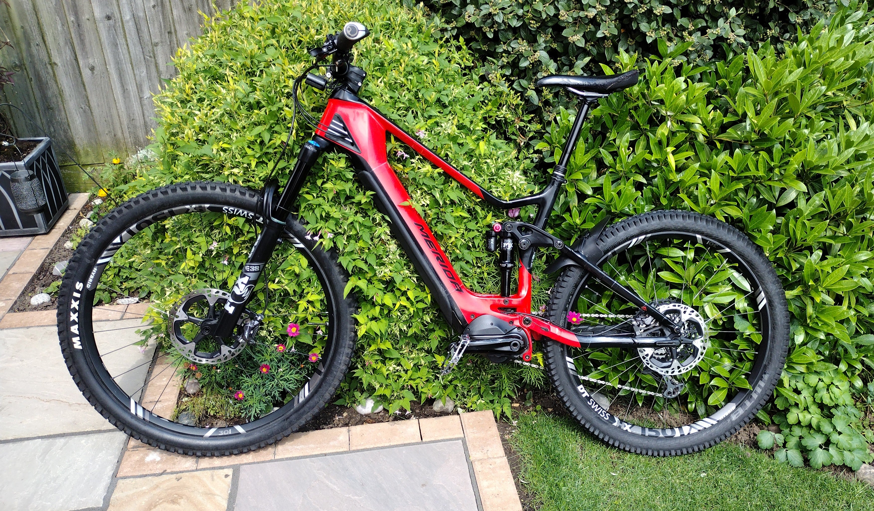

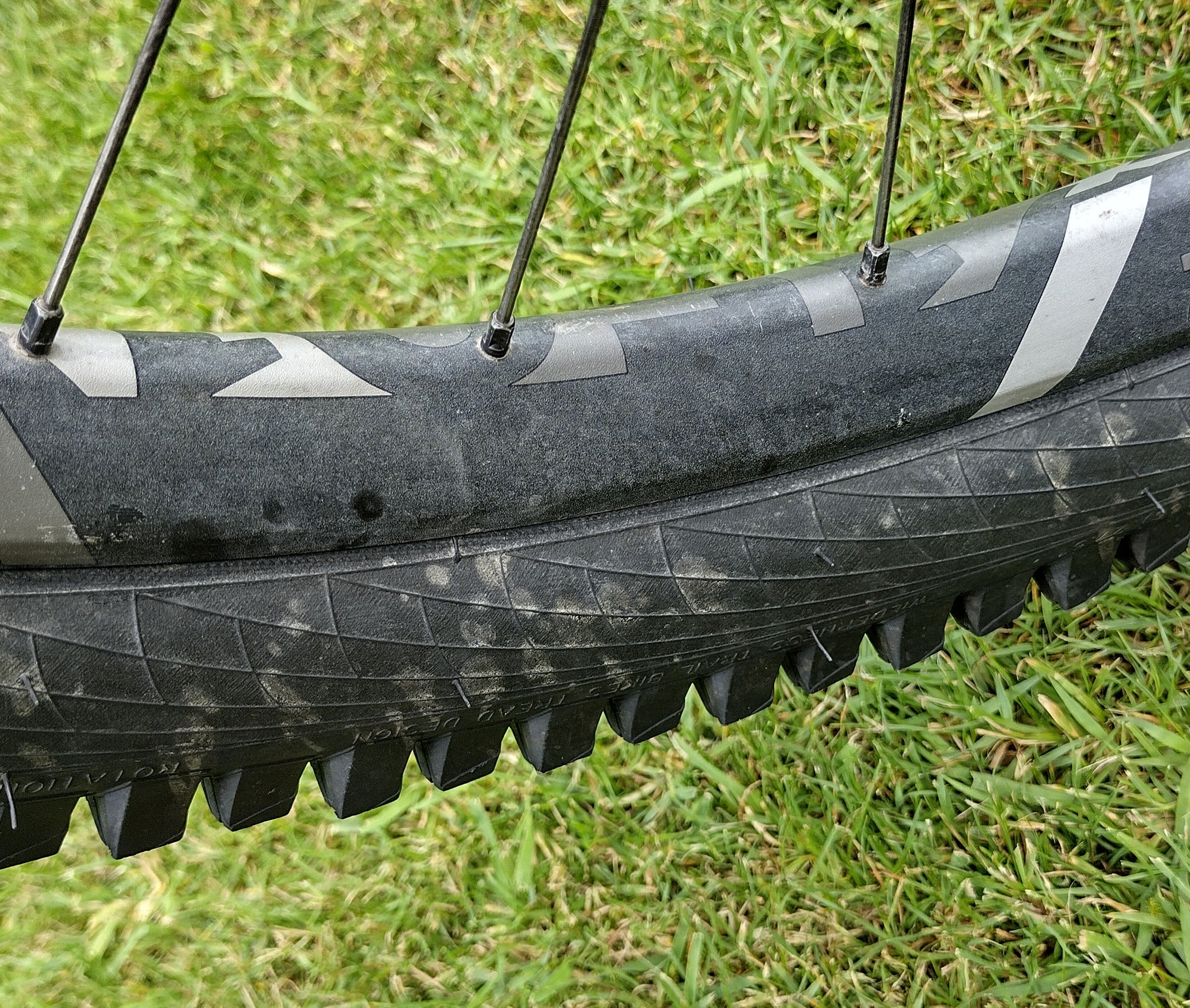

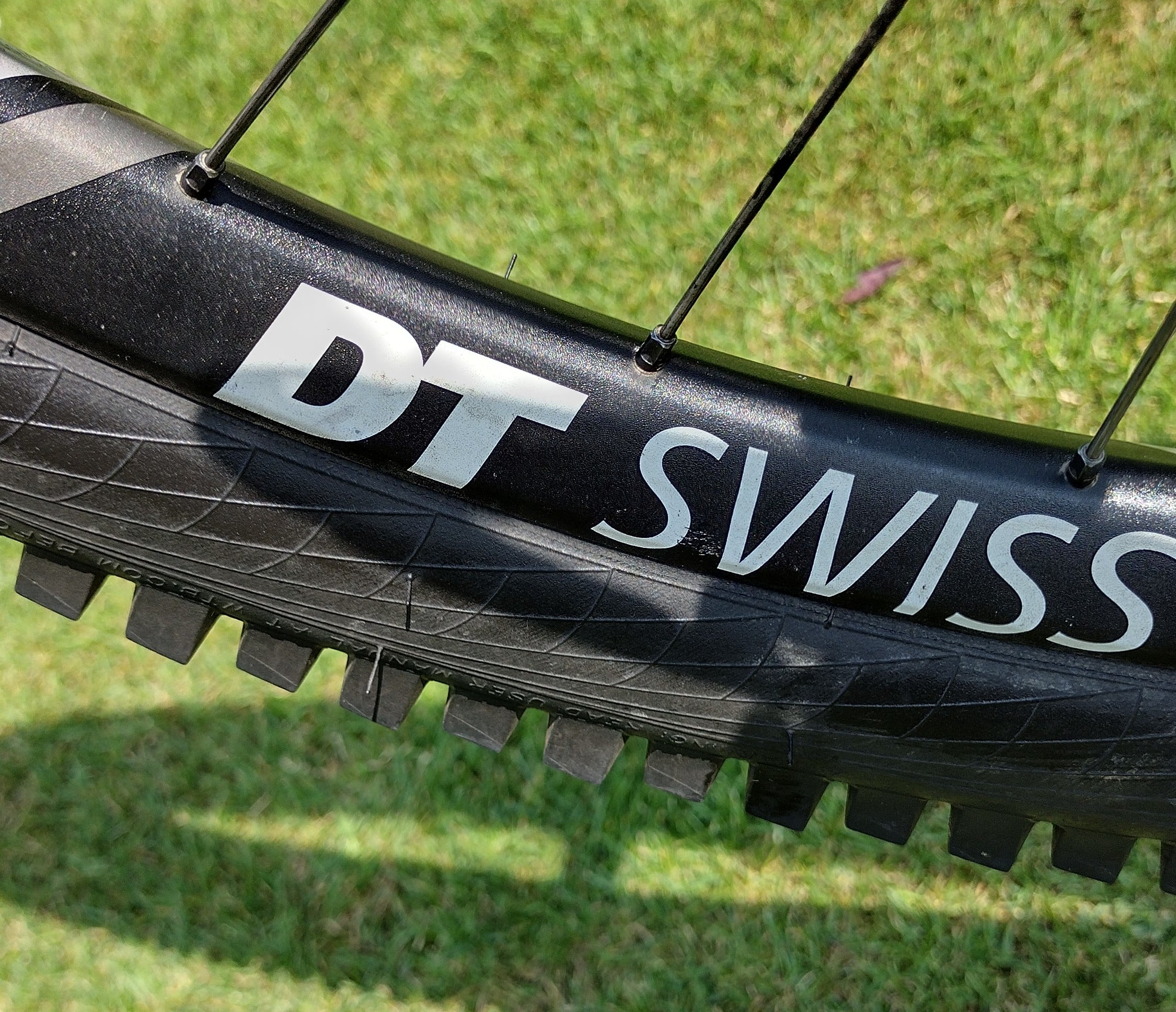

Wet the bike with water from a watering can. I use water from the rainwater butt.
Use a brush and a bucket of hot soapy water. I use cheap car wash shampoo (no wax).
I scrub the tyres with a wooden backed bristle brush.
I use Hope's Sh1t Shifter as a degreaser for the mech and ring if required.
Rinse off with the watering can.
Bounce the bike and then wipe over with an old towel.
When the summer comes, I also use "Silicon Shine" aerosol finish. Look see what it does to the rims! DO NOT get it on your discs"!!
"Before" then "After" :love:
Whole bike. (You should have seen the shit state it was in before!)

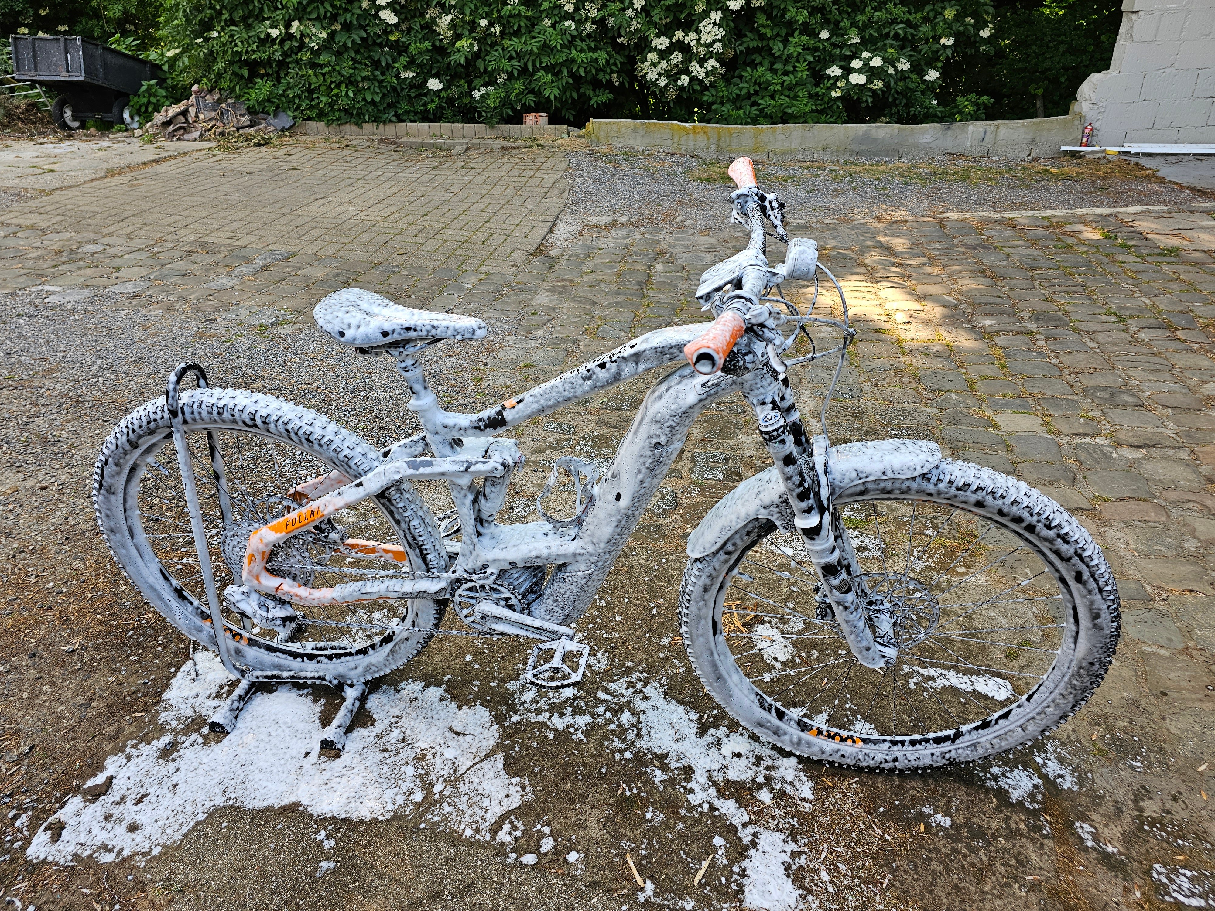

I just use a pressure washer with a foamgun.
first spray the biggest mud off,
then foam it In, let it sit for couple minutes and spray off. Bike is clean without a sponge. And I allways blow it dry with air
View attachment 127060 View attachment 127061
Looks brand new !!
