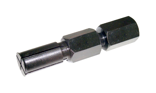

You can't press out those bearings. There is an inner lip that they sit against. You need a blind puller and slide hammer or something like
And then punch them out on their sides. It's a very tight fit and takes a lot of force to bang them out.

I have the blind puller Alexbn921 posted and used it on the bearings the OP asked about. It worked well, but you will need to buy or make a small slide hammer. I used a long bolt, a sturdy washer, and a very heavy socket. One of the perqs of working on cars for the past 50 years is that I have tons of this kind of stuff in the garage!

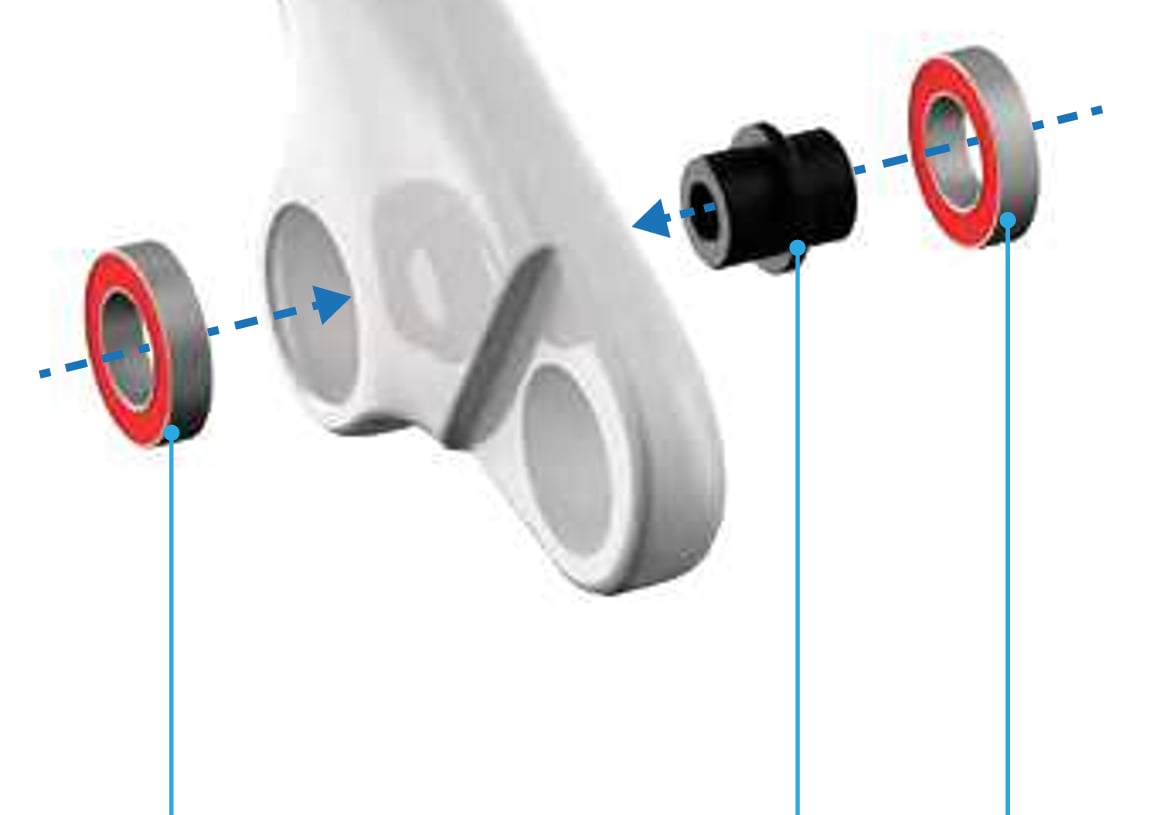

Still not sure on the process to get these out.
The inner black tube has a centre lip, so how do you get the first bearing out? That blind puller can’t fit into the bearing because of the inner black tube.

I did speak to them. Great shop and very friendly. Press out the inner sleeve which takes one bearing out with it.

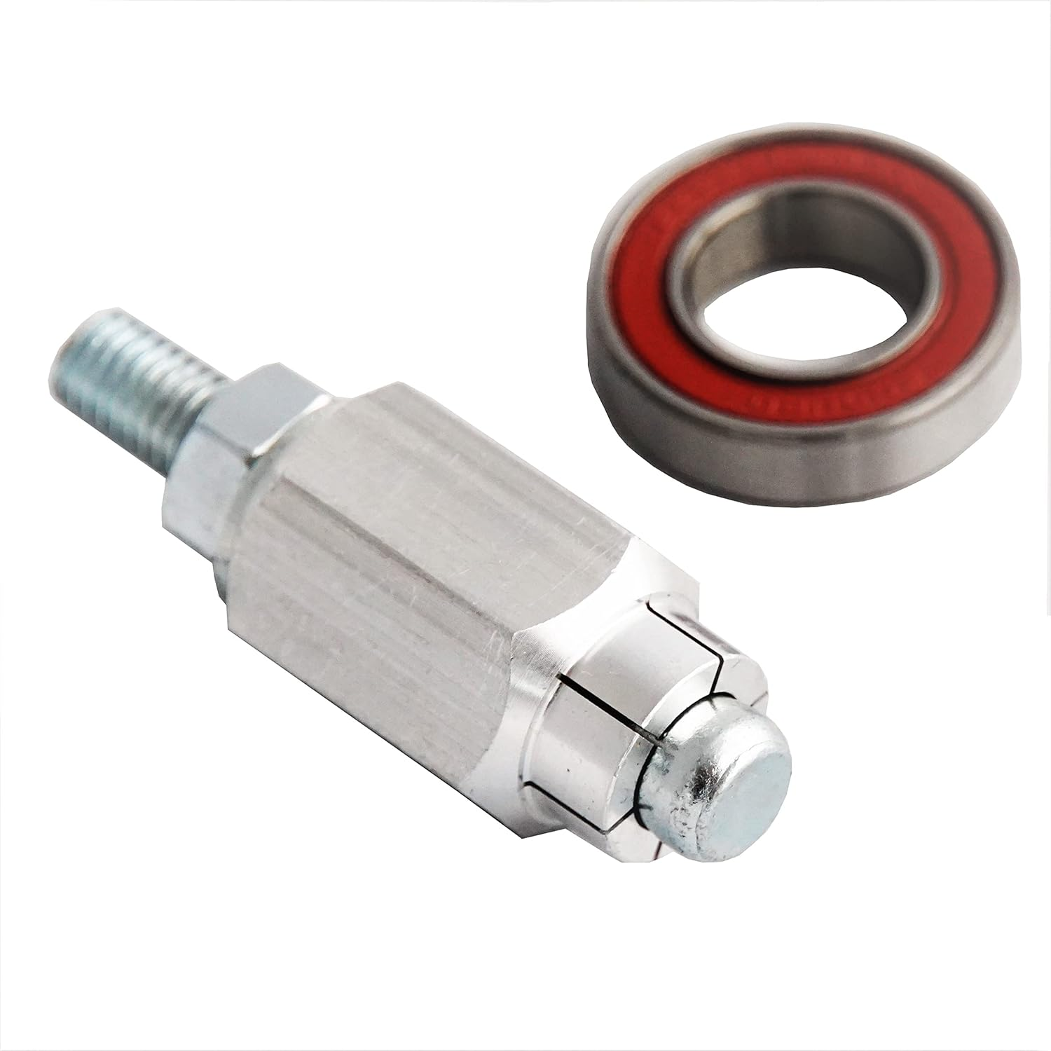

Did you use blind puller ?
was this one enough?
or the one with a lip?

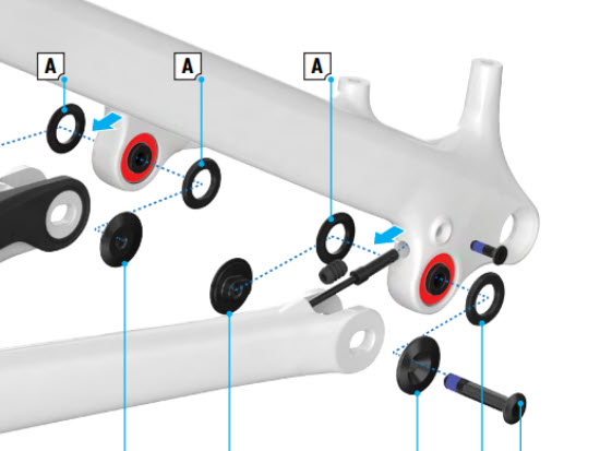

How about main pivot bearings? 6901. the same method? which tool ?
I've just done my main 6901's. Blind puller as first picture then once it's out and the sleeve is removed you can tap the other out with a bit of rod. Or use the blind puller again.

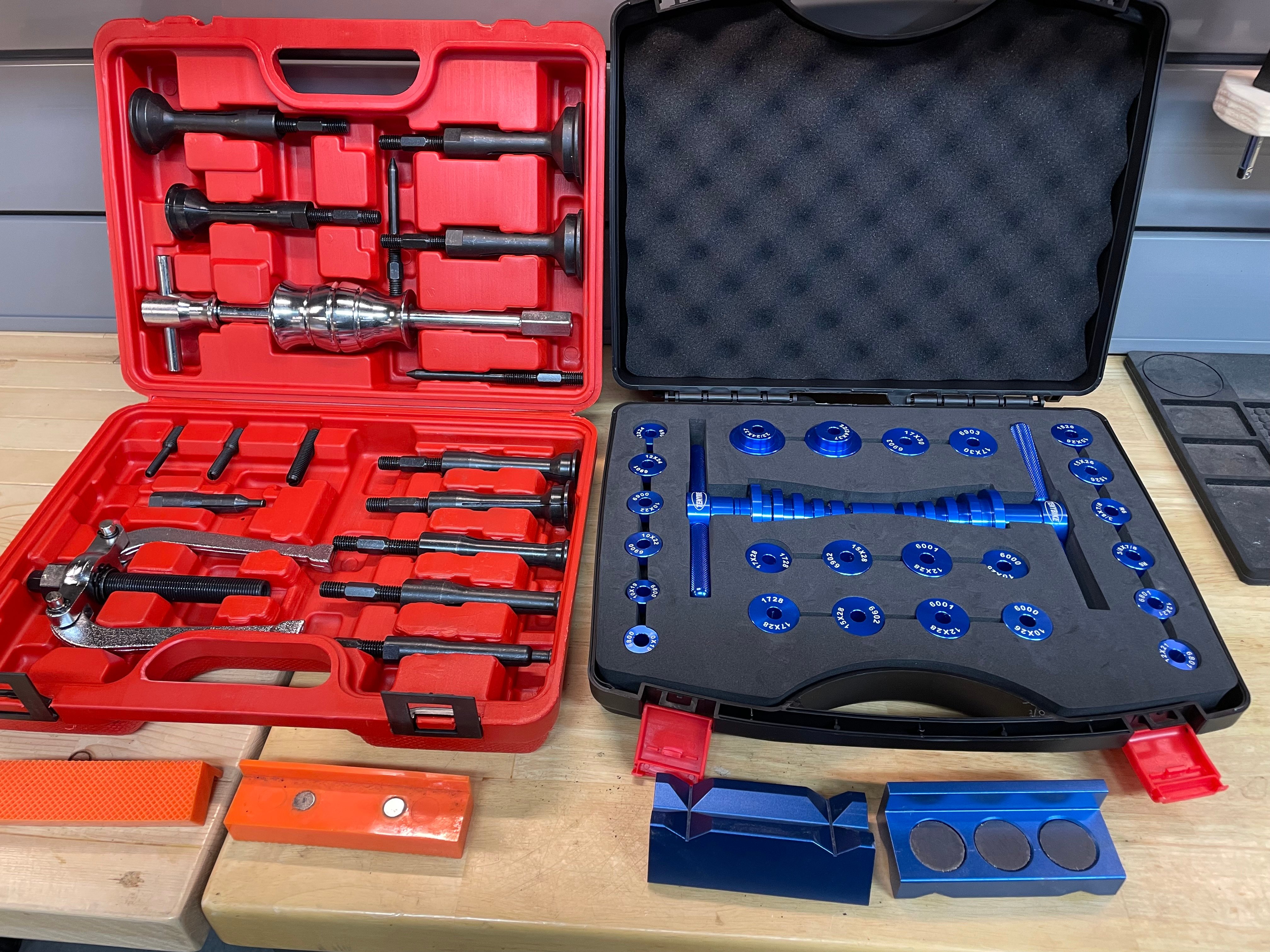

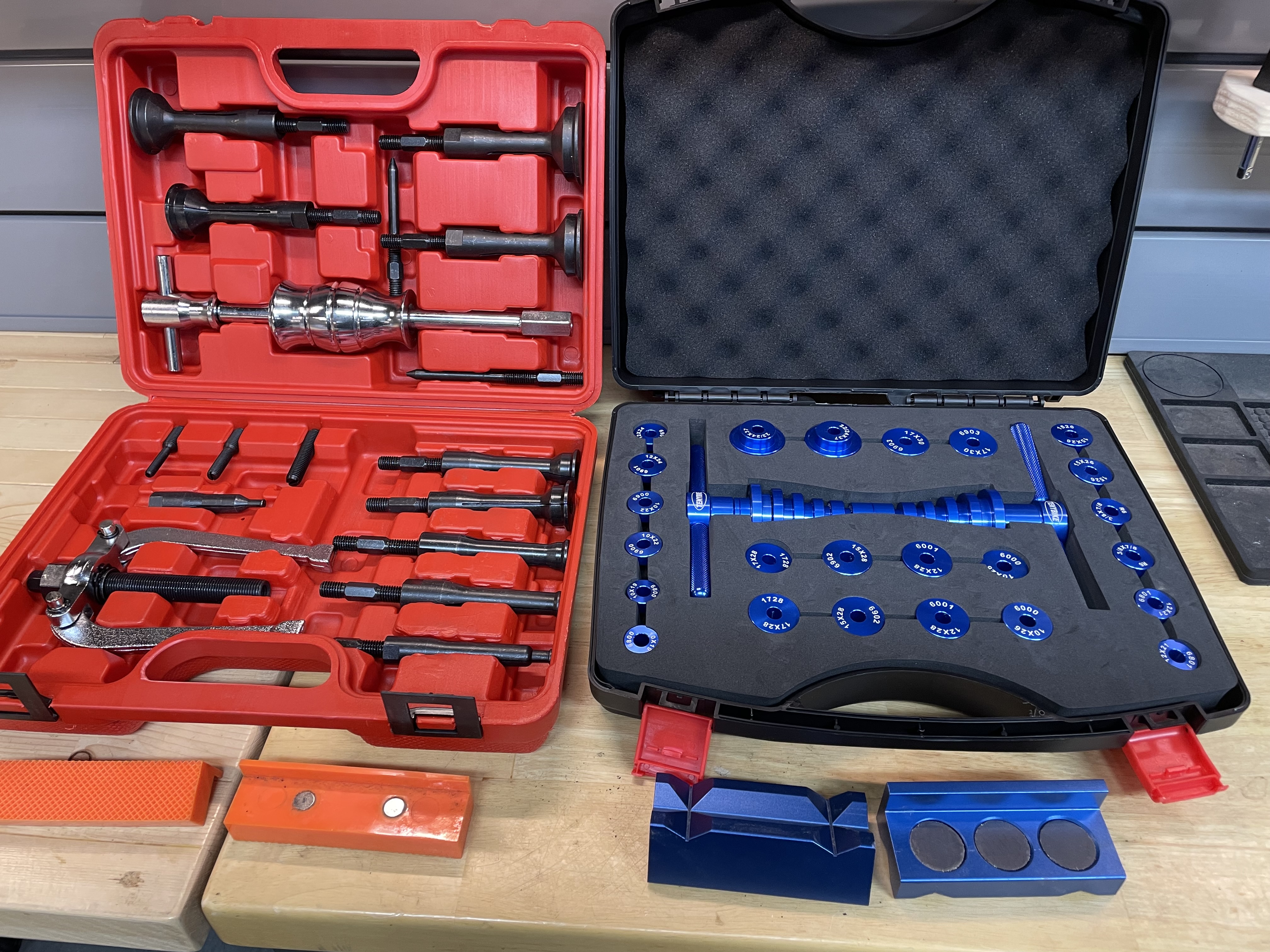

Received these kits recently, have new bearings and ready to play @dobbyhasfriends bearing help video on a loop. 😉
These were under $80cdn each. The other items are soft-jaw clamps (rubber and aluminum with magnets) that fit in the bench vice.
When I do a suspension bearing overhaul on my bike again, myself, these kits will pay for themselves. They are not the highest quality but they are suitable for a garage workshop.

The blind puller is the tool for that job. Buzz it on, tap out the bearing from the other side, repeat. Job done, five minutes tops.

I can’t remember to be honest. But I think I pressed out the black centre piece which in turn pushed out one of the bearings.

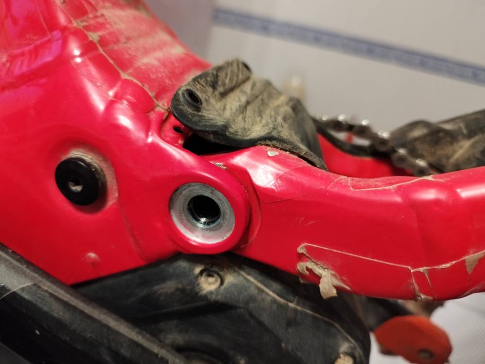

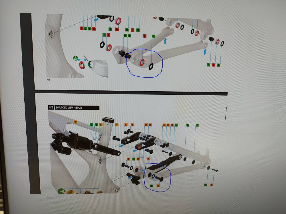

Thanks Dave, another question. Have you been able to check the main bearings of the bike? I can not access to them either.
Polo1602
Jan 19, 2023
42
15
Cologne
Ok, thanks,
And only to check if the bearings are ok?
Yes. The Spacer "M" goes thru the bearing and the frame. You must drop the motor to remove the Spacer "M". Without the Spacer "M" the chainstay is free and you can access the bearings.
