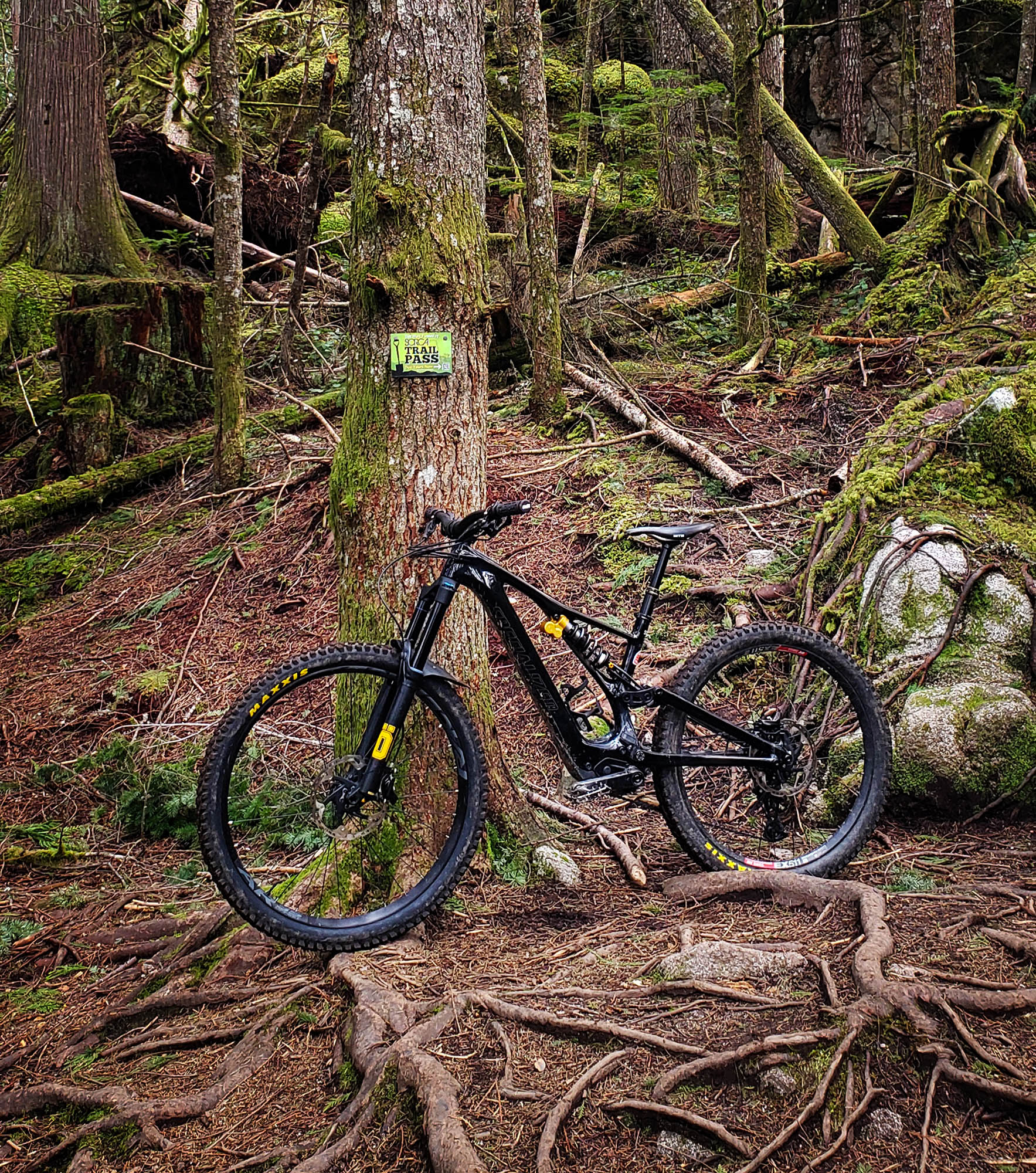

While I agree an entire bike in yellow would be hideous, can you still call it an Ohlins shock without a yellow coil? How unSwedish of @HeyHey :oops:
