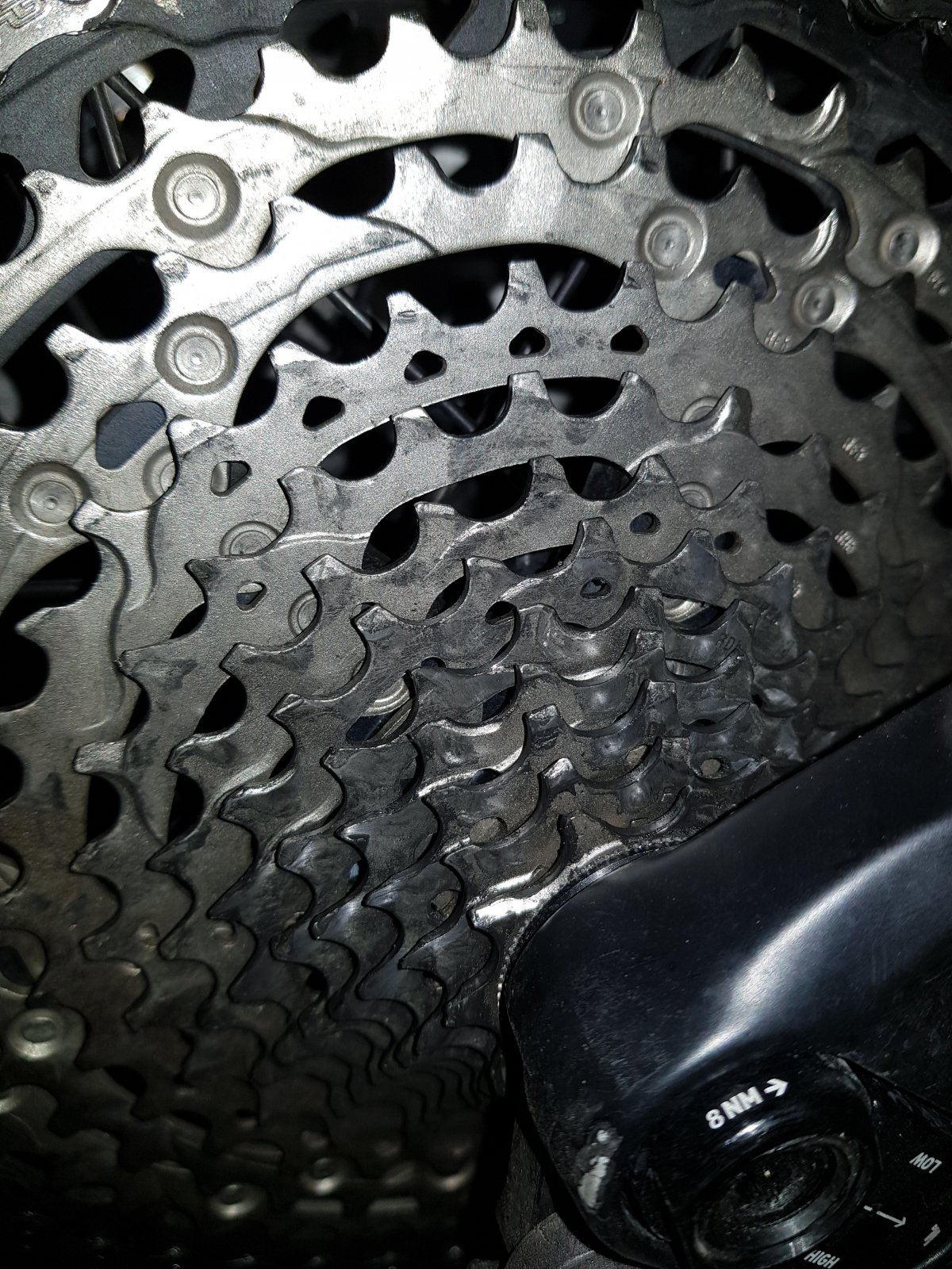

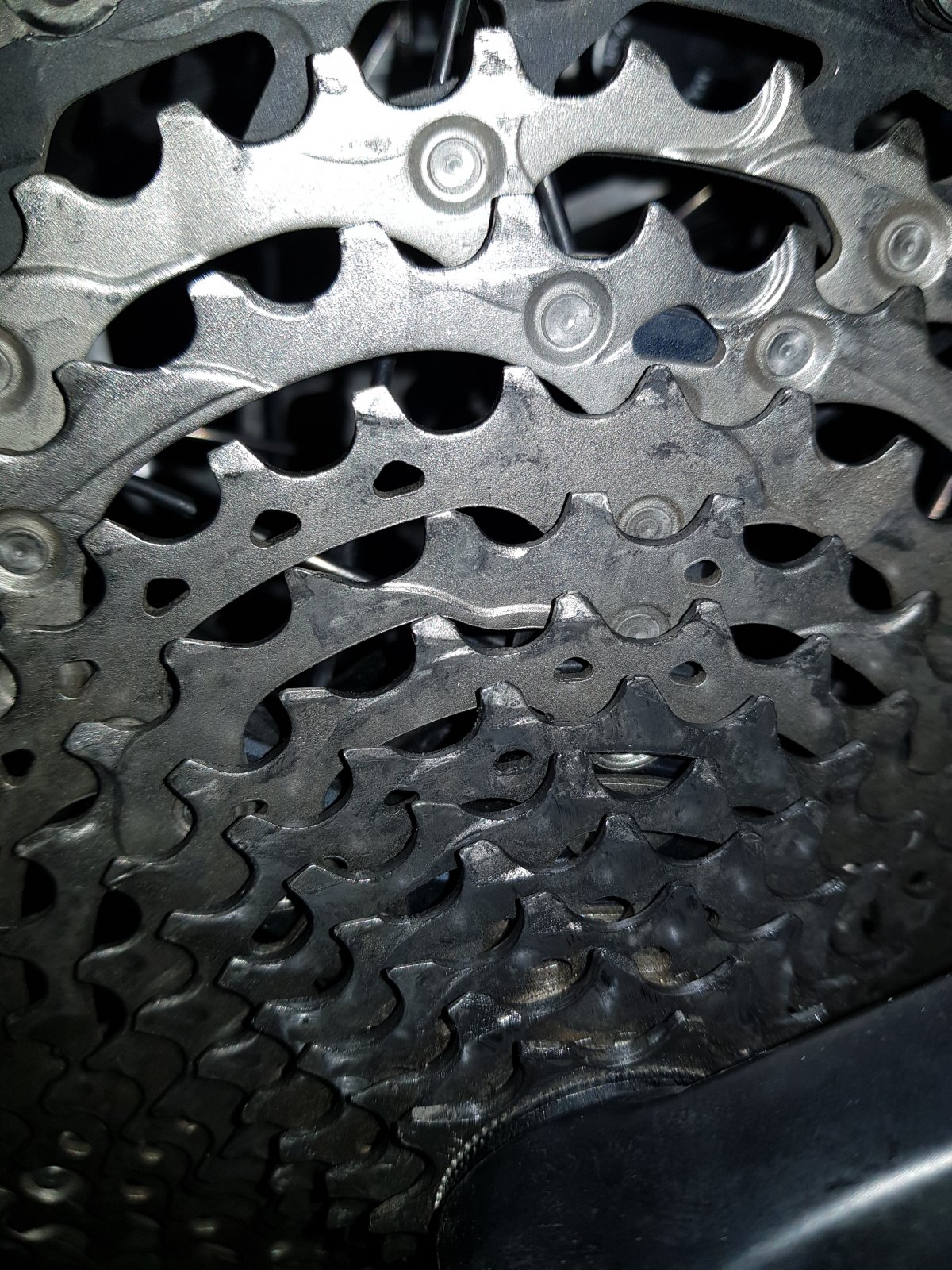

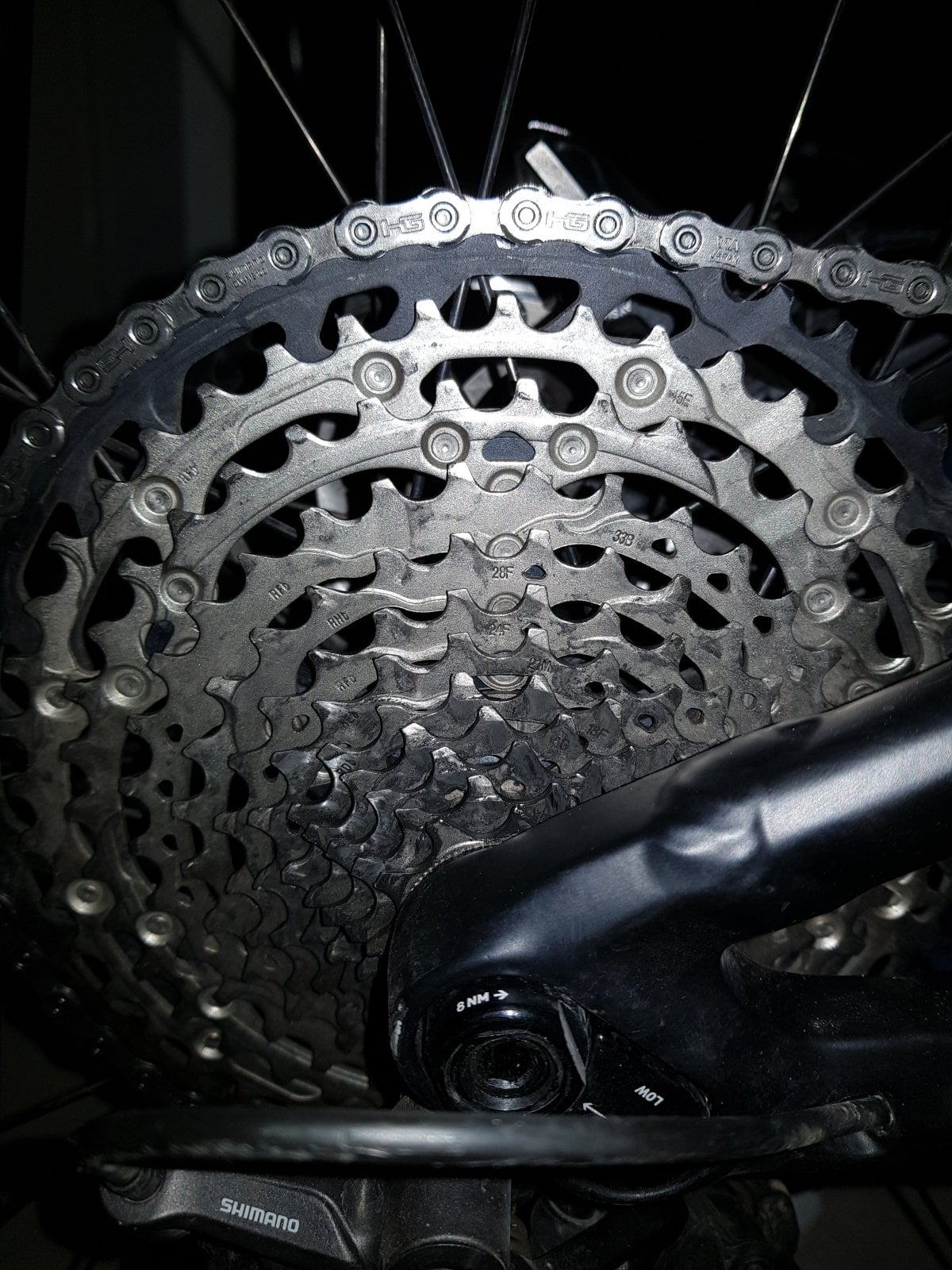

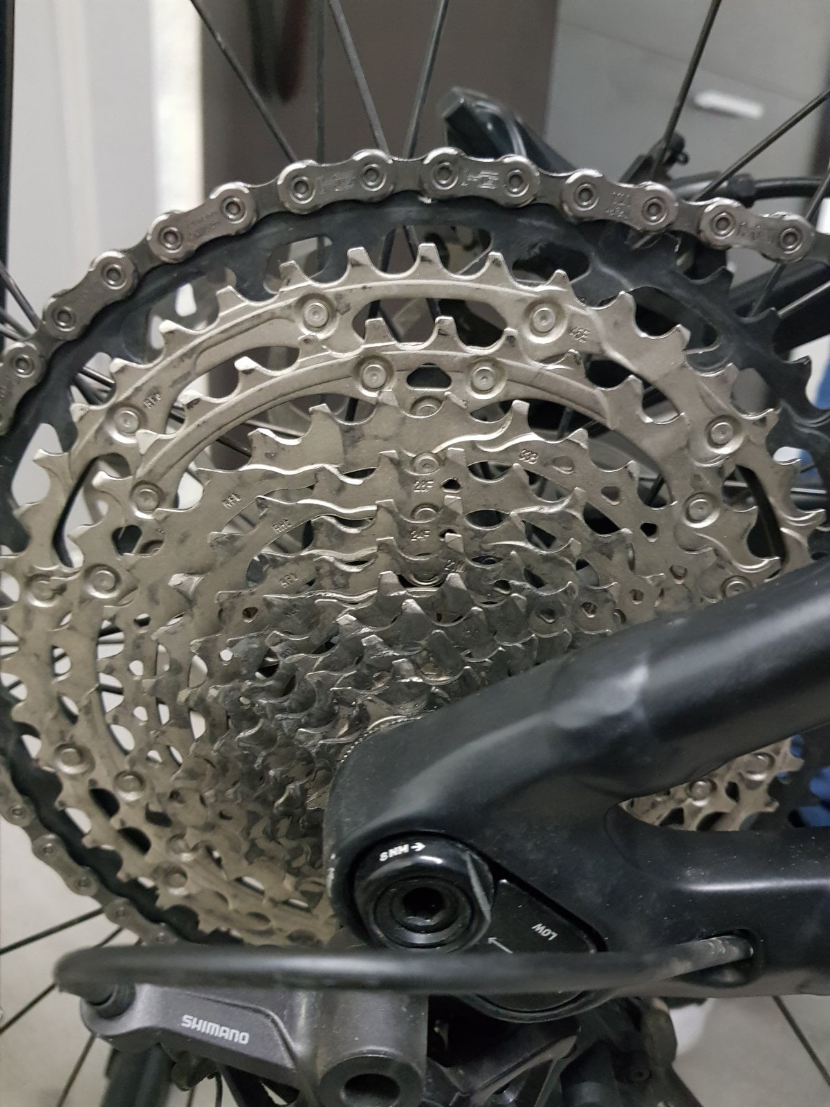

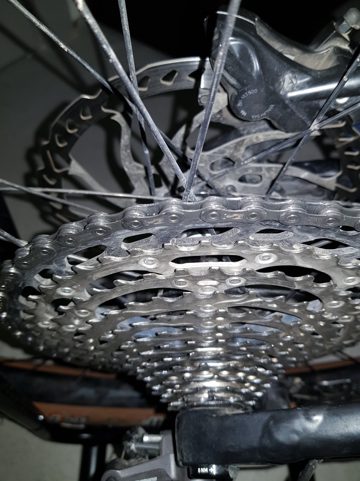

I have this Shimano SLX m7100 on my Focus Jam e-bike. I have recently experienced skipping in the gears when i put a lot of pressure on the pedals. I have changed the chain. I have allready ordered a new XT M8100 casette.
However i am curious how busted my casette is. A part from the obvious chip on the smallest ring, i have a hard time figureing out how busted it is.
What do you guys think?

That looks perfectly fine to me.
No burring on the teeth tips (metal being pushed out of place causing an overhang that can snag the chain during shifts).
No extended tooth roots (indicating wear).
No hollowed-out tooth faces (ie shark fins, indicating wear).
How many miles has that cassette done?

Thanks for the reply! Around 700 miles, but i didn't change chains at all during those miles. I mostly experience skipping on the heavy gears.

slipping before you changed the chain or after? A new chain on a part worn cassette is more likely to cause slippage. If it was working OK with the old chain put it back on!

The old chain skipped, put on the new one and rode like.. 500 meters, still skipped too. I'm not gonna ride it untill i get my new cassette on. Don't wanna destroy my new chain

Looking fine to me from the pics. I normally get the dremmle out and take the burs off but can't see any on yours. Personally I would check the b screw setting as it might be out enough to cause the problems.

Update: I put on the new cassette and it was still skipping. After pulling my hair out for a second or two, i disassembled it again and found out my wheel hub was really lose.. After tighening it, it worked perfectly. So my old cassette was probably not damaged.

I changed my chain on a cassette that looked unworn but it skipped on the 11th and 12th sprocket afterwards. I had measured the new chain length based on my worn chain. However it appears I needed to take out a couple of extra links and it was perfect. My son spotted the problem as the angle of the derailleur looked wrong to him when it was in first gear. I took two more links out and problem solved. That may not be your problem, but as I understand it, there is not much chain wrap in the higher gears especially on the eleven or twelve tooth sprocket, which makes them susceptible to skipping. If your chain is too long it reduces the wrap. Hope that helps.

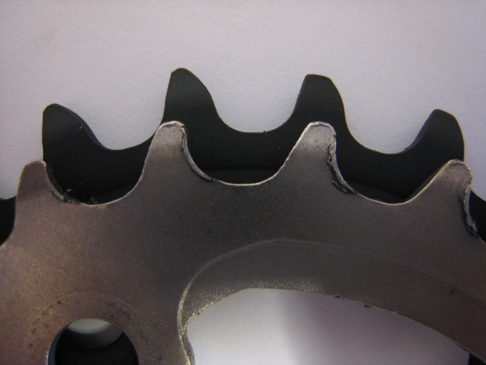

This well-worn ring set in front of its replacement illustrates the main features. I know that your problems were with the cassette, but this pic is a particularly useful one.
The most obvious feature of the grey ring is the big burrs that have formed. These are caused by the soft material of the ring being pushed out of the way by the harder chain rollers. The next obvious is the hollowing out of the tooth face, causing the classic "shark's fin" appearance. That tooth face material has to go somewhere. Some of it will be particles that are flaked off, but some of it is squeezed aside to form the burrs. Those burrs can eventually snag on the chain, causing shifting problems. As the wear accelerates, the root of the tooth is extended, caused by the tooth face being steadily worn away.
When I was new to biking, my chain was misbehaving on the cassette, I used a magnifying glass to examine the cassette and the only thing I could notice was tooth burrs on many of the gears (the ones I was using the most). I removed the cassette and filed off all the burrs. That got me one trouble-free ride before the new cassette arrived.
