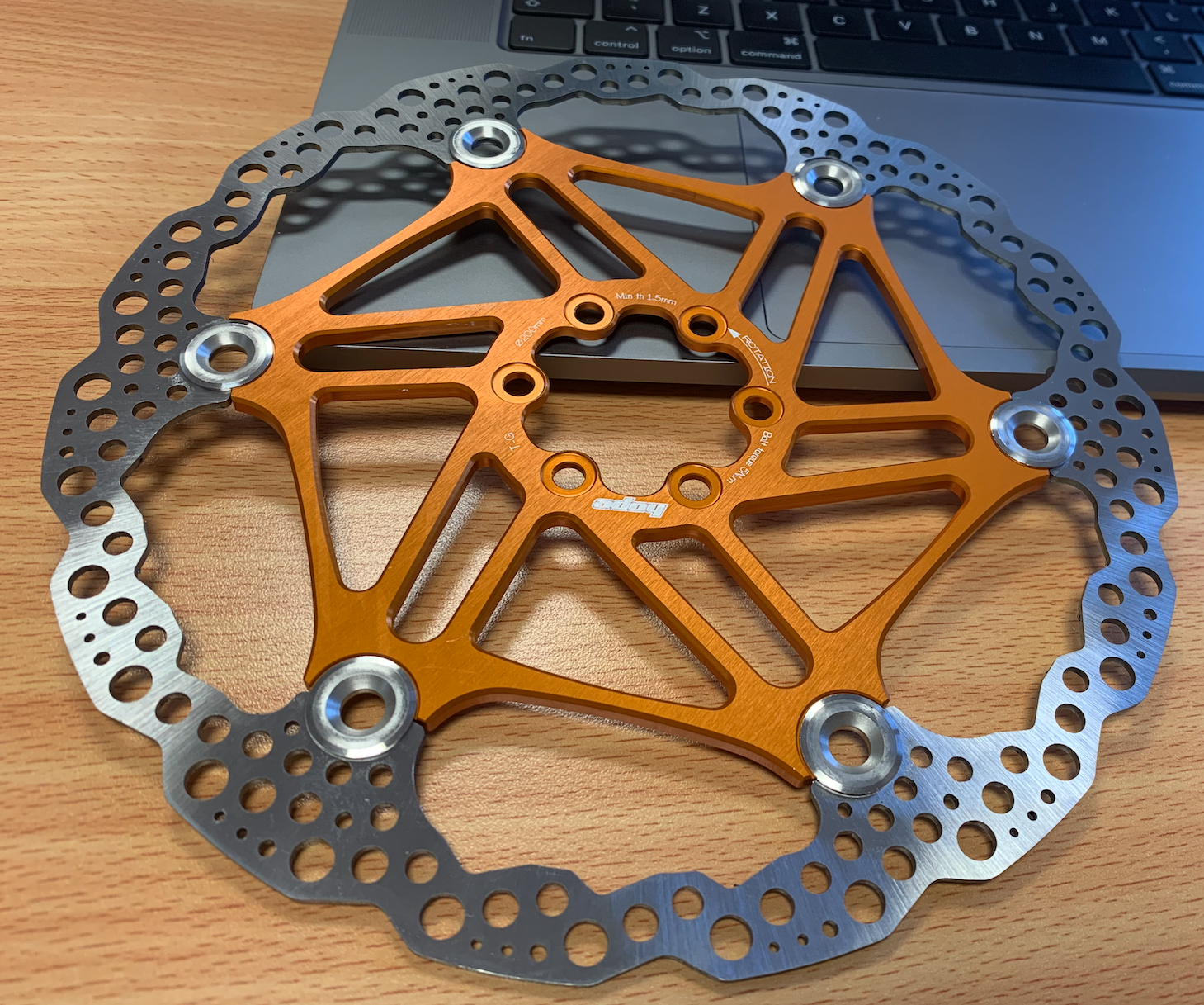

That is a stunning bit of machining.

Well, the moral of the story is always listen to @R120
They rivets do indeed rub on the caliper...but, they look awesome! Attached photos below to show where they rub. I didn't spend any time trying to adjust and make it fit as the Guides will be going shortly anyway.
It doesn't look like you'd need to file off too much caliper - 1-2mm, having said that, I wouldn't chance it.

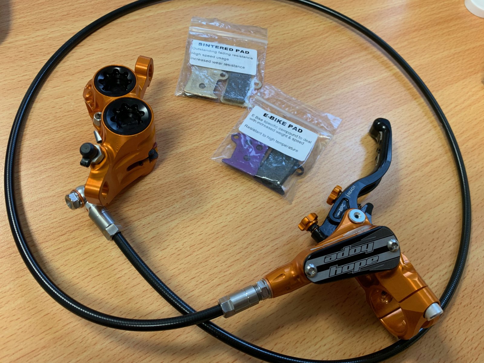

Well, my V4s finally arrived. They've come with 3 sets of pads - Sintered, presumably standard (red back) fitted and an e-bike specific pad as well ?? Does anyone know anything about these as I can't find anything on t'interweb.

I love them, pull them hard enough and you can lock them both but it’s really easy to modulate them to bring you to a quick stop with no drama. The adjustability is brilliant, and, in my opinion, then look great.
Due to the replaceability of each part this is definitely a set of brakes for life. Assuming they don’t clash miserably with whatever I buy in future. Perhaps I should have bought black ?
