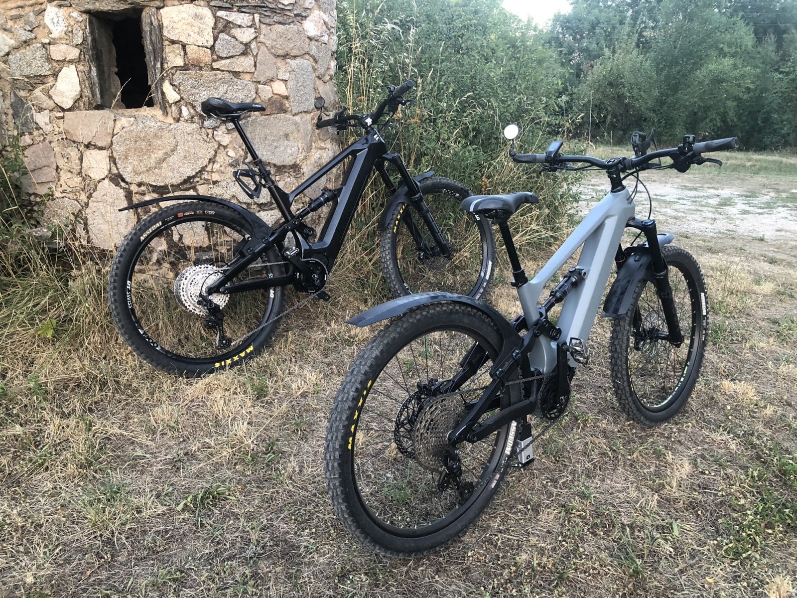

Just finished putting together new E10s for my wife and me. They have the M510 motor and 960wh (20A) 48v batteries. We haven’t managed to get out on them properly yet as it’s been too hot.

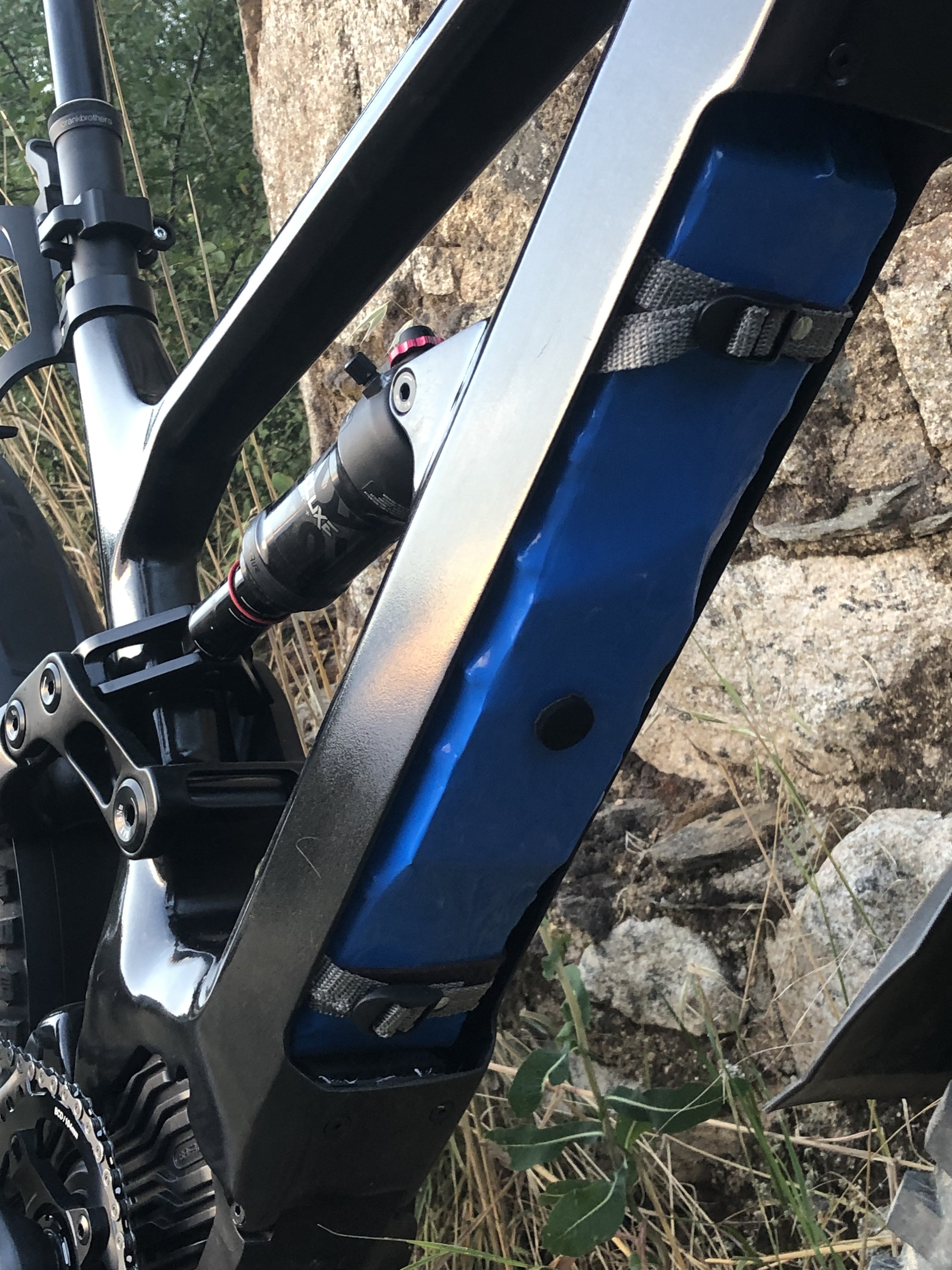

They are custom made batteries that don’t have a switch connection, so I filled the holes before painting. On my old E-10, I disabled the switch in the battery.

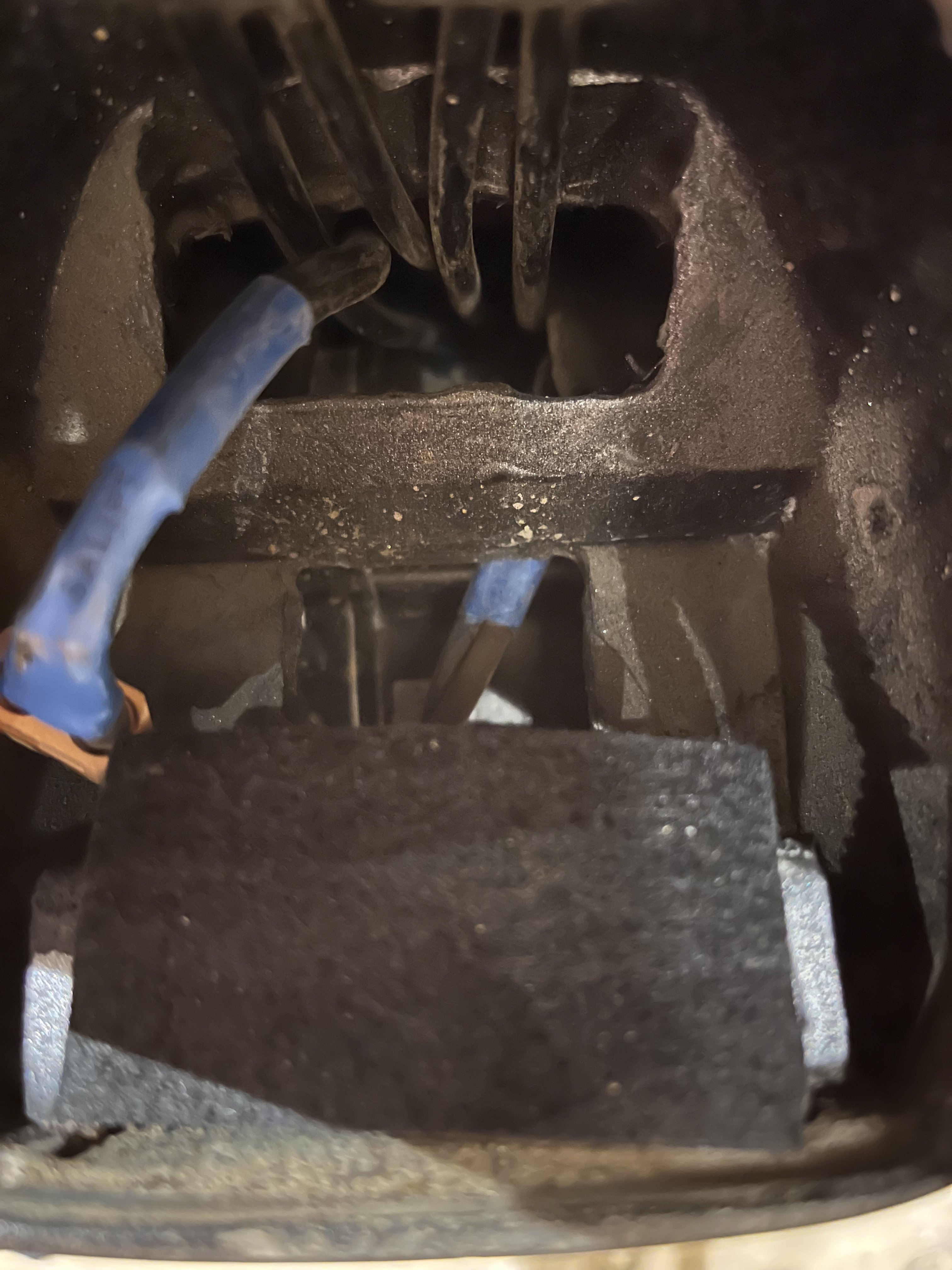

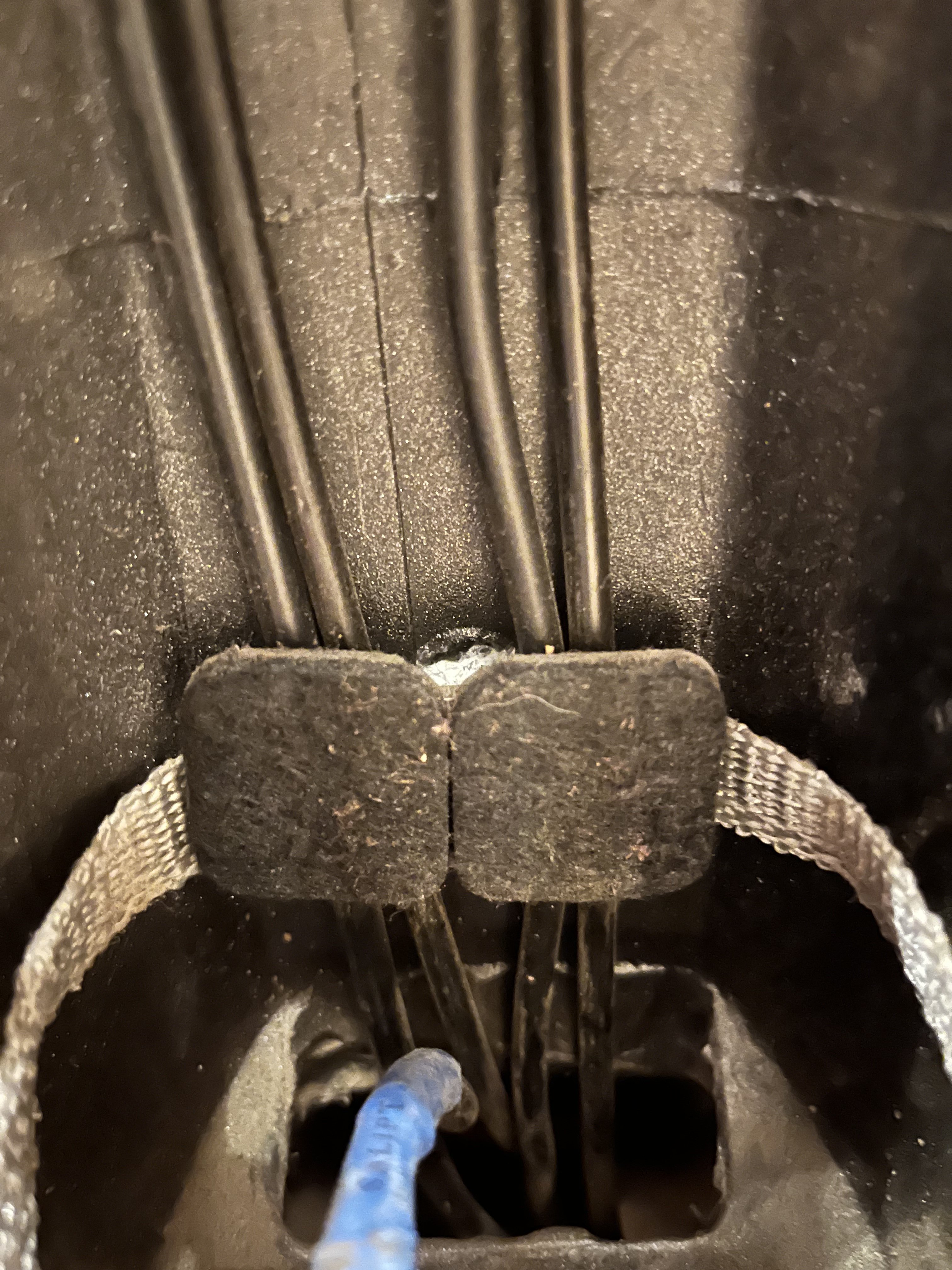

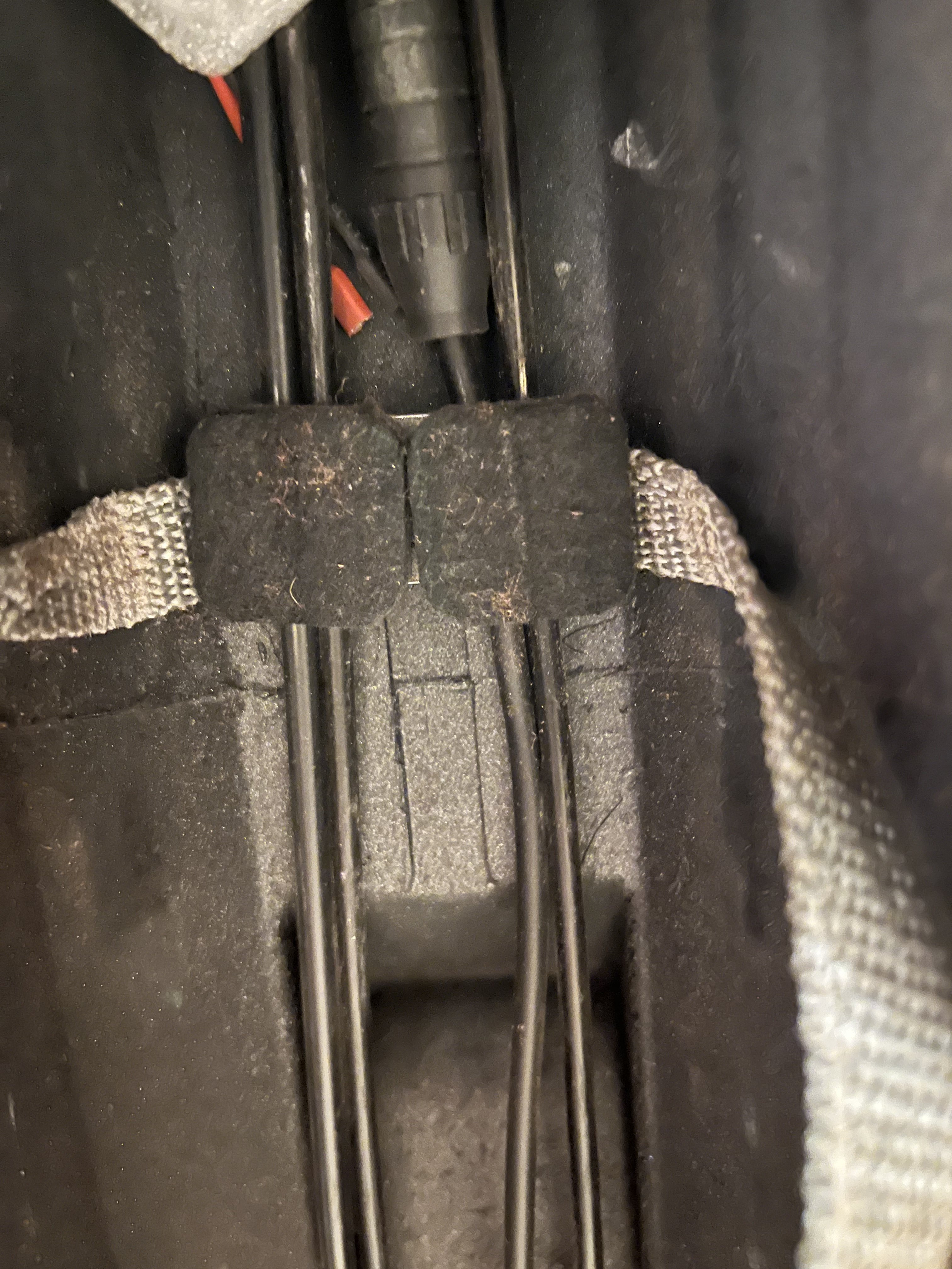

Looking good. How do you strap the battery to the frame? Can you make a picture of under the battery compartment?
eugene8
Nov 12, 2022
27
mainland
Straps are behind the original cable brackets. I’ve added a bracket at the bottom to stop the battery sliding down. Then I’ve used thick stick on felt pads for protection.
This is a good idea to put the strap under the original bracket. I'm going to try it
