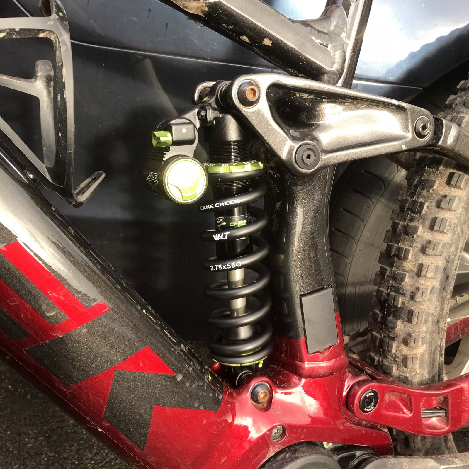

I have been very impressed with the coil shock on my commencal , so much less faff than air shocks , so good to know the rail can take one ok . The model Iam buying has quite a decent air shock , so hoping it’s going to be ok .
NEW RockShox Super Deluxe Ultimate RT3, DebonAir spring, Thru Shaft 3-position damper, 230x57.5 mm

It’s supposed to be better than the shock on my 7 but quite a few people don’t like it, something to do with the through shaft technology and Trek-specific tune.

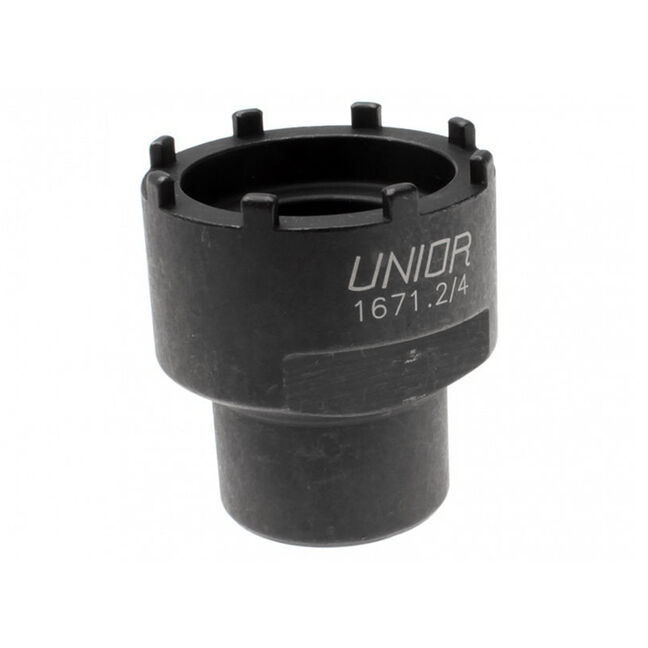

Quick question on the Bosch locknut, does anyone know what tool I need to have? I called a shop and they couldnt really be very specific. figured I'd get a now one since I plan on changing my crank arms length in the near future.
Shimano ISIS Drive and ISIS Overdrive eight-notch bottom bracket tool

IceToolz Bosch Lockring Tool Sprockets M801 Bike Bicycle Lockring Remover 4718152228017 | eBay. This is best value I could find on the lock ring socket . icetools quality is pretty good
I don't think that will fit the Bosch CX Gen4 fella.... won't clear the spindle. Its for Gen 2.
Best value I found to fit a Gen4 was the Unior Tool 1671.2/4
In stock at a few usual EU online suspects as well.
You can see its deeper than the Icetools M801...
Ohh bloody hell , looks like I may have wasted 15 quid then . you posted this link and I followed it to eBay then bought the other one because it looked like a better deal . There’s no info on them as to which model they fit so presumed all bosch lock rings were the same Doh!
lol... yes, I pm'd you the Unior tool link and not the cheaper Icetools one as that doesn't fit ?
