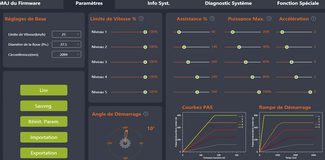

Personally i don't feel the "auto-adapts power output" of the mode sport+ ? i just feel an mode more powerfull than sport and less than boost. But may be i'm not any "sharp" enough to feel the difference ? If somebody have instructions to determinate if this mode have something different to other, i ear.
I 'm only able to said that the RS is more fun, efficient (a lot) and quiet than the M510 rev2. All for an consumption of +- 15% more for more of 60% less human torque needs: +- 160W (reading on HMI) at 70 RPM to obtain max power of the mode.
Not sure that justify to purchase one to replace M510. For those use motor only to climb up the bike on DFCI, To take pleasure on downhill. More justified for those who like climbs technical hard single tracks (and want to keep in line with EU rules).

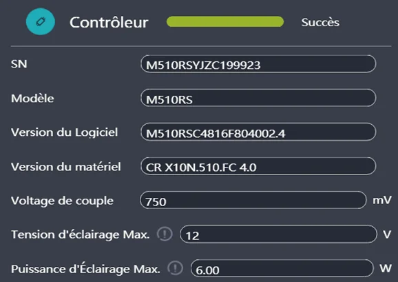

Other point, the software don't provide 22A output (in 48V), it's 16A. +- in line with the max power reading on HMI on boost mode (750W),
Only desagrement found. battery level still lowered, even when you don't use motor (on downhill). I need to ride more to understand, but you lose few % ( 2 or 3) during 30mn of down if one mode is activate (i will test in mode 0). I don't notice that on previous motors ?

Fair point on the 16A output, @patdam, and thanks for the correction. That aligns properly with the ~750W max power reading on the HMI in boost mode at 48V. I had the 22A figure from earlier spec sheets, but your real-world data from the actual controller software is what matters here.
On the Sport+ question, your instinct might be right that it's less dramatic than the marketing suggests. If the "auto-adaptation" is real, it would likely manifest as subtle torque modulation based on gradient changes and cadence shifts, the kind of thing that's nearly impossible to feel consciously because the whole point is that it feels seamless. It's a bit like adaptive suspension damping: if you can feel it working, it's arguably not working well enough. That said, if it genuinely is just a fixed power level sitting between Sport and Boost with no dynamic behaviour, that would be a rather generous use of the word "adapts" on Bafang's part.
Your consumption numbers are interesting though. ~160W rider input at 70 RPM to hit max mode power, with only 15% more consumption than the M510 for 60% less human torque needed, that's a genuinely impressive efficiency gain, especially at your weight and in the Pyrenees. The M820 on your CEF50 was already remarkably efficient for a 48V motor, so seeing the RS improve on the M510 by that margin is notable.
The battery drain with the motor inactive is worth investigating further. If you're losing 2-3% over 30 minutes of descending with a mode still active, that suggests the controller is drawing standby current even when not providing assist. Testing in mode 0 is the right move. If it still drains in mode 0, it could be the HMI and controller keeping the BMS communication loop alive. Worth checking whether the M510 rev2 had the same behaviour and you just didn't notice, or whether it's genuinely new to the RS controller firmware.

Where is written M510RS has now 22 Amps?
Patdam, that efficiency you writing. How you see it? There is same controller (and I guess same FOC algorithm) and same rotor and stator, no?
