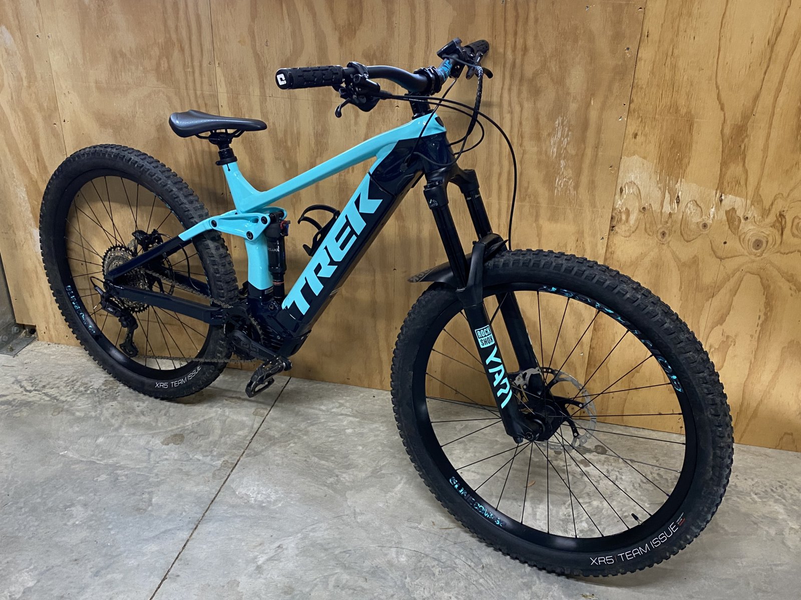

Recently bought myself a 2021 Trek Rail 7 in Teal colour. Love it!
When i bought it i told myself (and my wife) i was going to keep it stock, well.... it was a nice thought lol. Luckily my wife knows me too well and had assumed i wouldnt be able to help myself from upgrading things without any regard for financial responsibilities hahaha

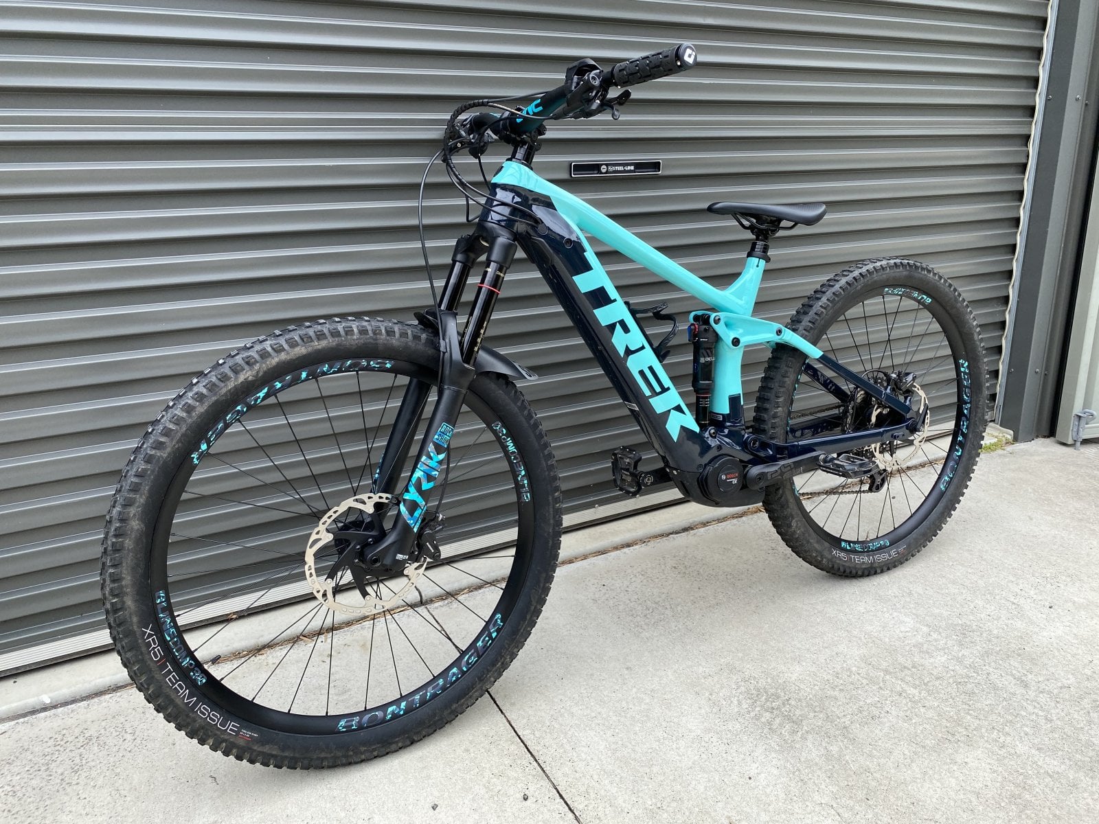

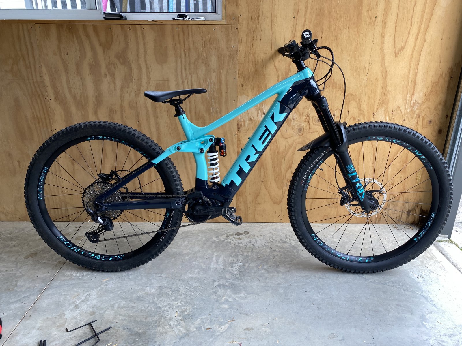

So far ive added;
- One up carbon bars with higher 35mm rise
- ODI grips
- raceface stem with shorter32mm reach

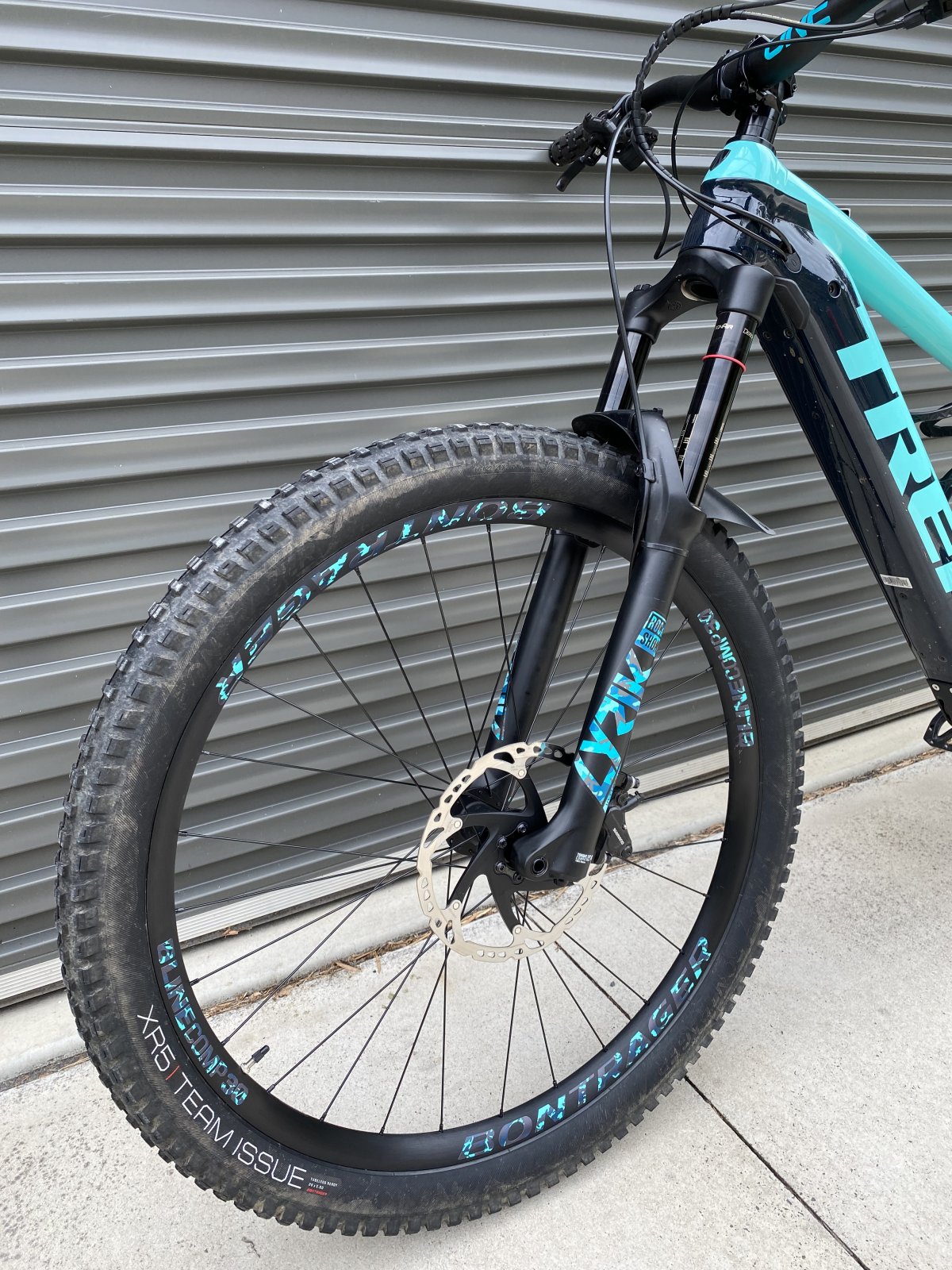

- Upgraded fork to 170mm air shaft
- Upgraded fork to charger 2.1 damper (so now basically a lyrik ultimate)

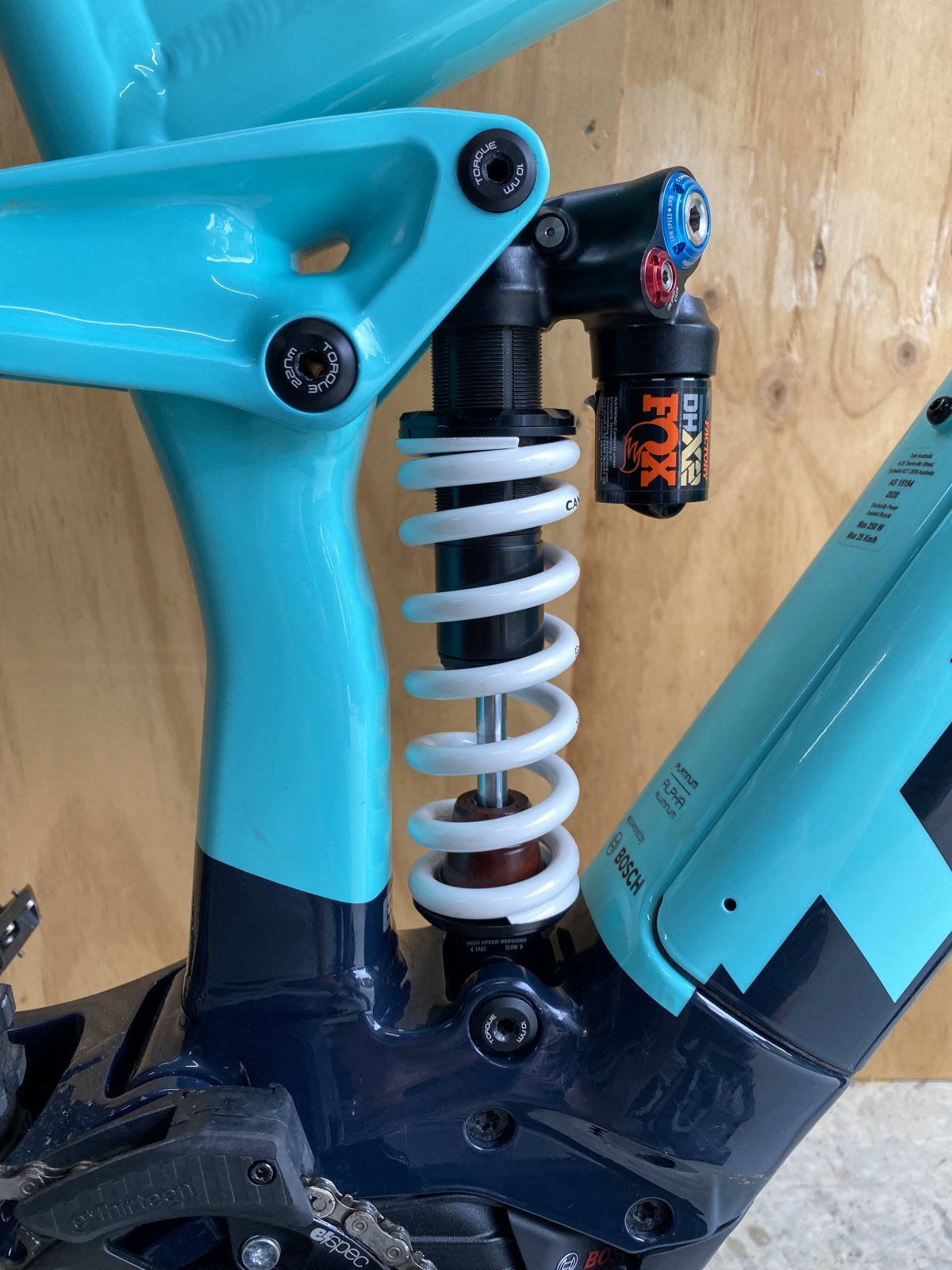

- Just bought a fox DHX2 rear coil shock which i will fit up once it arrives and ive got the spring
- Had a friend custom make me some new rim stickers in cammo pattern using the bikes colours (since added more to the rims after this pic which looks alot better)
- Went tubeless, and got some Maxxis tires sitting on the shelf ready to fit once i get some more use out of the stock ones
Nice bike :)
Can you give any feedback on what the 2.1 upgrade did for you? Any stand-out differences?
I would also suggest going for SKF wiper seals if you want the Lyrik Ultimate feel. I fitted them to my Yaris and they made a really big difference to SBC.

Nice bike :)
I did this upgrade too with the SKF wipers.
Initially it was horrible (first ride) until I reduced the air by 5-10%. Set up the rebound and then it was great. The feel/response is so much better. Didn’t apply any Lyric stickers because they were $$ rediculous.

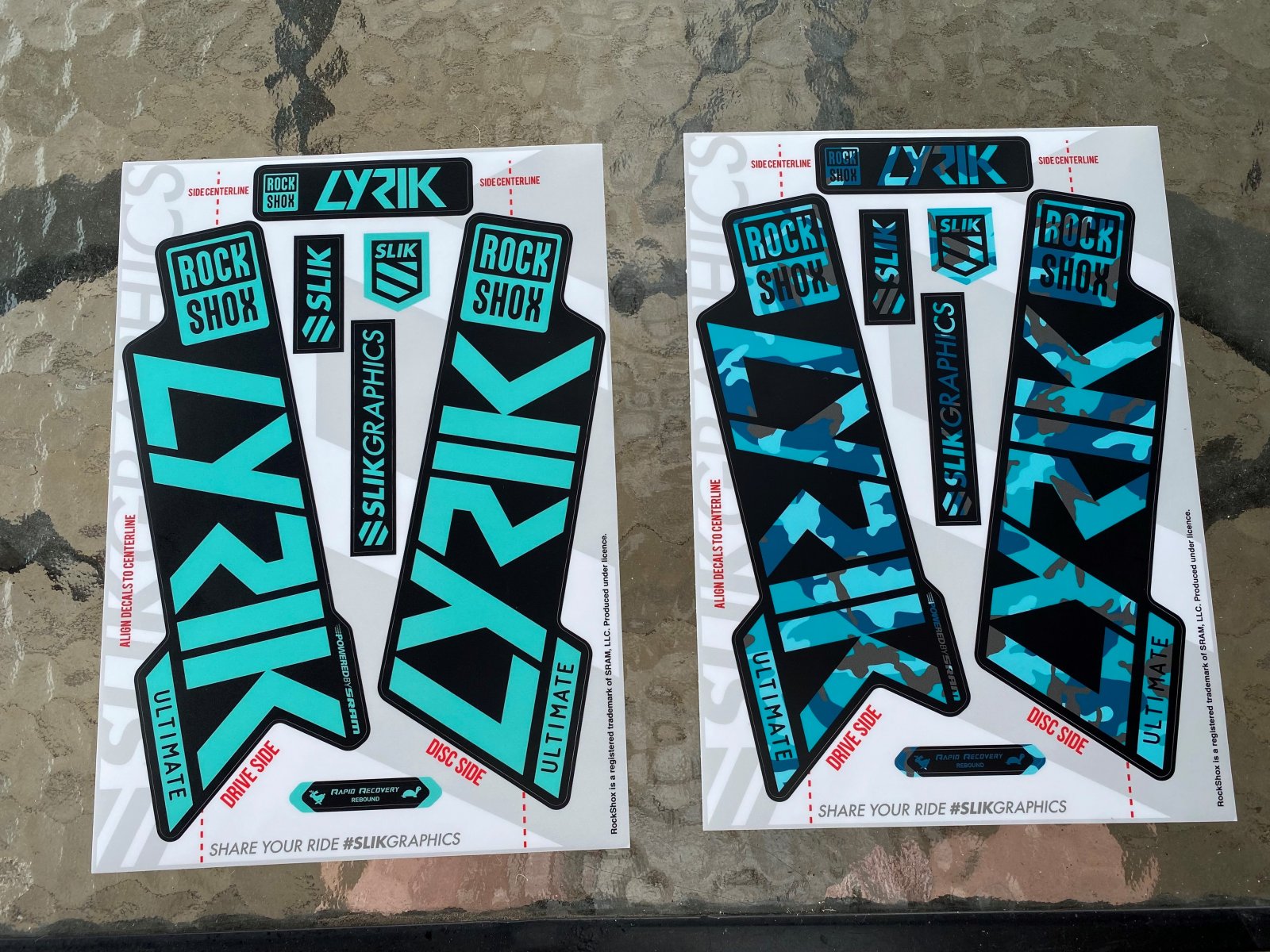

You can get all manner of reproduced OE stickers off the bay :) I think Lyriks were about £8 when I looked.
Wait …what! The LBS asked if I wanted the Lyric stickers also…for $60 CDN. ***k that. $15 CDN seems more reasonable. For now I’ll stay in sleeper-mode with the Yari stickers. E-bay eh?
I have ordered my lyrik stickers off of Shop and customise mountain bike decals // Slik Graphics where you can custom choose colours or patterns to make the perfect sticker (they can even colour match bikes). They were $30/set for the custom colour ones i chose. reasonable if you ask me.
i will post with photos once i get them. i ordered 2 sets of stickers as i could decide what i wanted, so got 2 different ones haha
well.... Just had a knock at my door and guess what just arrived. All the way from SWEDEN!
Ordered 8 days ago, printed custom colours, delivered to my door just now.
Website was super easy to use, stickers are super high quality, VERY impressed!
Cost $30 Australian each plus $15 shipping.
Now.... to decide which one to go with :ROFLMAO:

Went with the Cammo. looks a bit more custom i think.... May go to the plain teal at some point in the future for a bit more of an OEM look. But otherwise stoked with the stickers. Definitely recommend Slik Graphics for custom stickers.
Just checked - they were £6.50 but start at £7 now :)

I definitely felt the difference from the initial installation & in my mind I think probably the wipers have much to do with the inital plushness.
@DeRailled7 might have an idea also.
I added the SPK wipers with the Lyric upgrade. When I reinstalled the fork I returned the psi, compression and rebound to the previous settings (as a benchmark start). The initial ride was terrible. I dropped the psi by 10-15% and fine tuned the rebound and compression slightly.
That made a significant difference. It was definitely better. The feel was much better than the Yari. But I wonder why a drop in psi helped? The sag was better/correct too after a drop in psi. New seals? Didn’t add any spacers either. 🤔
Hi, the reason you had to reduce the air pressure to achieve the same sag after your upgrade, is because the positive air chamber (the one above the piston seal) is now smaller. The change in air volume will also affect the compression curve (progressiveness) of the fork. After the upgrade the fork might feel ‘stiffer’ and you might not use as much travel as before. Removing one token, like you did i think, will increase the air volume, add more plushness and allow you to access more travel. The following article explains it much better than i can.
ive noticed similar with mine. setting the sag has required a lower pressure then before, significantly lower. To the point where ive left the pressure too high to get the sag i was after because it just doesnt seem right that the pressure would be that low. Going to ride it with the sag firmer than usual then dial it down once i know its not going to just slam into bottom out haha.
