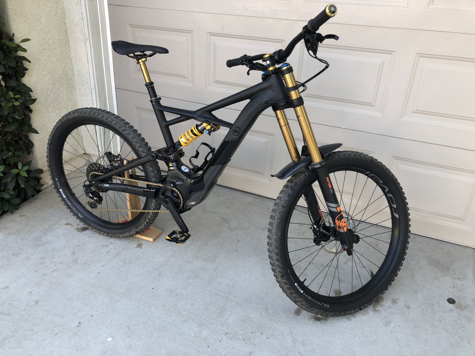

10
San Diego, CA
I installed the Rock Shox Reverb Stealth and I thought it was fairly easy. The manual will show you how to route the line from the handle bars to the seat post. Once you see the wire or hydraulic tube in my case, you need to grab it and pull it up.
You'll need something like this tool
The rest of the install is fairly straight forward and depends on what dropper you have. Lots of youtube videos that are dropper post specific.
Very pleased with the Reverb so far.
