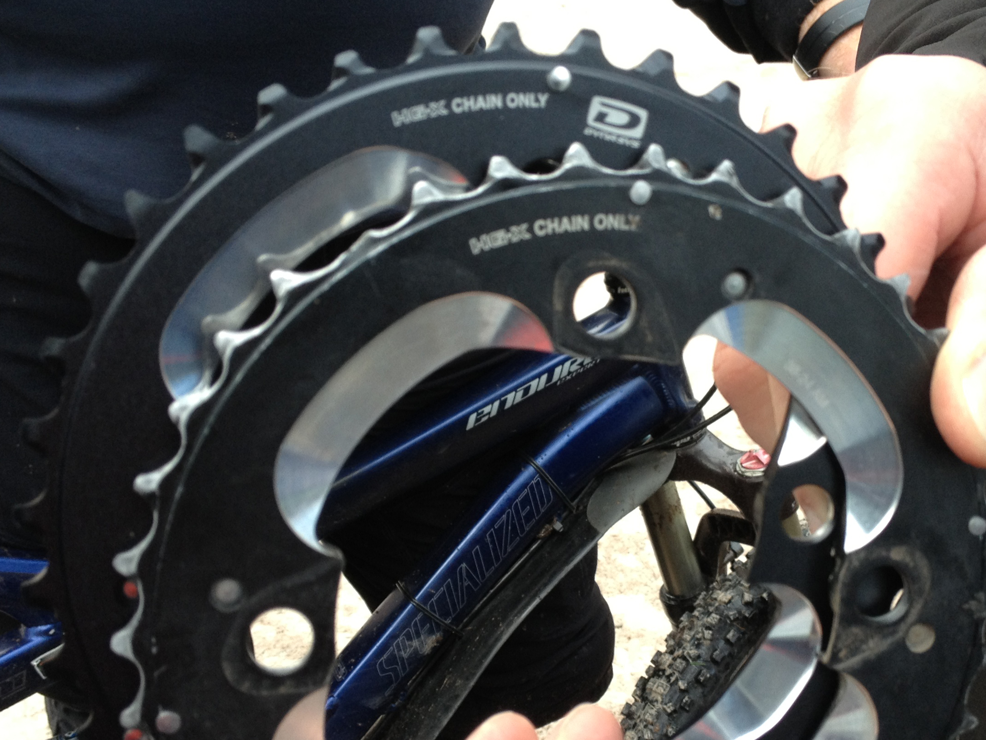

A worn cassette or worn chain on a new cassette would have been my first suggestion, but you report that they are both new. Next step would be the freewheel and then a worn ring. Freewheels do wear, they also can get water in there and the ratchet springs corrode. Unless it's something in the motor, I'm out of ideas. Worn rings can slip, it just doesn't happen as often as they have to be quite bad. This would do it! (New one in the background).
That ring worked fine with a new chain on the workstand and on the street, but as soon as I put any pressure on, the chain skipped alarmingly. I didn't discover that until I was out on the trail with four buddies! By the way, that is a ring off an mtb, not an emtb
