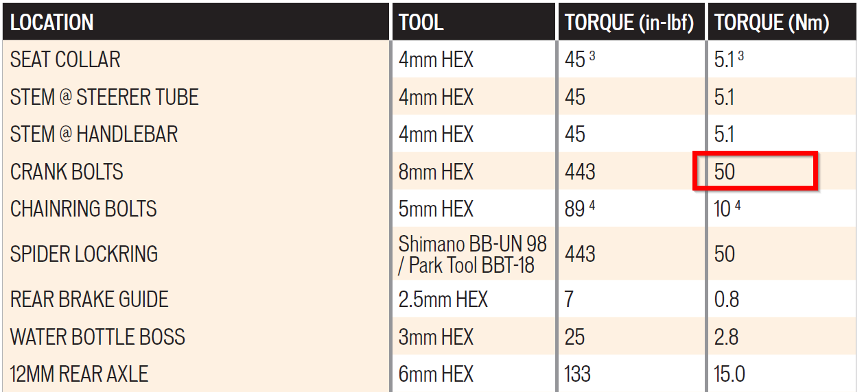

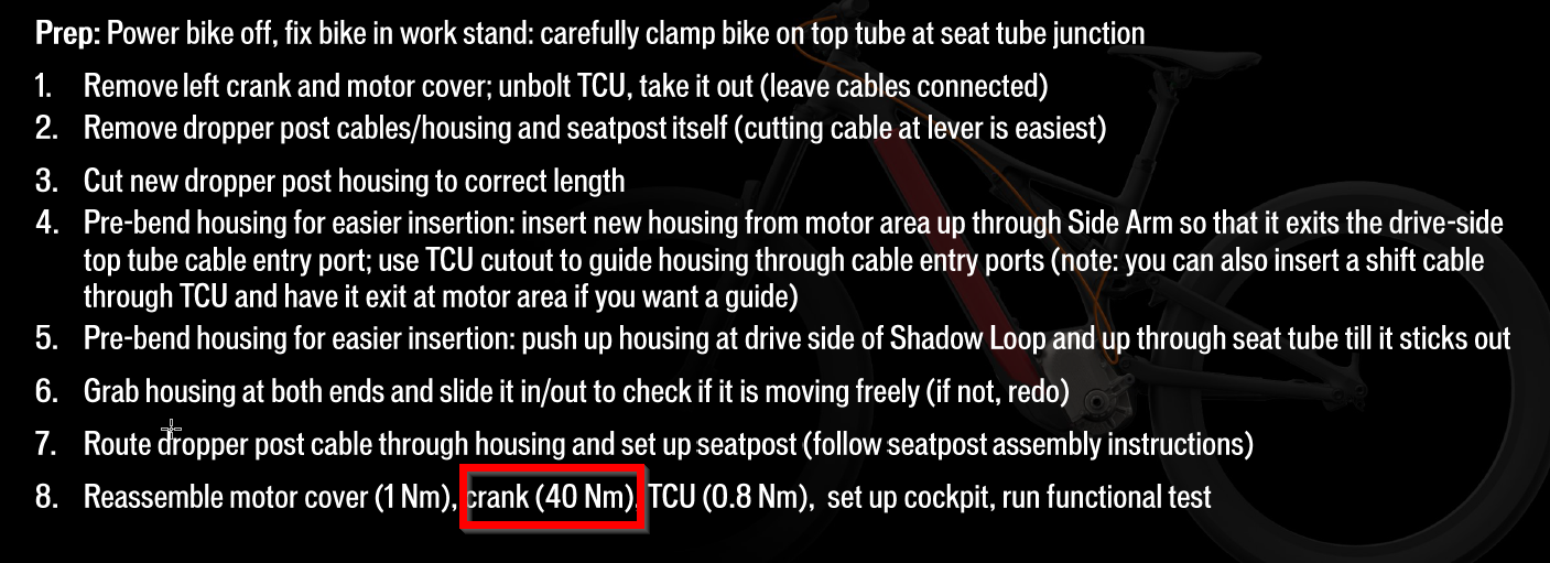

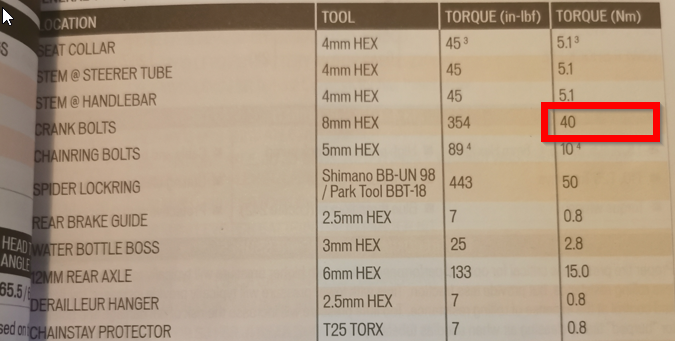

50nm is s scary torque on a bike.
It is indeed and I'm not sure it sould be that much the workshop manual states on several pages that it sould be 40nm, my Manual also says 40nm the new Version I downloaded says 50nm. My second motor was replaced because the crank fell of and I got this as a souvenir (lucky my lbs mounted the cranks to what ever spec they thought was right, watched them using a torque wrench). I stick with 40nm...
Workshop Manual:
My Manual:
PDF I downloaded:
maybe @Specialized Rider Care could clarify to avoid damage
