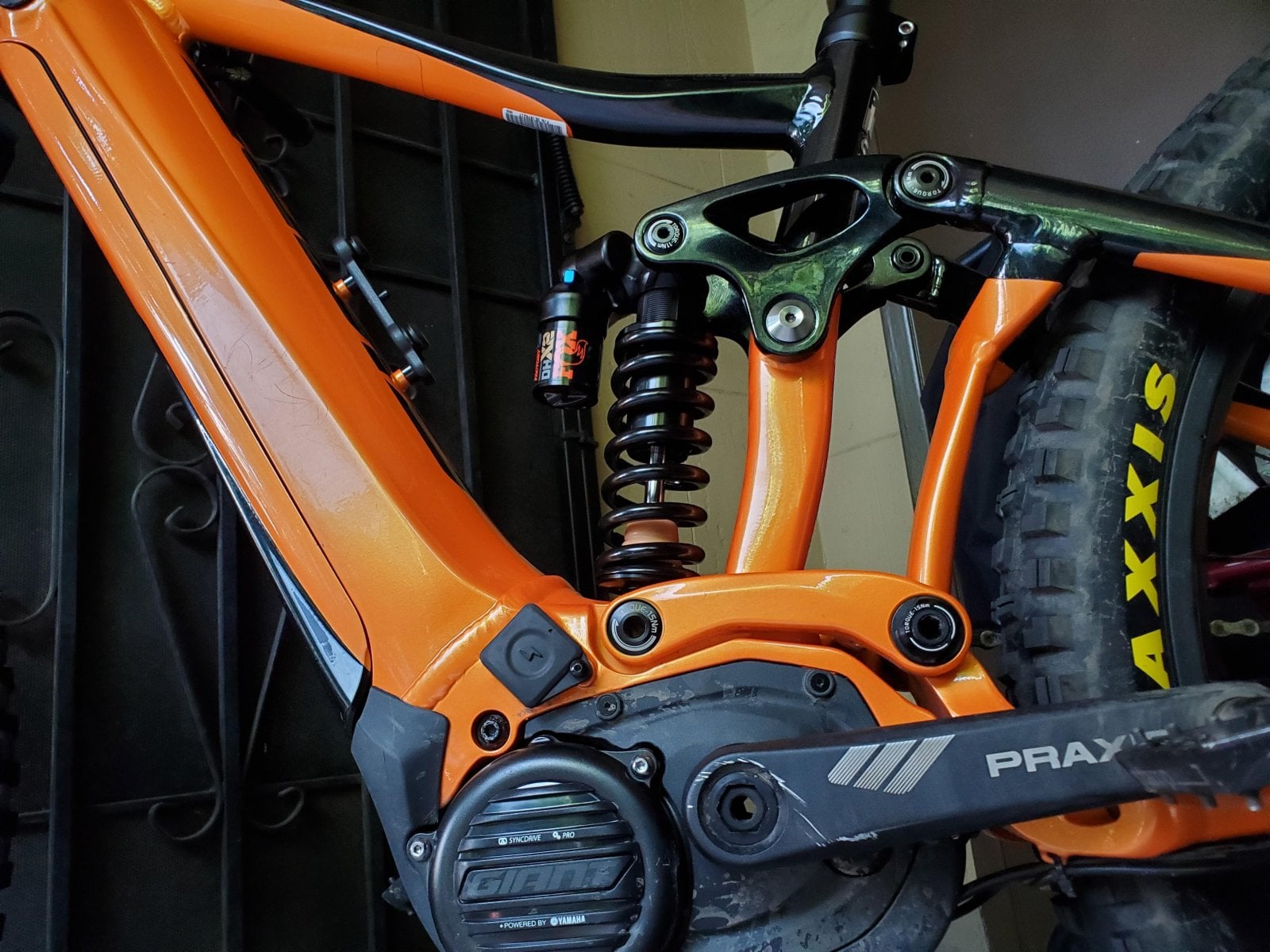

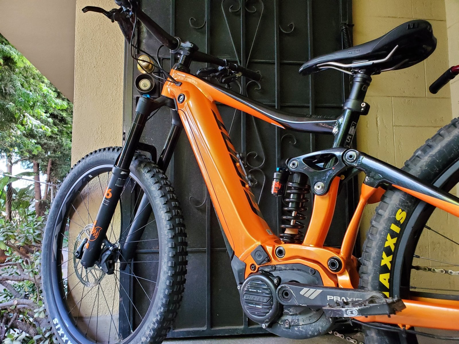

I've had my 2019 Giant Trance E+ 1 since the end of '19, and have made a few modifications. I upped the travel on forks by 10mm to 160mm. And more recently, I've upgraded to a DHX2 shock in the rear. I went with a 55mm stroke to increase rear travel to about 147mm.
