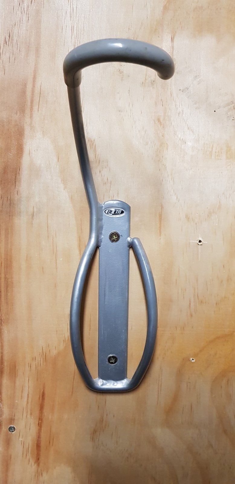

I have used these cheap hooks from CRC with success for analog bikes (with the rear wheel still on the ground, obviously), though you have to chop a bit off the end to get MTB tyres in. I am not sure they would go beyond a 2.5" though. If you are worried about there not being enouygh screws there is plenty of area to drill to add more.

I use these and have found them to be pretty damn good for the application I use them for.
delta bike hook | eBay

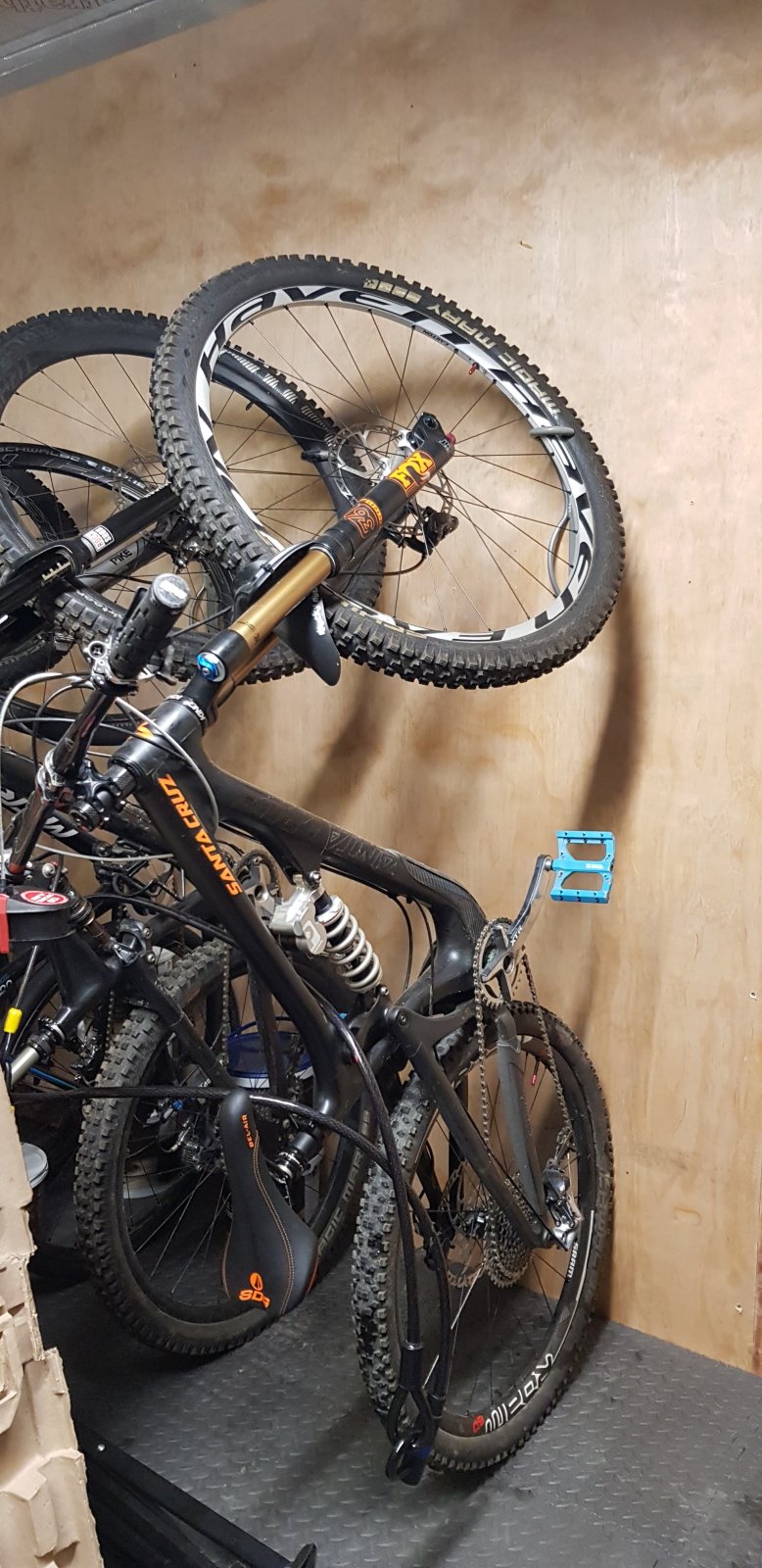

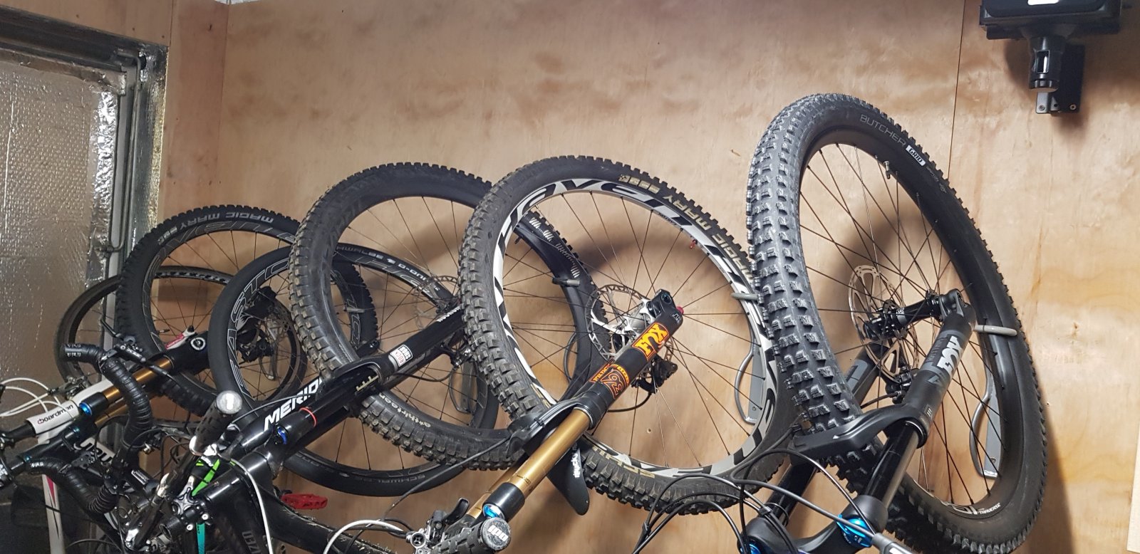

Really easy to fit as long as you have a solid base to screw them to. I always ensure when fitting the hook to the wall that the rear wheel of the bike you are going to 'support' rather than 'hang' is still on the ground. That way there is no real weight on the hook which means it can also easily support the extra weight of a DH bike or an ebike. As you can see in the photos below you can squeeze quite a few bikes into a fairly smallish area. The bikes are really easy to remove and also slot back in as required.
