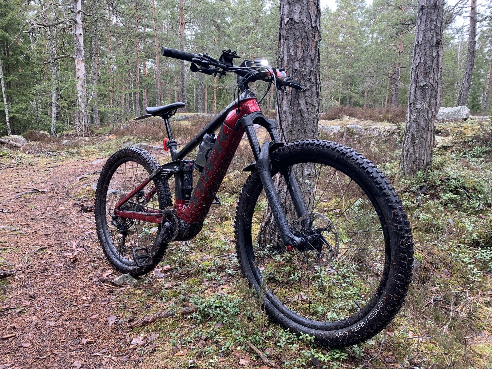

I have. It is neat to use the same battery. Heard there is a special reserve for lights. Trek included the wire already (you need to fish it out though) but you need to stop by LBS to activate it. Now I can switch on the lights from the Kiox by pressing a button.

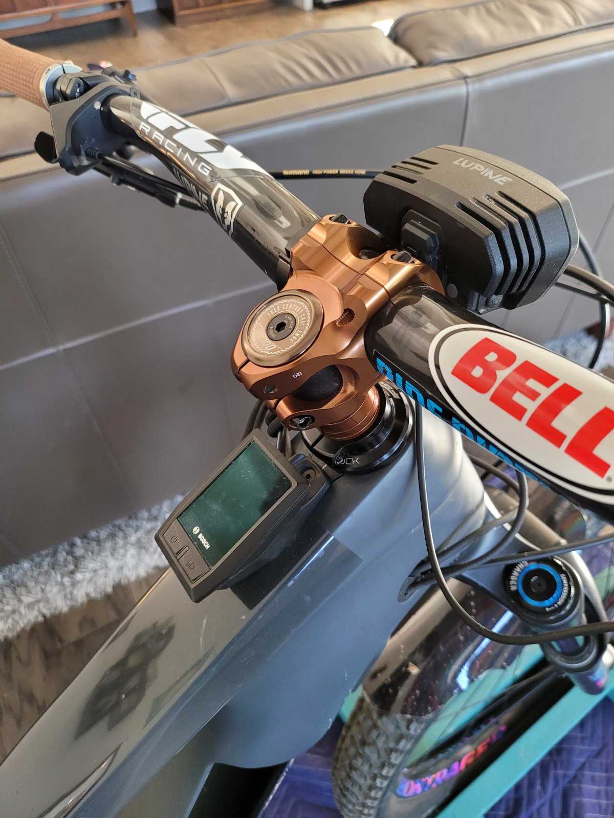

I have the Lupine SL X wired into my 9.8 and it is great. I also recommend the Lupine tail light that is integrated into the seat clamp, as well. We do a lot of night rides, so its just slap a light on the helmet and go.
The Lupone SL X apparently draws 30 W at 2200 lumens for high beam in the default settings, but only 18W at 1600 lumens for high beam in the eco mode. Given the Rail Bosch light power is max 18W, does the light work on high beam in default mode, or do you have to run in eco mode, effectively making this light 1,600 lumens max on a Rail?
GolfMaster52
Oct 19, 2020
64
68
Bentonville, Arkansas
I honestly do not know what the output is. But, I never ride in eco mode. On a normal EMTB mode ride, you can have the outer lights on, like daytime running lights on a car. When it transitions to dark, the main light in the middle automatically comes on. Then, anytime you want you can toggle it to bright and it is significantly brighter. Not sure if that helps, but hope so.
