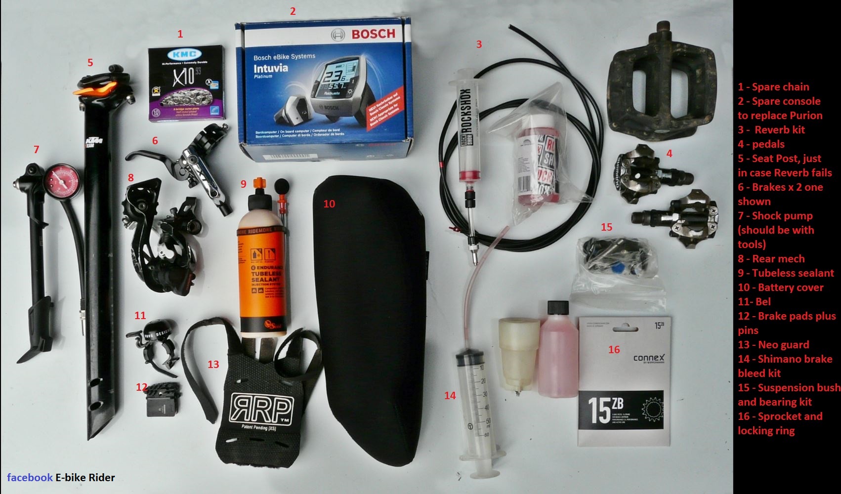

It largely depends upon where I am riding, and for how long, but this will give you some idea.
Not shown is spare battery pack and mobile phone.
Spares for trips away.

As posted in the duplicate thread by marbinitaz21, I frequently carry everything including the kitchen sink!
The kit varies from time to time, but this is a guide.
And leaving aside tools, this is some of the kit that I take when going away on trips.

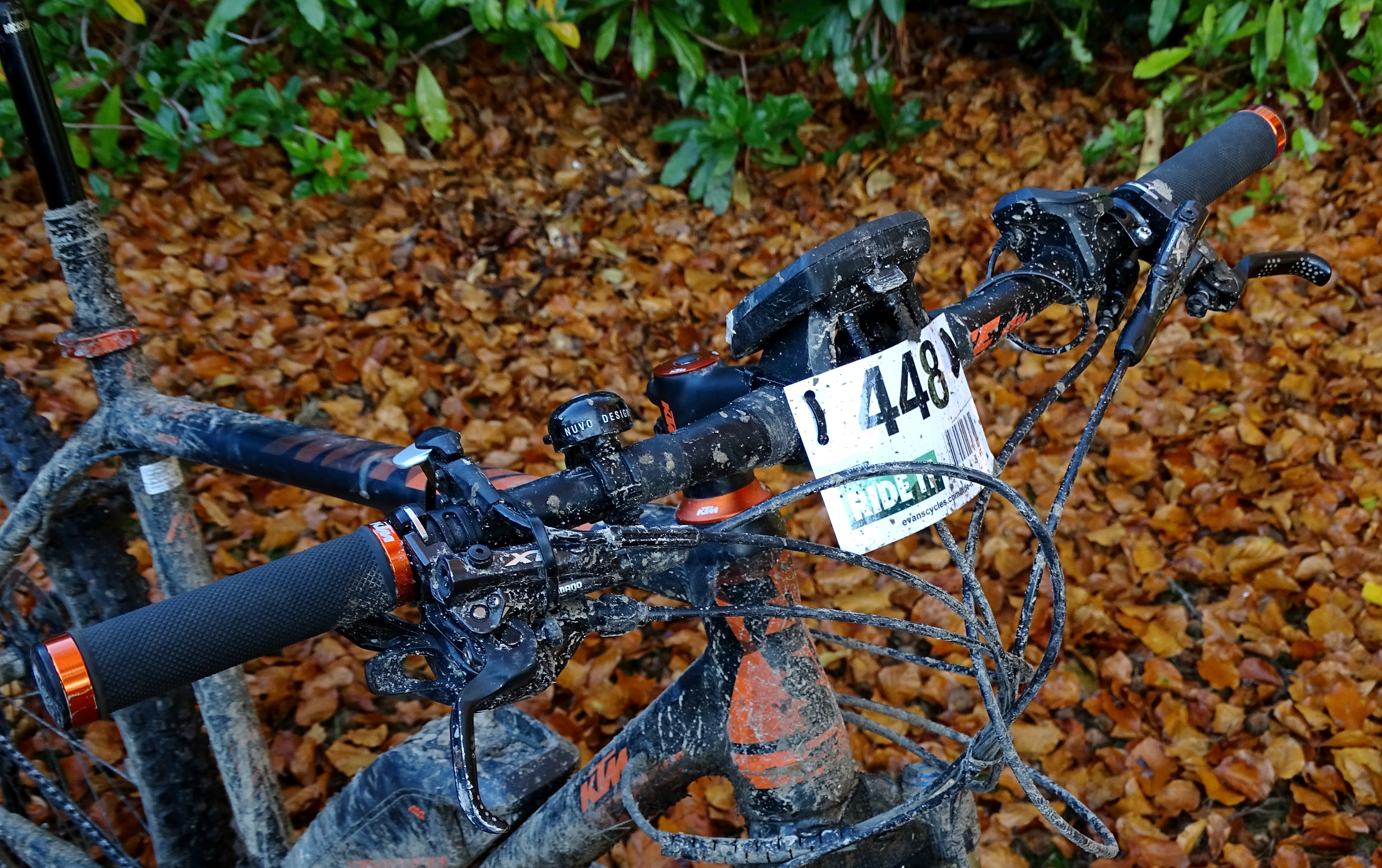

One thing that I wouldn't be without, are cable ties, or as they are commonly known, Haibike ties.
One snapped brake lever mount repaired.

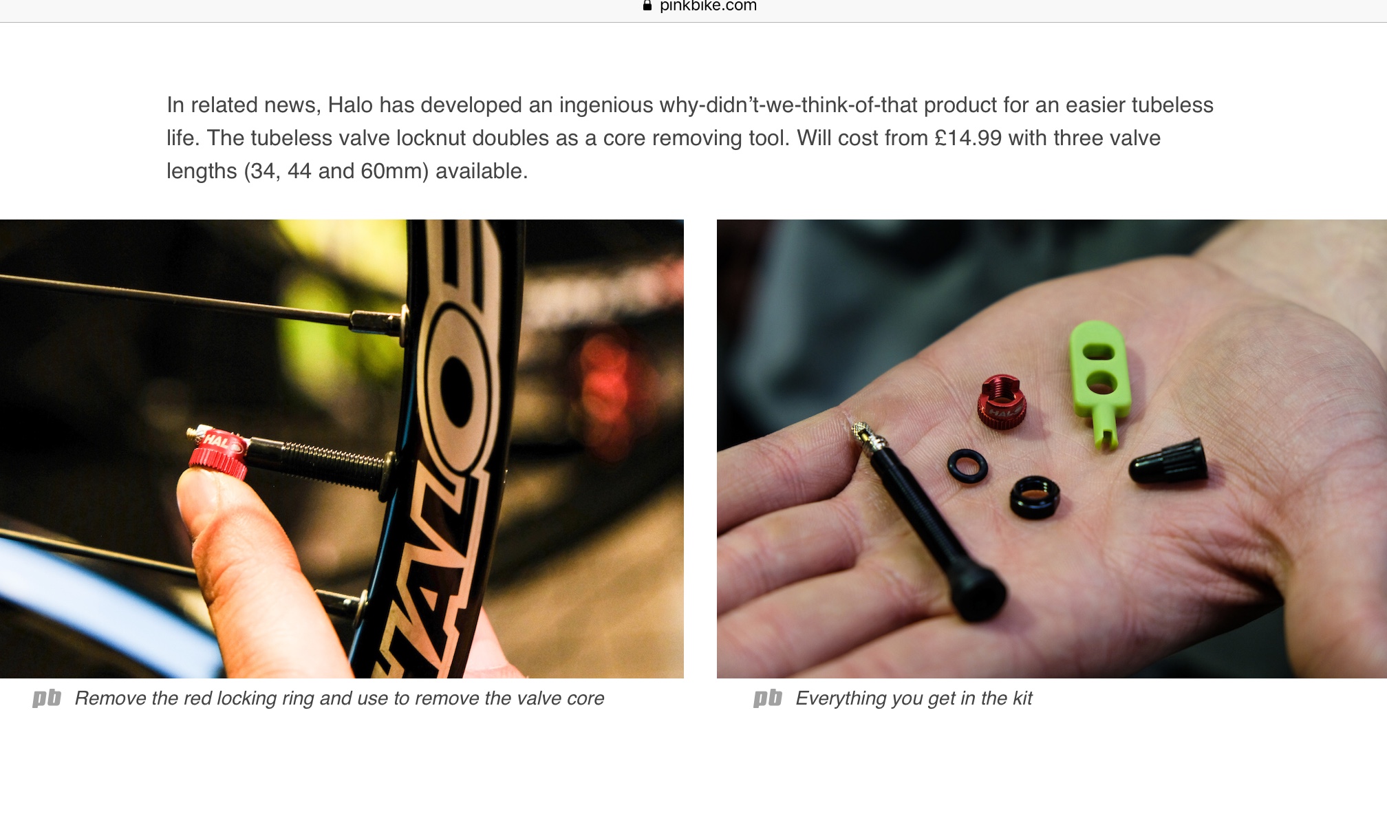

That plugging tool looks like it may have saved me a few times this year , impressed how they have used it in the sidewall . Most recently I have damaged tyres right on the bead , hitting rocks etc , finishing any hope of tubeless use , only a tube would sort that
Not sure about the valve , removing the ring will just unseat the valve when you unscrew the core , a little valve core tool is so tiny to carry , and most decent multi tools will undo a valve core anyway . Never had a need to remove a valve core on the trail

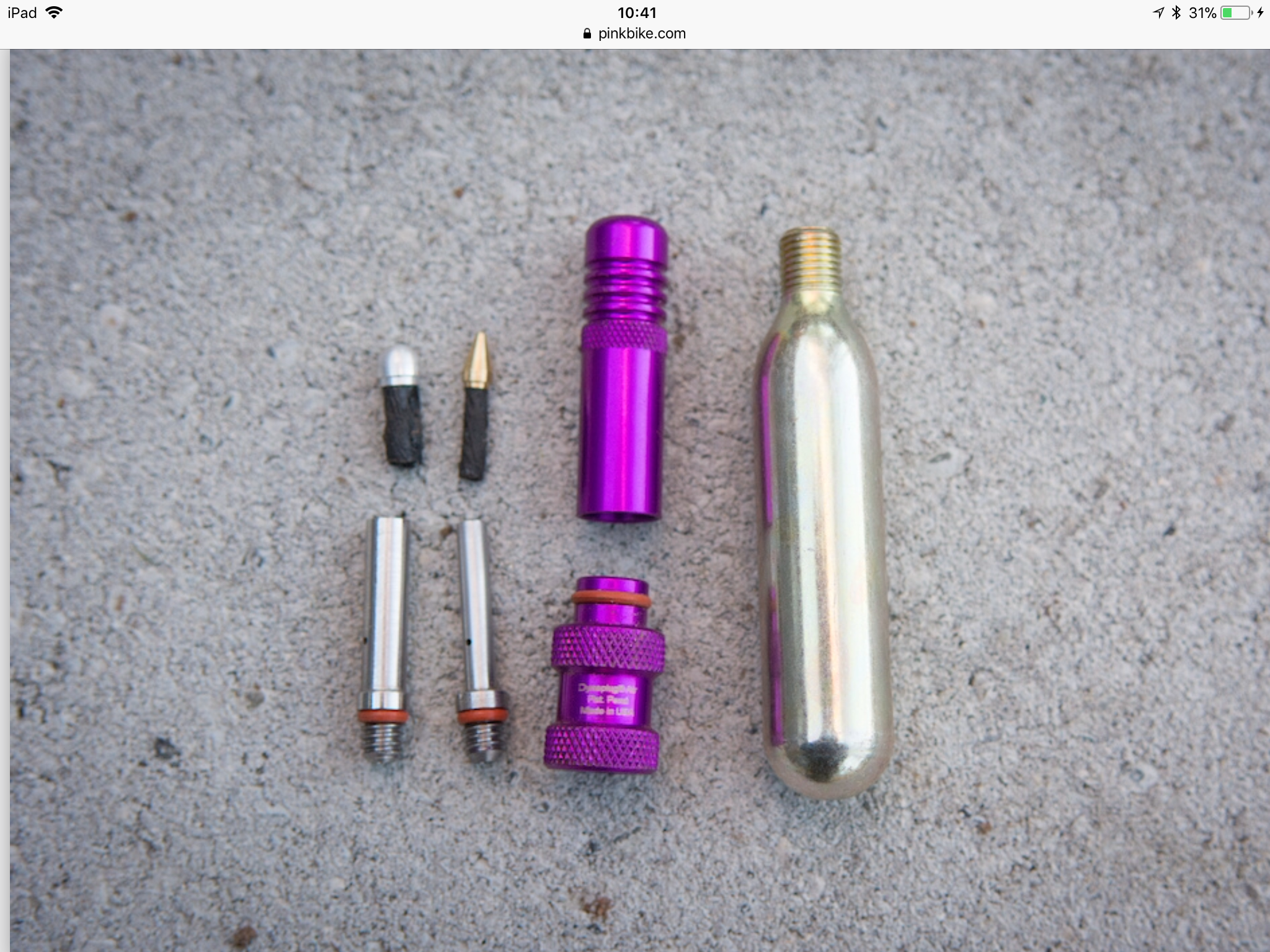

Effetto Caffelatex ZOT! Nano | Chain Reaction Cycles
This is the stuff that interests me , I’ve been using the cafe latex fluid for a while now and it works very well , having had a few badly damaged tyres you can see the fluid and it’s foaming properties trying to work where I’ve seen other fluids fail , this little fast set injector , if it does what it says , may have saved the tyre , and also saved the cost , not to mention the messy job of installing a tube .
I have Also patched the inside of a number of tubeless tyres with varying success depending on the extent if the damage
This looks like a great bit of kit, great find Kernow! I will purchase and try it out.
