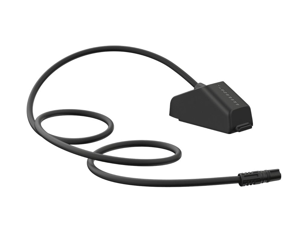

I have a 2024 YT Decoy that I set-up with a SRAM AXS Eagle Transmission Drivetrain and wanted to see if anyone has connected the SRAM Eagle Powertrain Extension Cord to the rear mech to replace the original rechargeable battery?
I have done this on my 2023 Orbea Wild and it worked flawlessly. From with I have been able to research, the end of the cable that attaches to the motor utilizes a HIGO MICRO A-Plug connector. My motor has an extra port available that I can plug into and from what I have read, it was made for connecting a Shimano Di2 RD.
Any input would be much appreciated?
