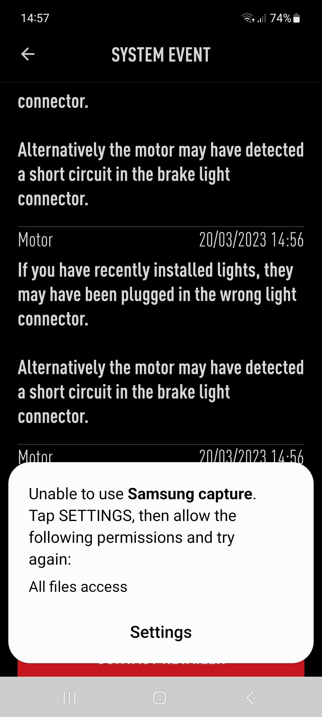

I'm wondering if mine is on way out. Not switching on with button hut switches off. Unplugging and plugging cable in before it goes on. Error im getting is this pic.

Probably. As far as I can see the TCU battery only enables the on/off switch. Thereafter the main battery sends 12v to the TCU for it to power up. Changing the TCU battery is simple and cheap so worth a try.
If you had a cable fault the bike would shut down when riding so I doubt you have any cable problems.

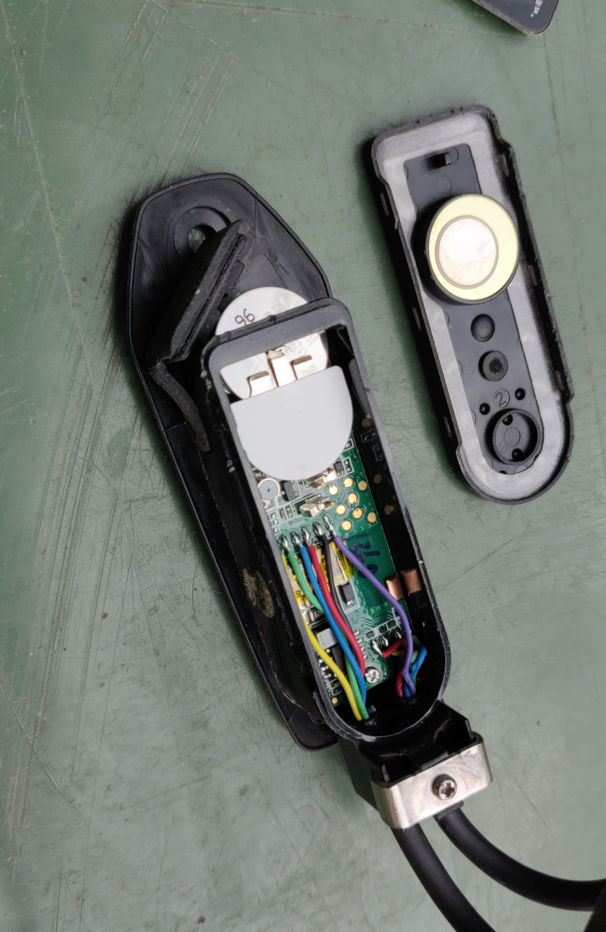

I had no luck with tweezers. I unclipped the lid and pushed the battery out from the back.

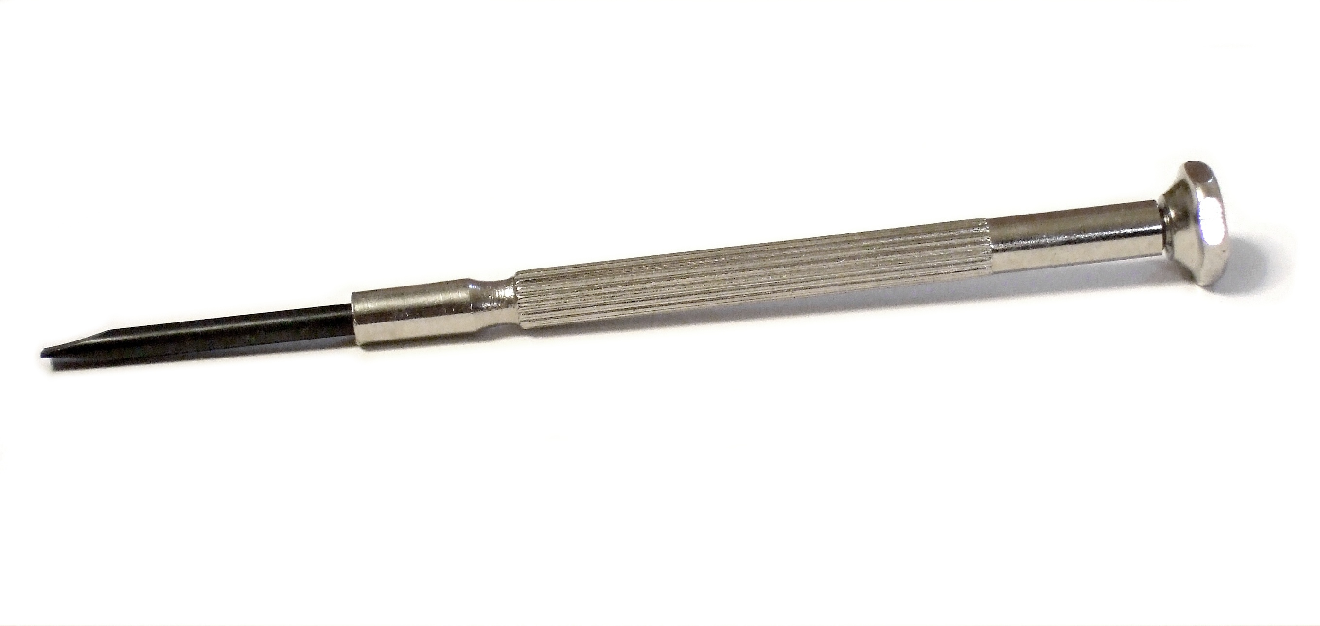

This was not an easy job! I finally got it out by poking a very tiny flat blade jewellers screwdriver (maybe 1.2mm) in where the retaining clip is and using this to gently lever the old battery out (the leverage pushes down on the retaining clip).

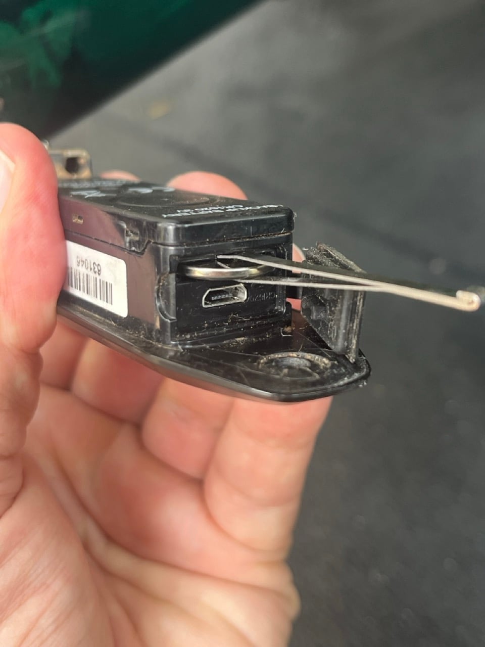

Hi, to remove the TCU battery, if you're comfortable detaching the TCU from the connector cables (there's a green connection and black connection so you can't go wrong reconnecting them). Then try opening and holding the usb cover with your thumb against the side so it doesn't flap. Then press the small metal retaining clip with anything that size (end of a match, electronics screwdriver, paper clip.) Give it a quick shake over the table. Or tap the TCU lightly on the table (usb/ battery side of course). it falls partially out, at least it did with me.
