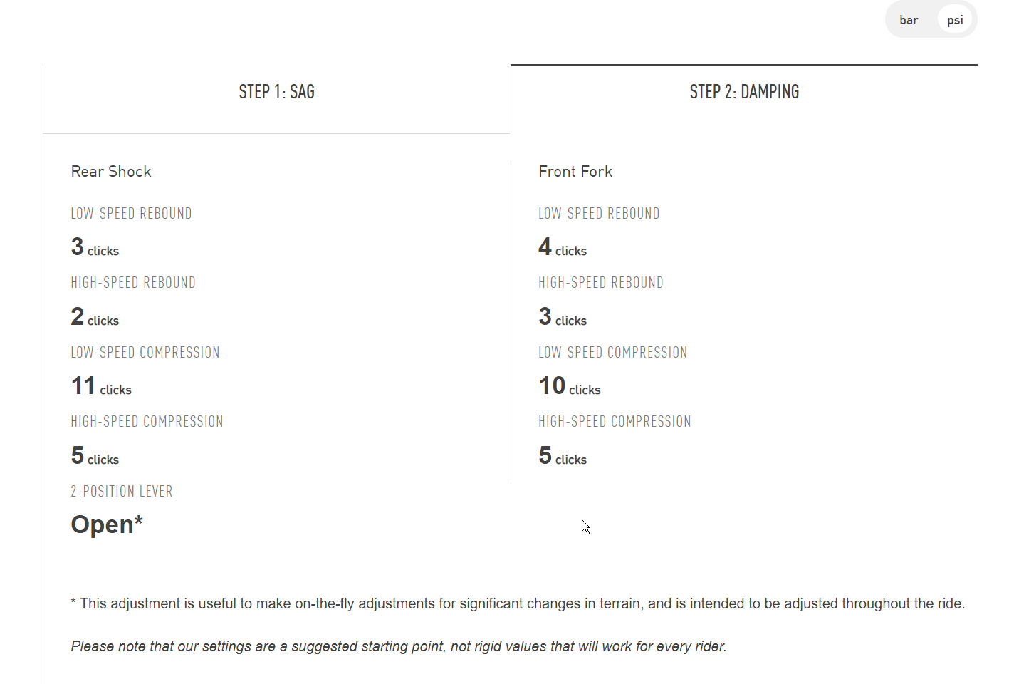

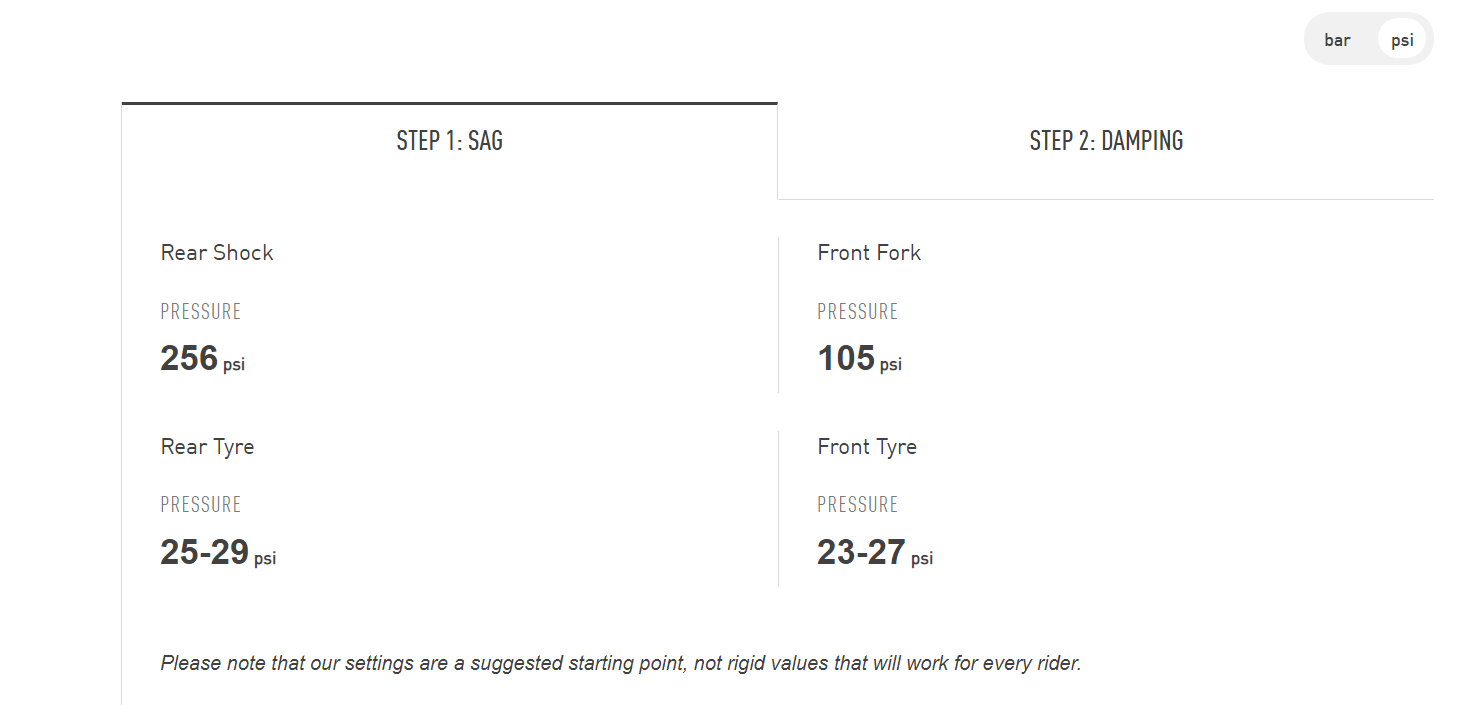

Ive got a Fox 38 performance elite on my Levo and have set the sage and then followed the fox recommendations for rebound and compression.
It feels very harsh and occasionally on a big hit I’ve had my hands jolted off the bars?
Which setting do I need to look at to prevent that happening HSC, LSC or HR, LSR?
The fork feels very different to the 38 I had on my last bike but that was a cheaper model?
Any ideas?
Thanks

Hi,
first of all, remove a couple of tokens and then do the sag of 25% or if you prefer 30%, without considering too much attention to the recommended psi, because, hardly, the pumps we use are accurate.

I have the TL expert carbon 2022 and I found perfect, the adjustment of the fox x2, as suggested by the suspension calculator on the Specialized website, for the fork, on the other hand, I put 10 psi less, but I don't know the accuracy of my fox pump .
I also suggest doing at least a couple of exits to allow for minimal suspension settling, before going crazy with adjustments and psi.

When I first got my S-Works Levo Gen 3. I followed the suspension calculator on the Specialized website. With these settings, the bike felt very odd and very different from anything I have ridden before.
I have since then started messing around with the settings, the HSC, LSC, LSR, and HSR. As with the recommendations from Specialized, it was much more of a climbing bike with constant trail mode on. I never felt a pair of SPDs would help.
Now with backing down HSC and HSR it feels way more planted and downhill like :D. Not sure if my description makes sense for you, but go to your local trail, pick a small portion you can ride easily up without encountering too many downhill freaks :D. And do it back 2 back while changing the settings both on the shock and the forks.
As in my case, both the settings were identical regarding the compression. Now my bike finally feels like the beast it should be.
My settings are, the exact air pressure as Specialized put on the calculator, with 3 clicks of LSC, 5 clicks of HSC(both shock and forks). Not sure about the rebound currently as I have been messing with it constantly.

excuse me, click from all closed or all open?
To be honest, no clue mate. I just followed the instruction on the website. I would say, from everything with 0, so no LCS and no HSC. I think this would be open, or at least that would make sense in my brain :) See my settings below, I have 92KG
I would say that I am now on the rear shock with :
LSC - 5
HSC - 3
LSR - 4
HSR - 3
Fork
LSC -4
HSC - 2
LSR - 5
HSR - 4

Having similar issues with my fox 38, given it an air side service, grease was OK.
Just wondered, can you guys confirm that volume spacers are making a decent size difference to sag/pressure? I find with no spacers I am around the fox recommended around 110psi ish. But with the stock 3 spacers I achieve the same 20% sag with 85psi, anything above is crazy hard, obviously my shock pump may not be accurate but the difference is clear. On other forks I've not noticed this as much before.
As expected, without spacers it will go through the travel easier too.
