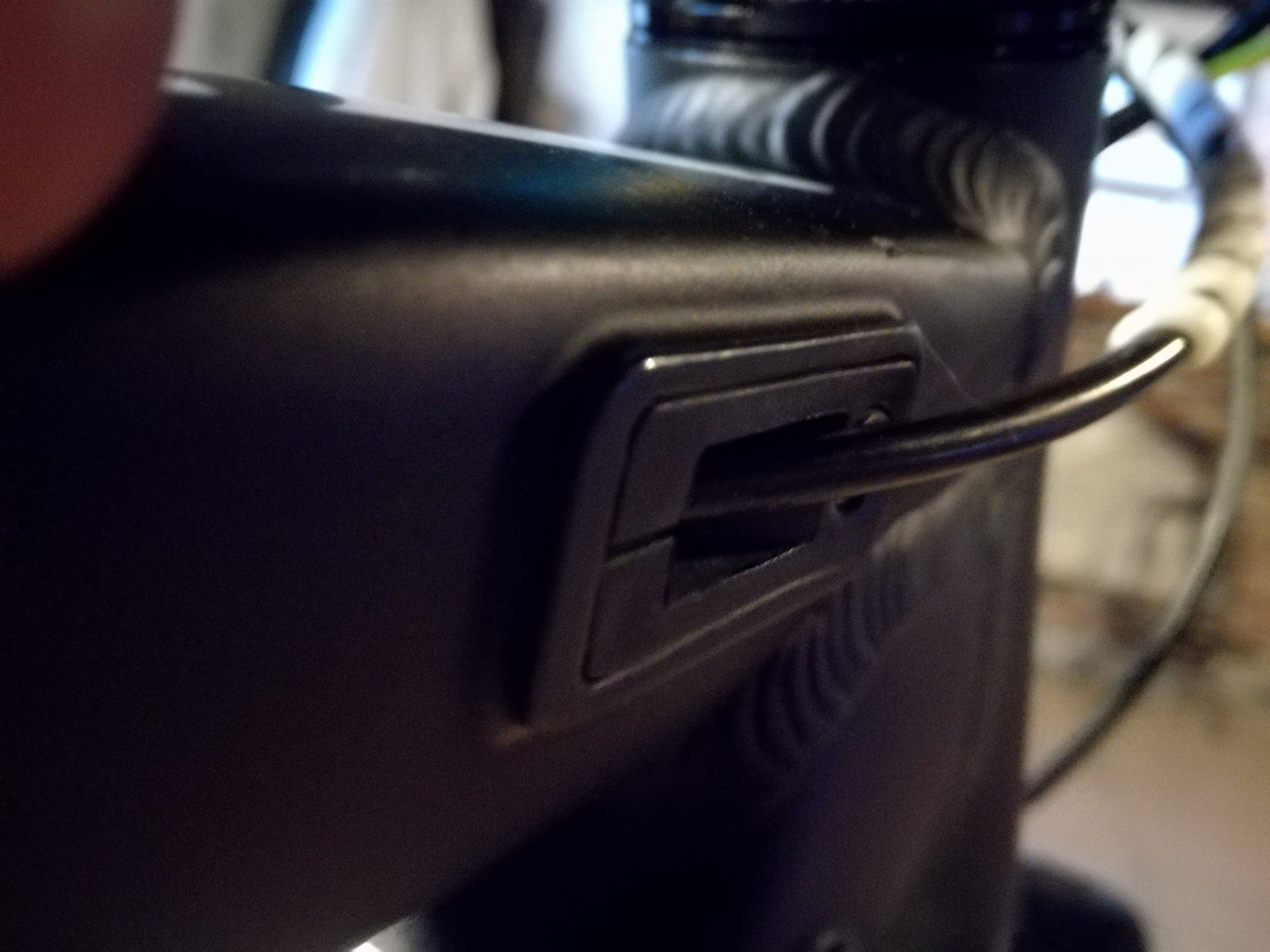

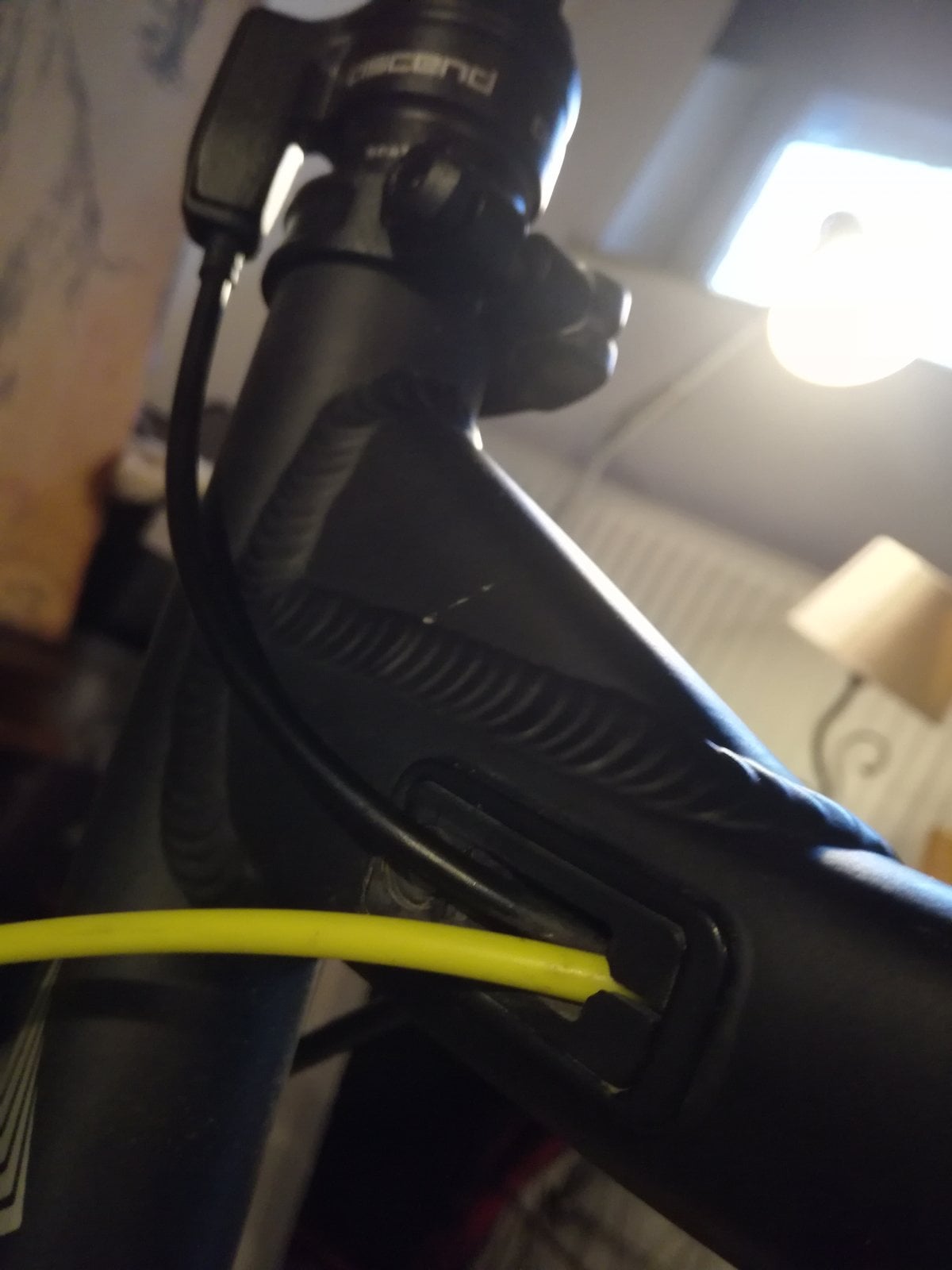

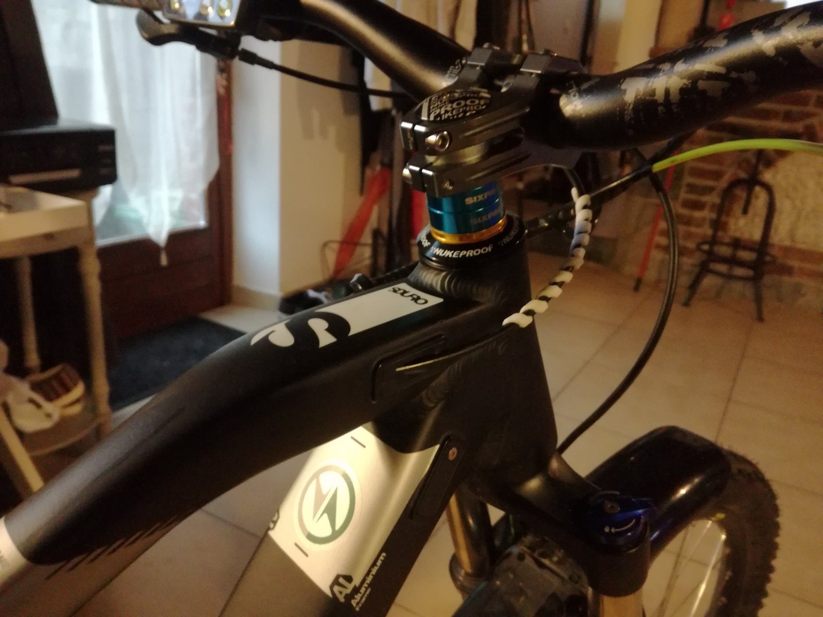

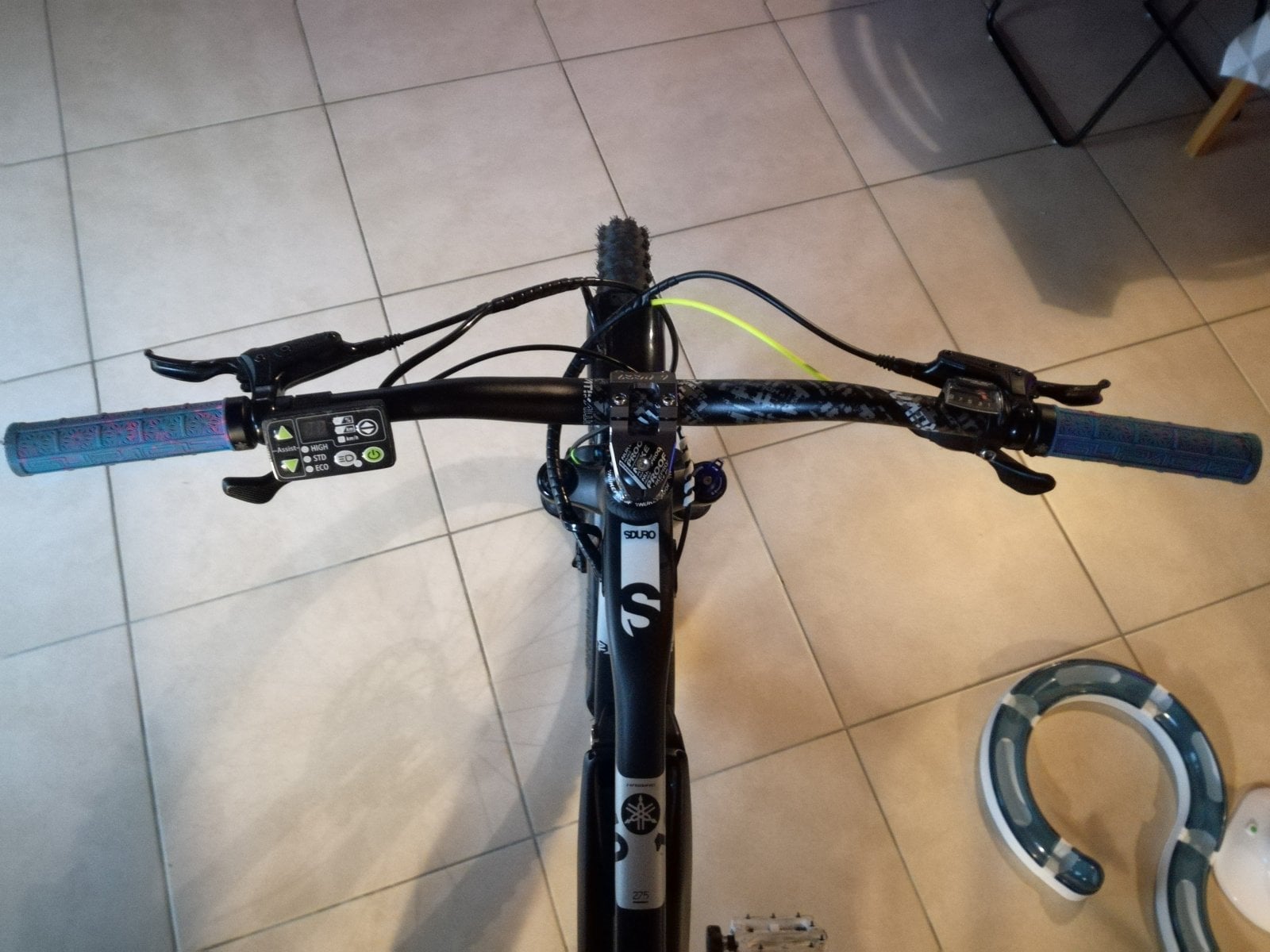

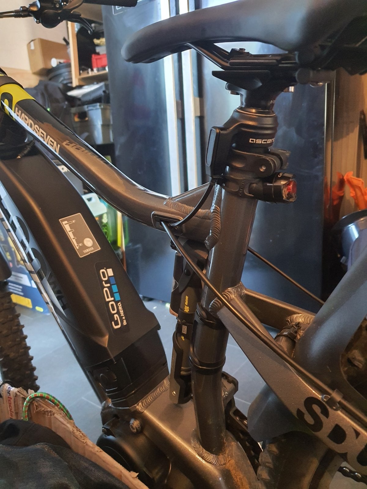

I went for the external one and routed it in the top tube (I had to buy a new 2xholes cable grommet). I wasn't a fan of needing to drop the motor if something went wrong with the dropper/cable (it's pretty easy to do but I don't like to deal with the cables nest when closing everything).
Here's how I routed the external one:
1.5 years with it, crashed hard and still working, no servicing except one cable replacement.

Brand-x ascend dropper seat post :) You'll find many happy users if you search about it on these forums. Around 150€

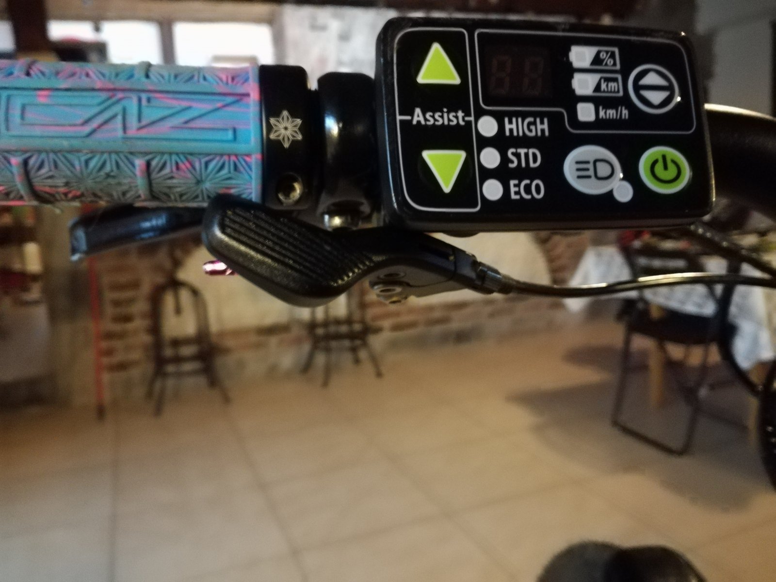

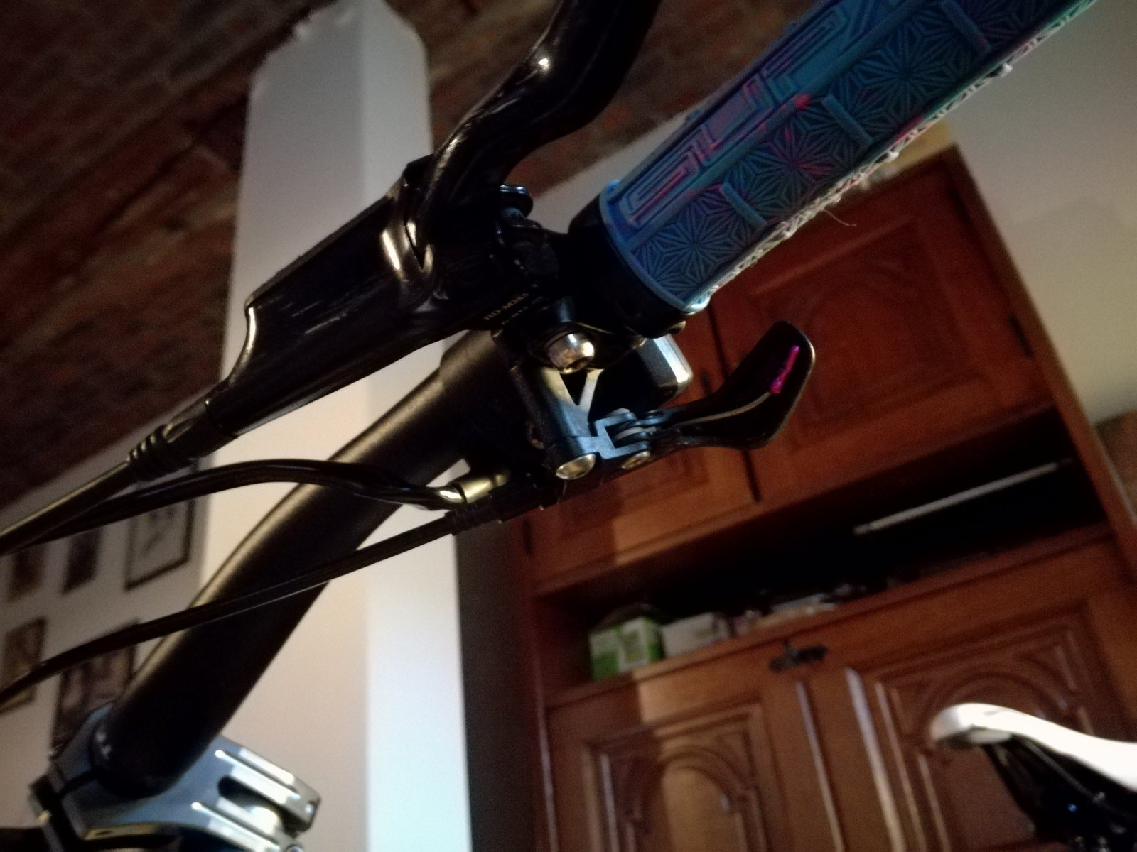

Could you post a picture of how you've routed the cable at the front and how you've positioned the dropper lever please :)

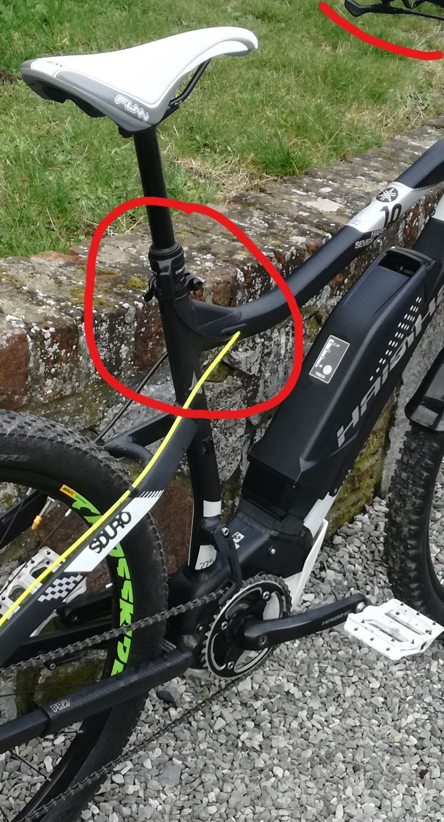

Could you tell us what size dropper you have used looking at the shape of the seat post it seems be short with a bend towards the bottom (size small frame)

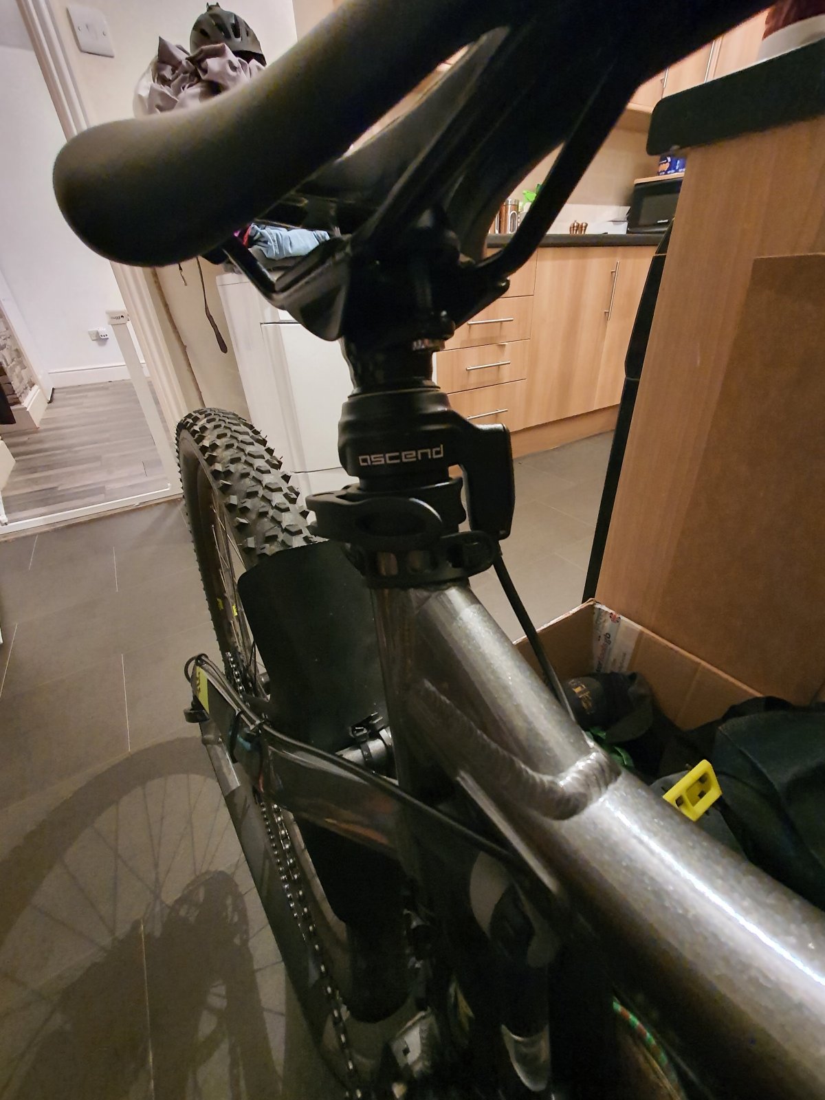

Got a hardseven 1.0 too. Just bought a Brand-X and had a quick look at it. The dropper actuator on mine seems to sit at 180 degrees to yours (so Front LHS as opposed to Rear RHS). So I am guessing one of us is back to front but you seem to have got the seat fairly flat so I'm doing what you did!

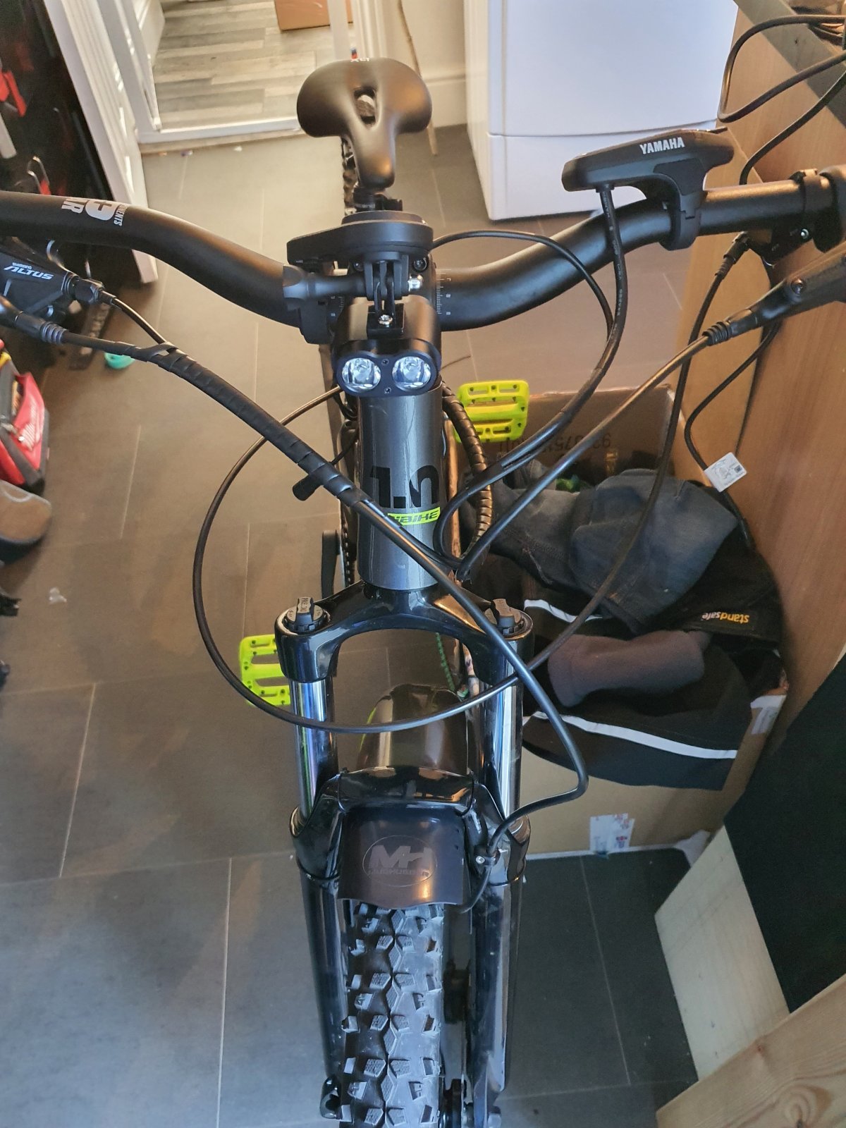

Finally fitted mine last night, wow!
I have the cable at the front coming in the right hand blank( the one with no cable) and its exiting left hand rear with the brake cable (had to drill another hole at an angle to get it out).
The cable goes into the actuator on mine on the left front of the seat post.
The dropper is the brand x ascend II externally routed

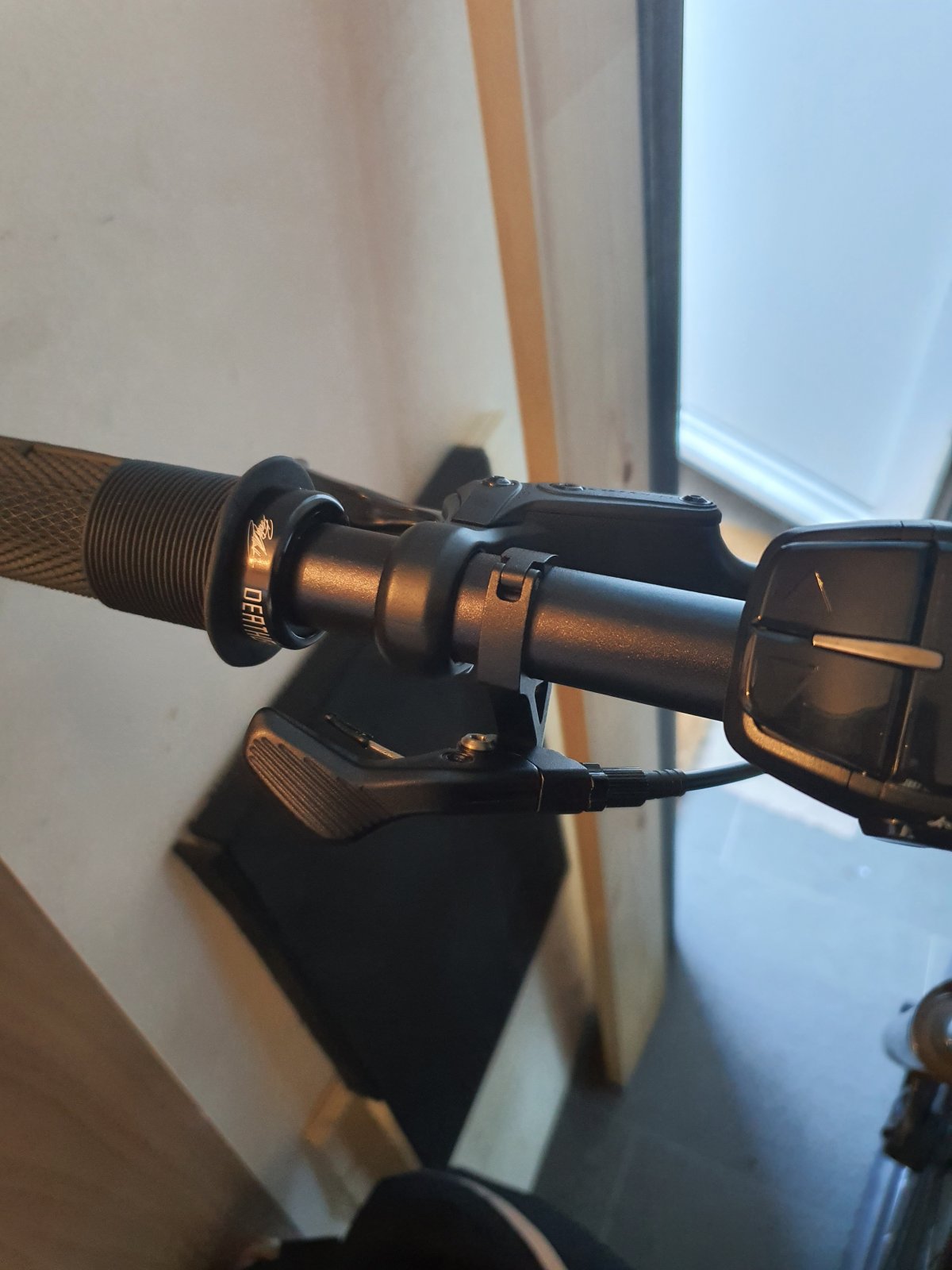

Any chance you can post a few pictures mate
I think you have the dropper in the facing the way it was designed to face.
However I found the cable actually routes better to the actuator on exit if you have rotated at 180 degrees and it's on the RHS as opposed to the LHS. The cable inlet on the RHS can actually accommodate 2x4mm holes too, so no need to drill holes. If you do it this way you can just about get the seat to be flat as you're working against the angle of the post ( see pic from Kaelidoz with flat seat).
So both ways work and I'd be very happy to have your set up too.
The problem with my method is that it's fucking with the seatclamp. Right now I'm using a non QR Chromag seatclamp that I had to move slightly to the left, just to be able to close it.
It was even worse with the original QR seat clamp as I had to move it 180° around which isn't a nice experience for the frame.
All in all I think my method is shit and that I'll have to reroute everything soon.
Anyway last week my Brand-x Ascend started making scratching noises out of nowhere (almost 2 years of usage) so I had to service it. It was actually super easy.

Quick update, it turns out that my brand-x ascend II was facing the opposite way from the factory assembly. I just flipped it around while servicing it. Really weird.
That's why my actuator was on the rear left while my saddle/seatpost were all good. The actuator is now sitting front left.
So you can disassemble the Brand-X ascend II pretty easily and move the external actuator where it's needed on your bike.

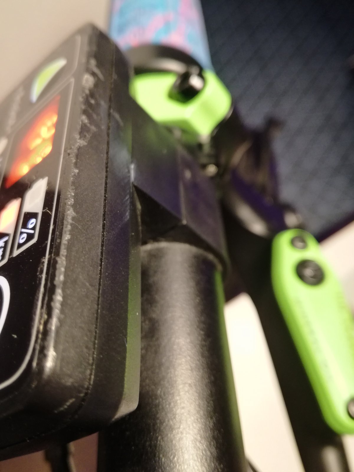

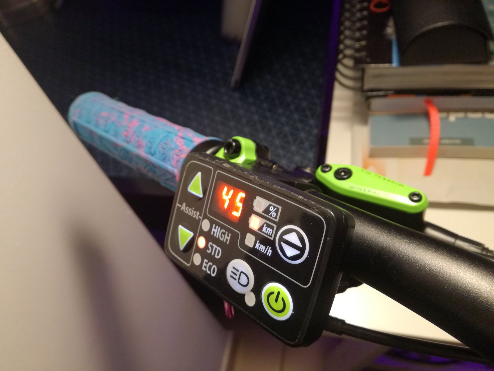

Haha so true @maynard. I'm more a fan of TNG with Picard, DS9 and Voyager myself :p
It's the og command panel for the Yamaha PW. I initially meant to replace it but it's ergonomically sound and really, really robust.

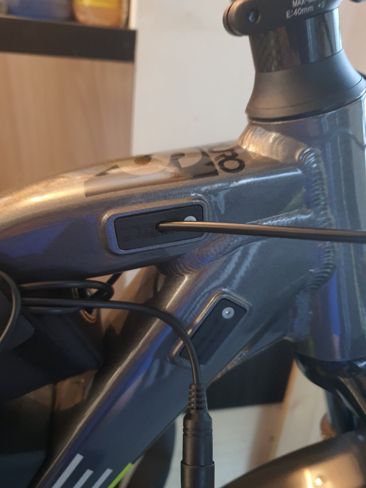

I put an internally operated one on my hard seven, pretty straightforward job really. I think the hardest part was modifying the cable entry grommet thing for two cables and leaving it looking proper. First time I've had one and wouldn't be without it now.

can I ask where you got the 2 hole grommet?
