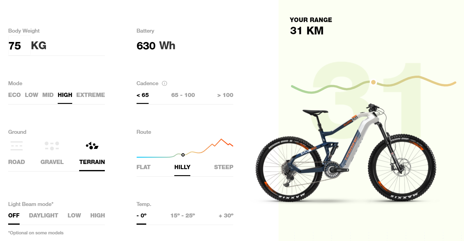

Well I used the range calculator and it kills it for me, since I want longer range.

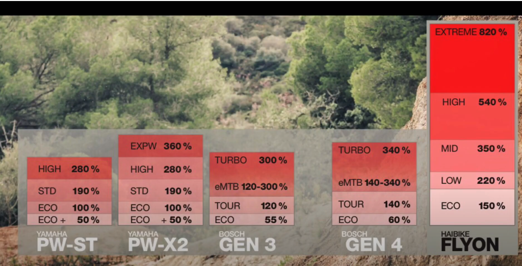

Hmmm that's not much range, the Flyon motor I guess, so much torque, it's going to suck the battery. What about one of the Bosch-powered Haibikes, like the
XDURO AllMtn 3.5
give you better range, especially if you get a range extender as well

Based upon my experience of the Flyon, that is probably a fair assessment of likely range. It does take you up the steepest of hills though :)
Actually, I just noticed the power setting on the graph is in “high”. If that is throughout the trip then I think 31 km is on the very upper range limit.

And yes. Flyon support modes are all heavily shifted compared to other motors. For hilly terrain I doubt you'll really need the upper 2 modes at all.
