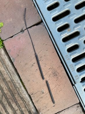

I actually trimmed off about 10cm from my dropper cable to bring it in closer to the bar as well because normally they are not cut in the factory and stick out quite far. Was 5 minute job and looks much better now.

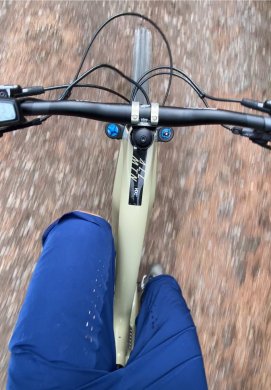

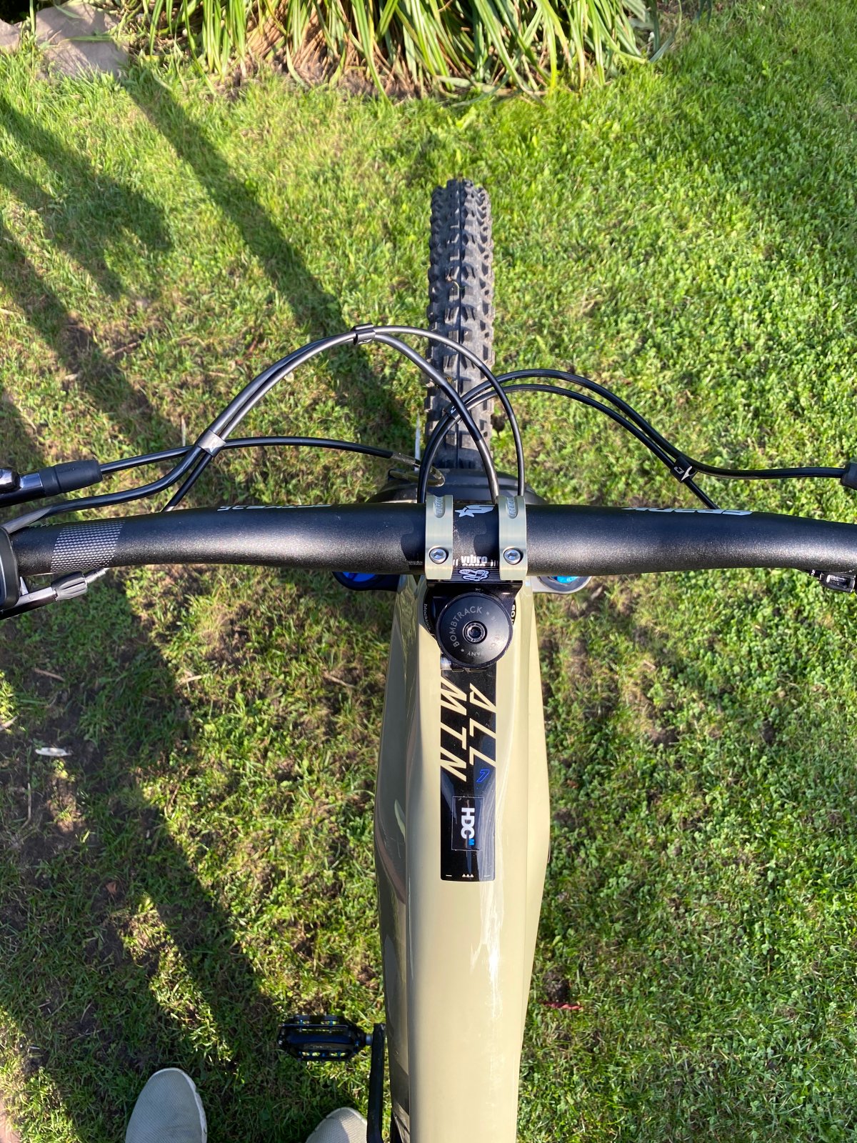

Can see before and after here.
