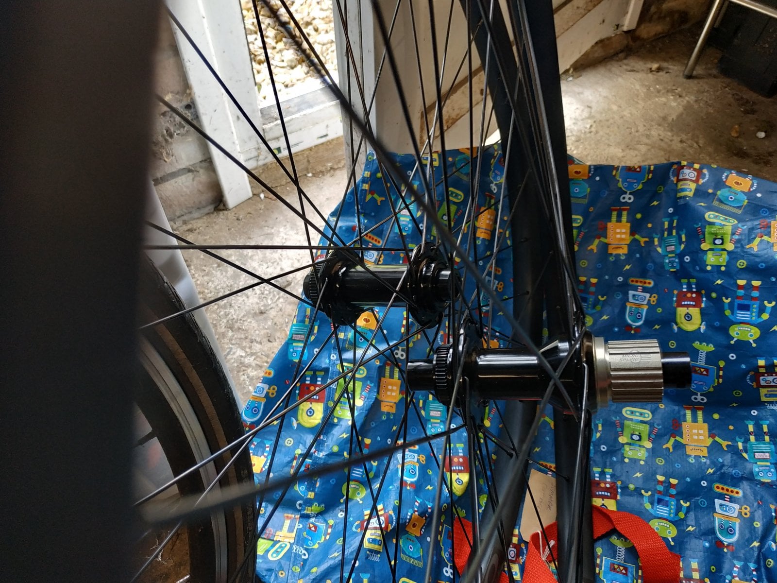

After a huge run around I finally got my H15 and began my upgrades. This included a nice set of custom wheels weighing a very respectable 1745 grams for £400. This was to save a ton of weight over the "very heavy" stock wheels. I say very heavy as Two separate people independently confirmed to me that their h30s arrived with wheelsets that weighed 2280 and 2275 grams which is huge.
The h30 of course has the same wheelset as H15.
Hence I was rather annoyed to weigh the wheels coming off the H15 to find them at 1987g! Almost 300g lighter than as weighed by others without rotors and cassette of course.
I don't know if they changed the spokes or somehow those two people weighed wrong. I'm a bit gutted as I pretty much wasted £400! Hope I can recoup by selling the race face stock wheels!
Edit: It turns out the reason these were so light is that Shimano switched out the bombroof and heavyweight mt400 hubs for some crappy chinese ones made of cheese, which is why there are so light.

Thank you. Proof positive they are not the same wheel set. I'm wondering if mine came with slx hubs and butted spokes. We're talking 330g lighter and your weight matches up well with two other examples. I will take a closer look at my hubs to see if they are different. They are black and unbranded.

My hubs are totally different. No shimano branding, black centerlock, and a titanium colored freehub instead of black. What the heck are they?!

They are from a UK company called dcr. They are nice bitex hubs, sapim d light spokes and a 30mm welded oem rim they call the "big boy" rim. They have excellent reviews and the wheels look excellent quality.
Thanks.
Hadn't heard of dcr or bitex. a quick google and the Bitex hubs look very similar to novatec (not a bad thing). and Sapim spokes are great quality. Personally I'd have gone for a 2.0/1.8/2.0 rather than (but that's me) and from what you're saying it sounds like their rims will be from a reputable source too (Alex etc.)
I wouldn't worry about your supplied wheels not being the same spec as originally listed. Shimano hubs aren't actually very good. plenty manufacturers are having to put out their bikes with slight alterations in spec due to unforseen shortages and time constraints. Generally the alternative parts arriving on higher end bikes are of equal quality and in some cases better. sounds like you scored an upgrade

Thanks. I wasn't worried about the wheels differing from spec. But I'm interested to know what the hubs actuly are. They definitely aren't shimano from the shape.
