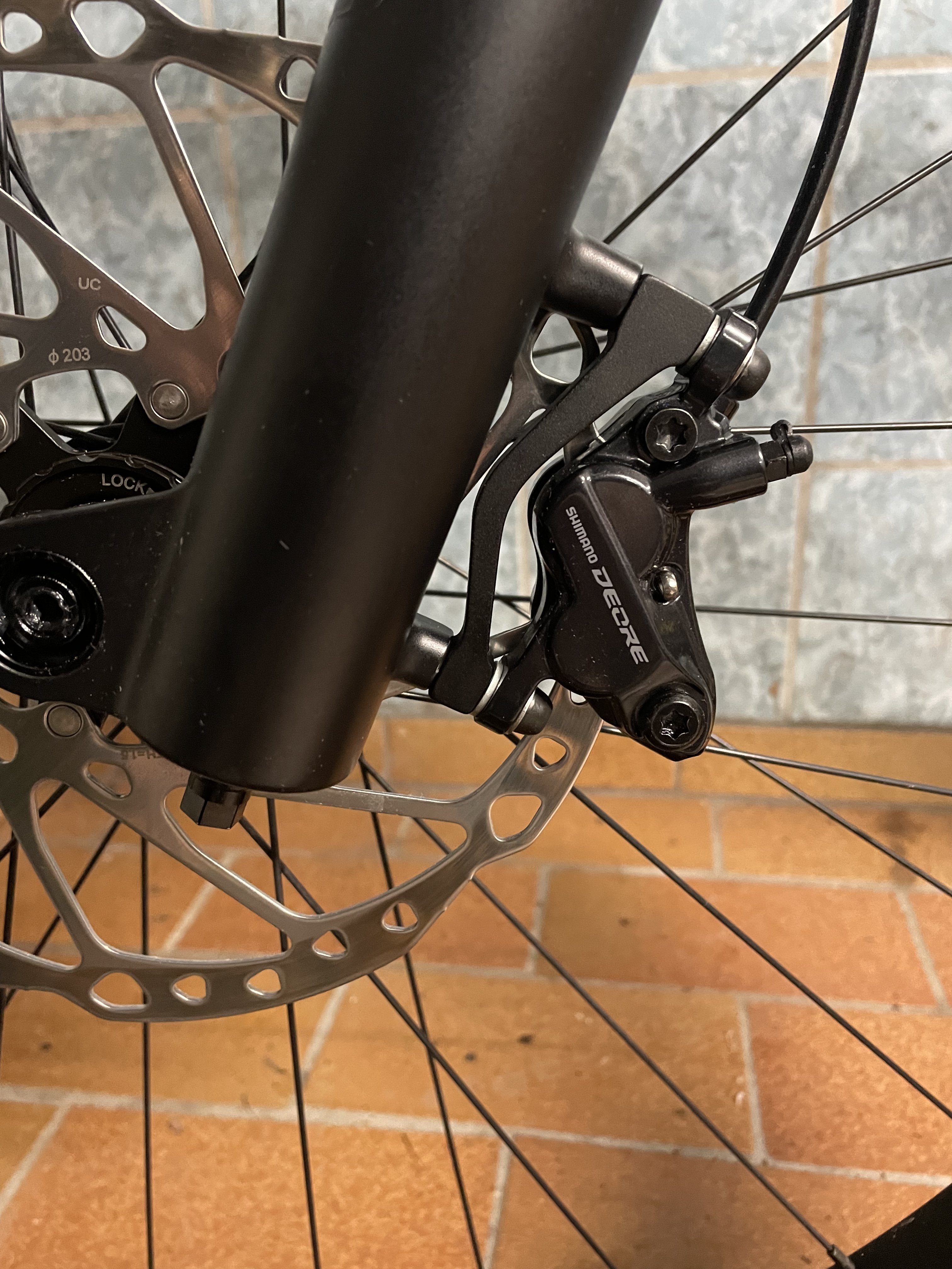

Decolocsta
Aug 10, 2022
71
215
203 + 4 Pot Caliper at the Front is worth it.
Went First with the Disc Upgrade,
but the stopping Power wasnt there and the modulation was crap.
Pure on off feeling.
I bought the deore caliper and switched it over (5 min job).
Now i have stopping Power and a nice modulation.
All in all an Cheap Upgrade.

Interesting idea. So you’re running 203 rotor and 4 piston brake up front and 180, 2 piston on the back?
