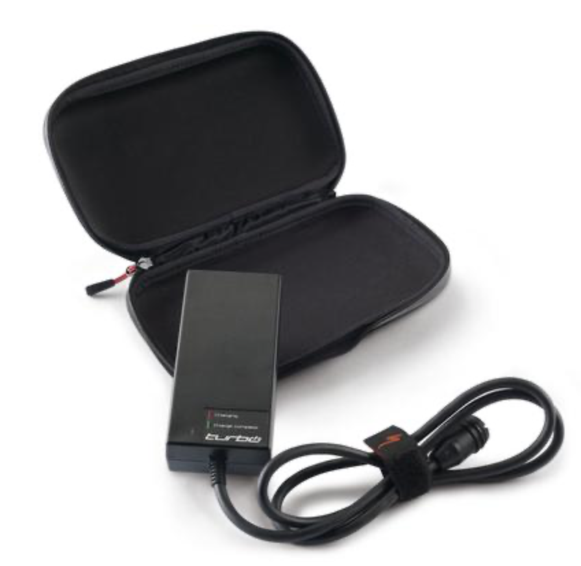

Absolutely also it's isn't necessary to always charge to 100% if you don't need the full range or if you do charge to 100% do so before you ride not after. Not sure when balancing starts with this BMS but probably at 100%. Ideally left or stored at 40% up to 50% SOC.[WRONG] the Manual says 30% to 39% :geek:
Another option to increase cell longevity at the expense of double charge time is to use the 2A Travel Charger but that doesn't seem to be available any more.
